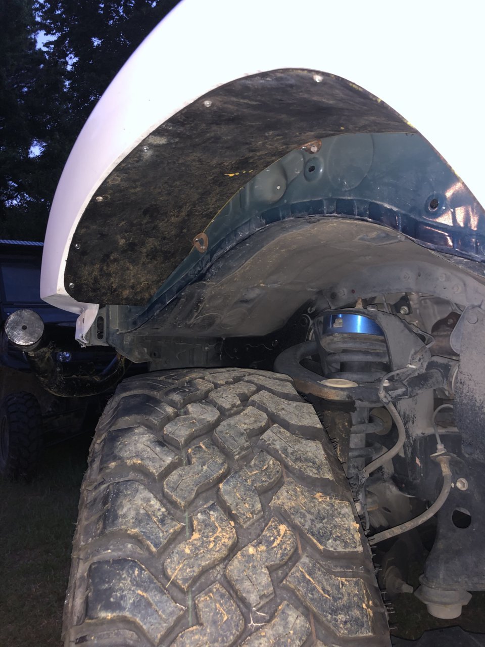

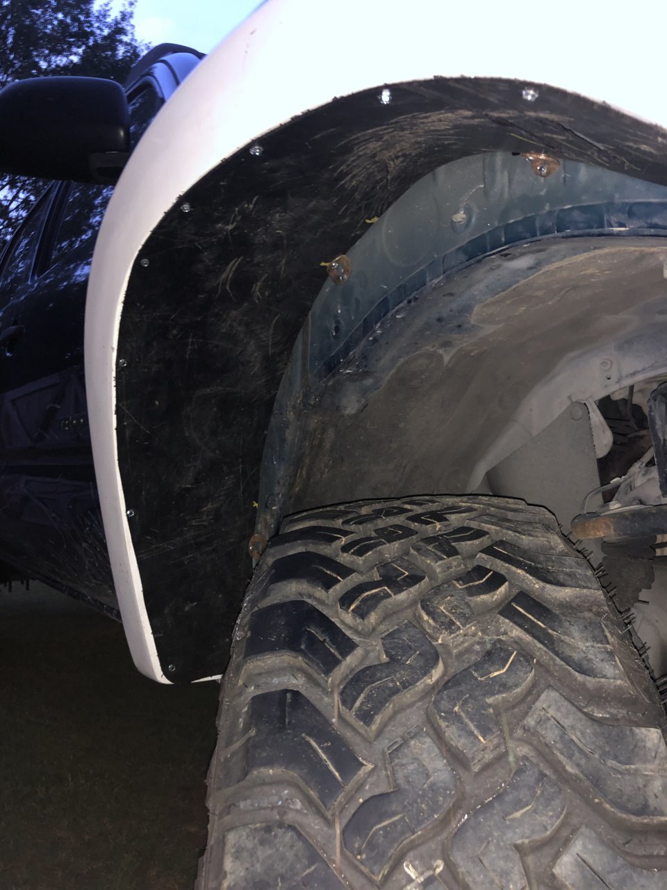

    Update on the fenders. I made a lining out of some scrap thick plastic my girlfriends dad had laying around. We used self tapping screws to tie them to the fender and then bolted bent washers to the lining and then self tappers to tie them into the frame. Also did a cab mount chop and installed some spacers

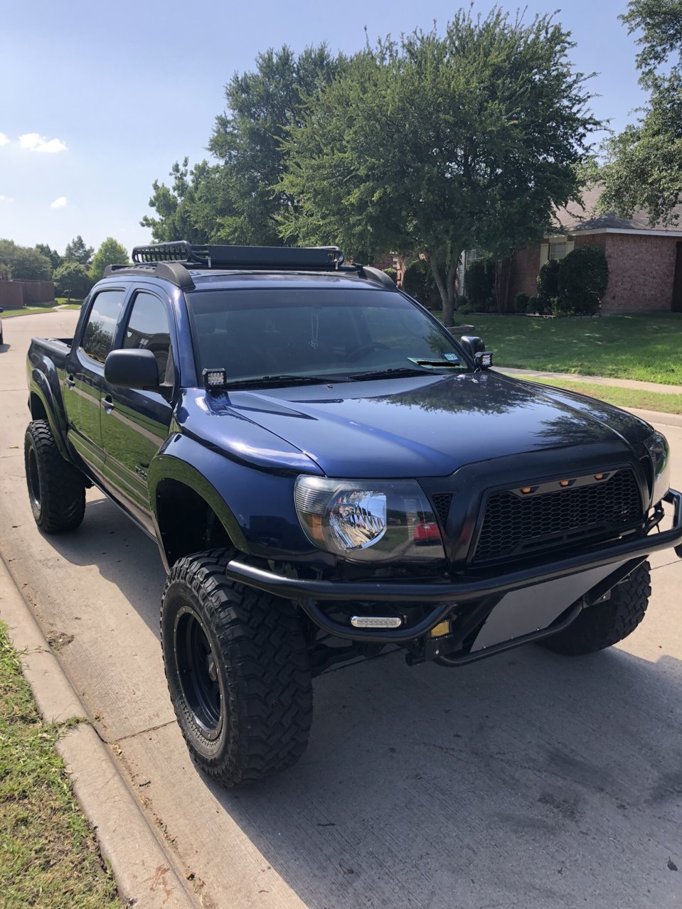

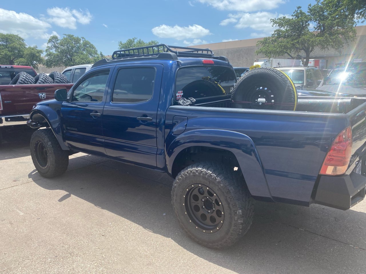

    It’s all done now. I got my hood repainted because of the chipping and fading of the paint and the fenders painted in the front. I also got my stock flares color matched in the rear. Everything turned out awesome.

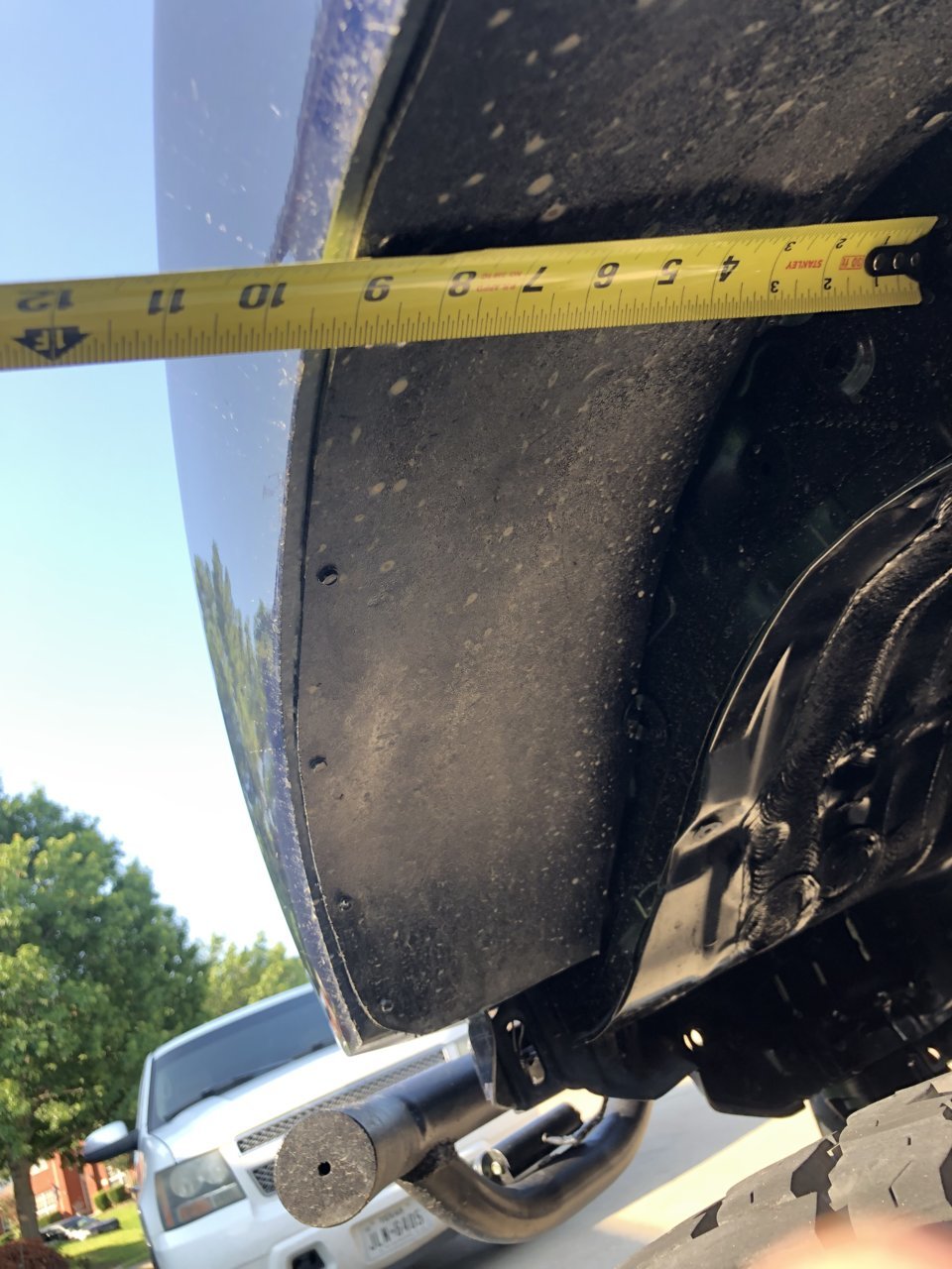

    I can measure for you but i think the 2’s will look better unless you plan or getting your tires out wider. I think the 4’ may swallow them which is why I put on the spacers

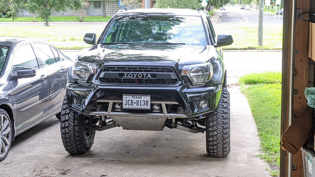

    My 2" McNeal's measure at 9" they have been trimmed about 1.5" all around for extra clearance so they might be a bit narrower. Here is a Pic of my truck it has a 2" TC kit and on 35's still plenty of poke . I think with 4" fenders your tires will be playing hide and seek....

    Bad ass ride.. I like that bumper..
    thanks for the measurements..what wheels do you have?

    I’ll take one in the morning for ya and measure the width

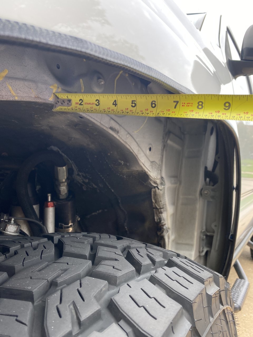

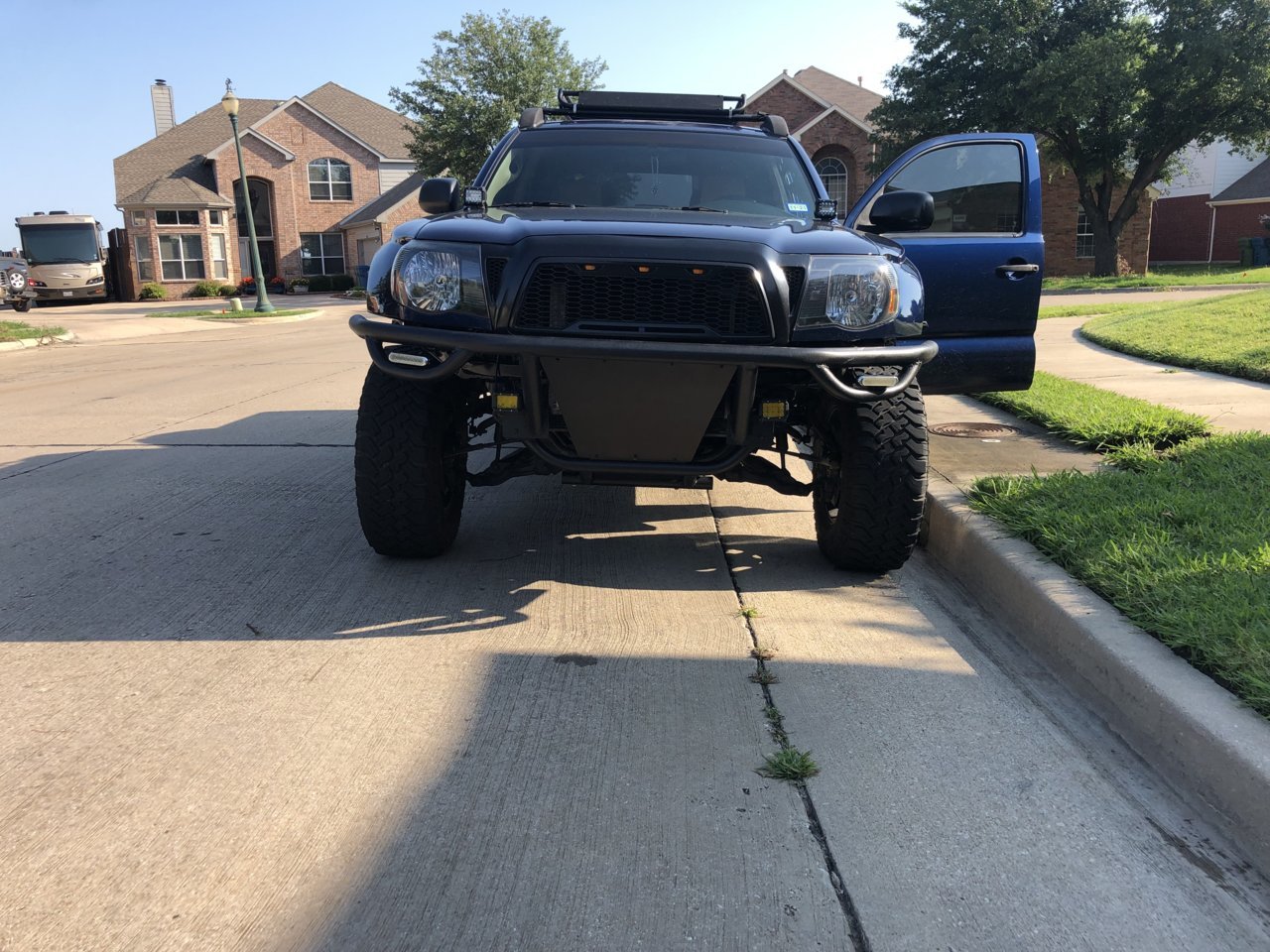

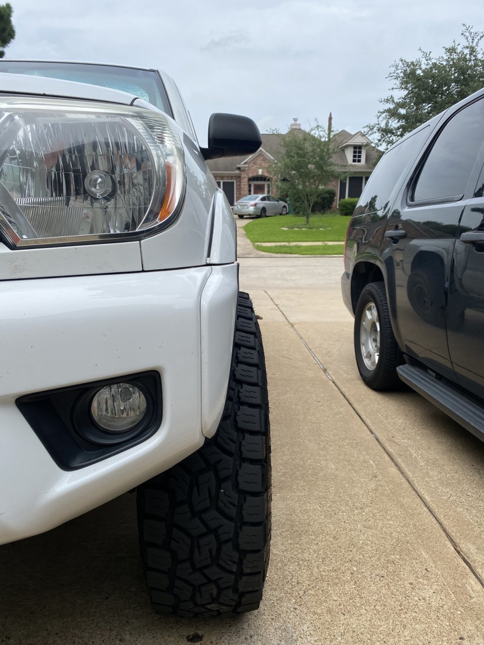

    They sit out a little over 9” on the 4” flares. D174CA31-BCD2-4E5F-94FE-0348E7ADFBA8.jpg
    Here’s some pics on the front end with the 1.5” spacers. I’m running 285/70/17’s

    Thanks man.. I see they taper down.. I think the +2 is gonna what I’m gonna order.
