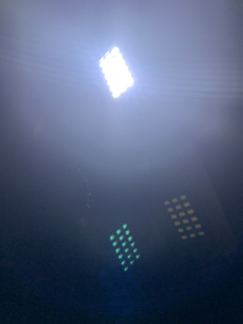

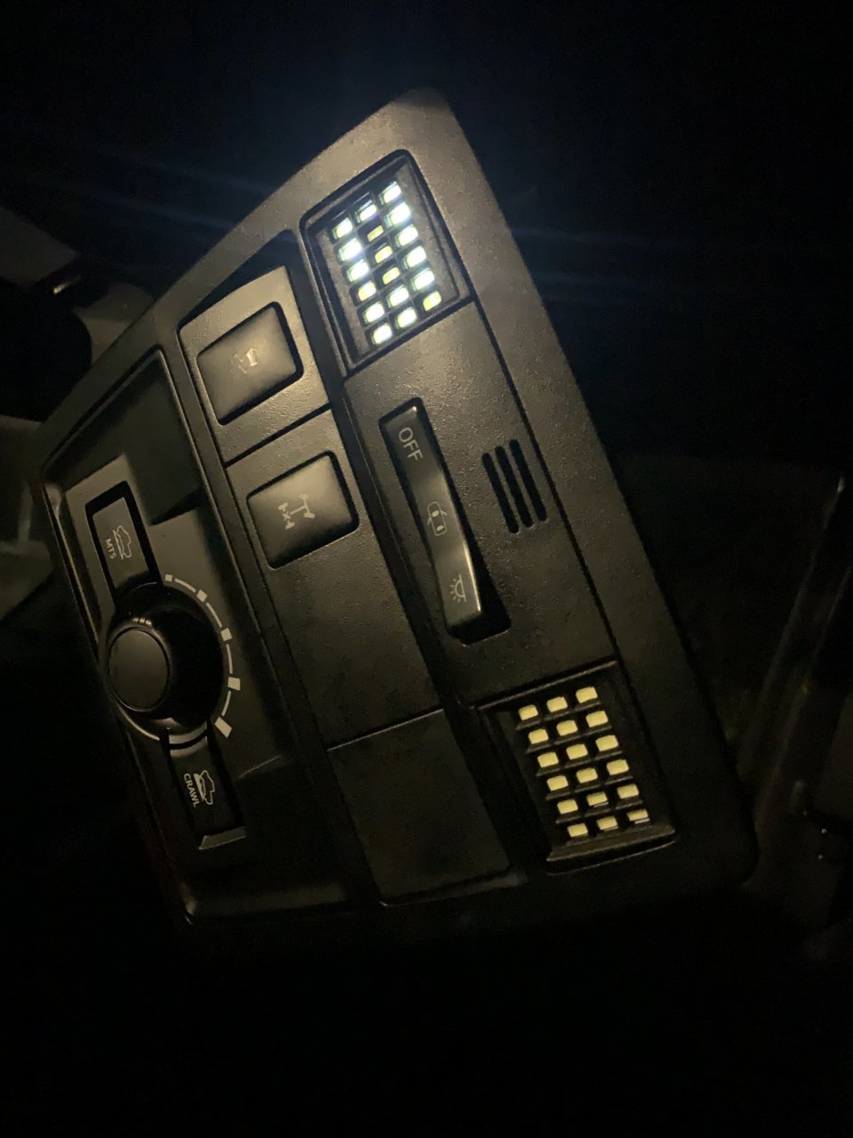

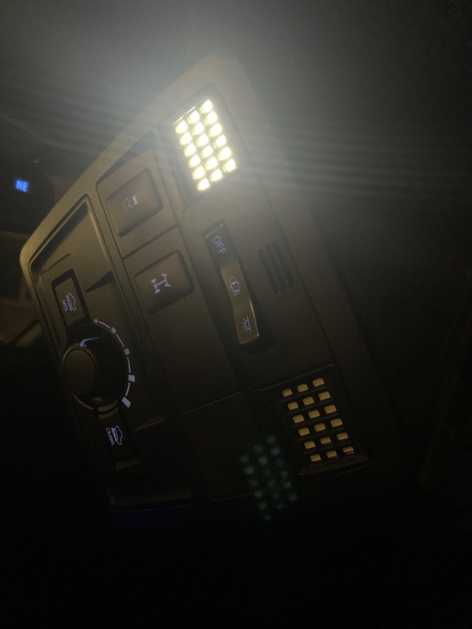

    Here’s my issue. When the truck is off they are super dim. I didn’t notice this when I installed during the day. This is a pic with the truck off. Main switch off. If I press the light to turn it on it’s full brightness.
    Putting the truck into accessory mode or starting the light gets brighter. Again using the switches only makes it brighter.
    If I press the switch they work fine and I go blind.
    Has anyone seen this issue before? Any ideas? Switching the bulb adapter polarity just makes them not work.

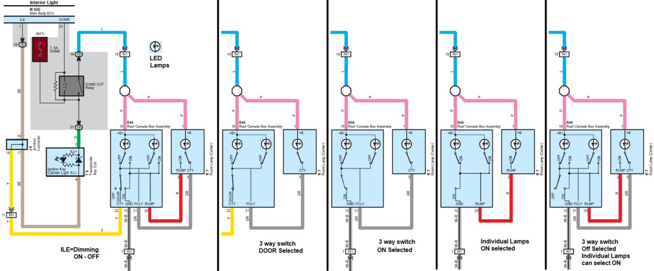

    This diagram helped.
    First off I hate modern vehicles and electronics. I have a dash cam that I wired up a long time ago. Guess what…besides always on and switched power I was using a ground in that main harness. Cut the ground, lights work fine. :annoyed:

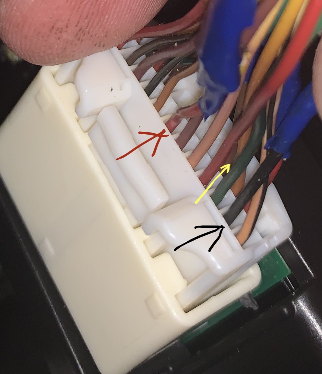

    The dashcam has three wires. One for continuous power, acc power, and ground. I can’t find a find a wiring diagram for the dashcam so I am going to guess yellow is acc, red continuous, black ground. Here is how I have them wired.
    Red -> some pinkish looking wire
    Yellow -> sorta brown
    Black -> solid black. At first glance I don’t have a black/white wire.
    Tomorrow I’m just going to run the dashcam ground into one of the metal roof brackets up there.
    Excuse the dirty thumb. Here’s how I had it wired.

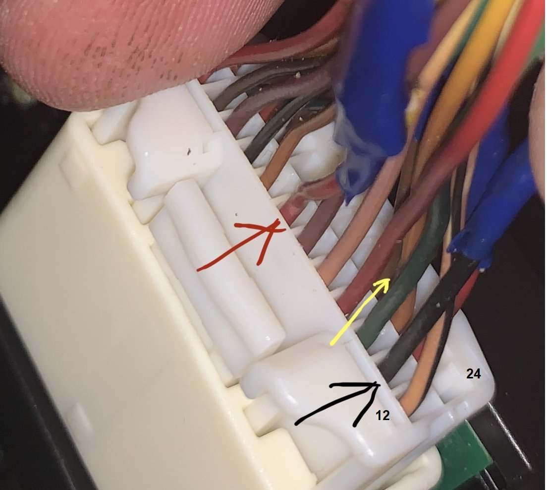

    You are so lucky to not have damaged the circuits you are now using.
    The ground wire on R44 is the end wire next to the black wire you thought was ground. It's in fact part of the overhead microphone amplifier. (MCO-)
    The red arrow is pointing to the power to the differential lock switch. It should be slot #15 for always hot source. (overhead illumination source)
    The yellow arrow is pointing to the another wire to the overhead microphone amplifier (MACC)
