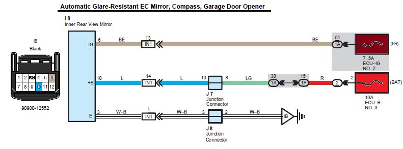

    Power and Ground yes. Acc not an alone circuit there...
    I'm surprised you don't have mirror with auto dim and garage remote buttons. Or do you?

    I have one of those mirrors as well. I haven’t checked that circuit, but I’m assuming there is acc in there?

    Dude, you have all the needed sources there...:facepalm:

    I installed the camera nearly six years ago on a brand new 2016. Wiring diagrams weren’t easily available back then. At least I couldn’t find them.
    I’ll switch over to that circuit instead. :cheers:
