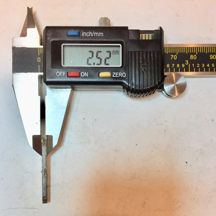

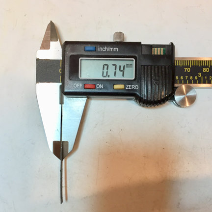

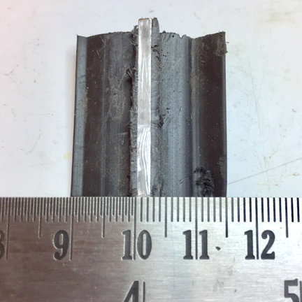

    No one asked, but in case anyone wondered, the metal strip in the weather strip is less than 1 mm thick and 2.5 mm wide, which may be why some people report they punch though it with leather punch.
