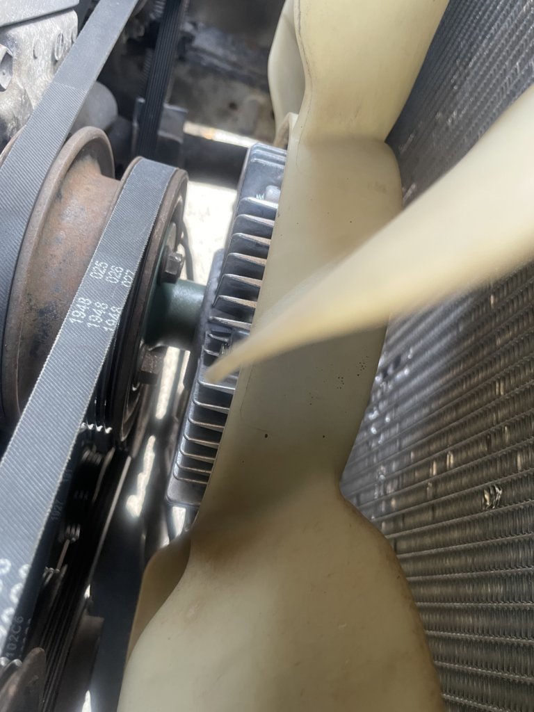

    Does anybody know where I can get another one? Length and size: thank you. Can’t really see it from the picture but only three bolts were on…

    Take one of the three out and you'll have your answer.

    If you drop the skid plate it's likely wedged between the front and rear pieces, but I would hold them accountable.

    When you say it lost its screw and bolt, you must mean the nut and stud?
    I'm almost sure it's M8x1.25, the "medium" size for the engine bay. If not, M10x1.25.

    You’re a life saver brother! And yes the nut and stud are long gone. I’ll be looking for what you suggested at my local hardware store

    when i did my T belt cover gaskets
    ALL my fan clutch bolts were rounded off basically non useable
    took 45 mins to get them off
    i went to Ace Hardware spent $2.84 and they work/fit perfectly
