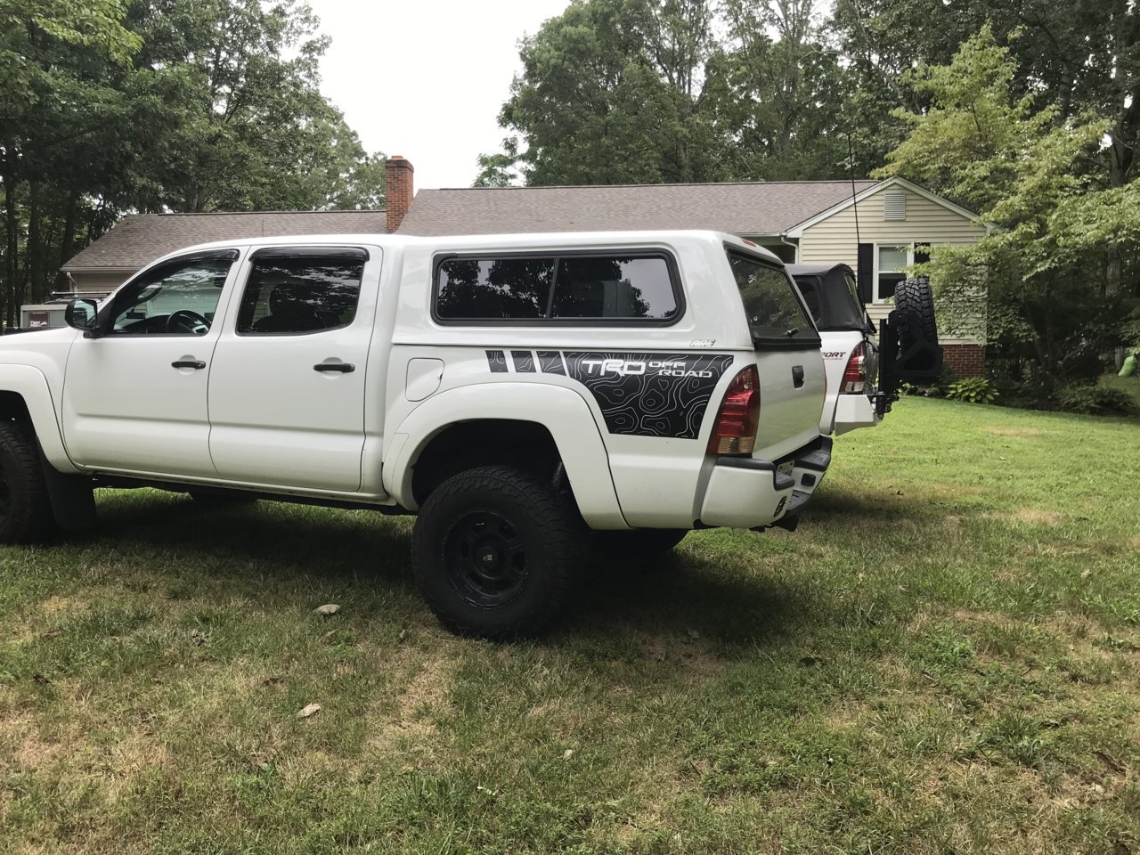

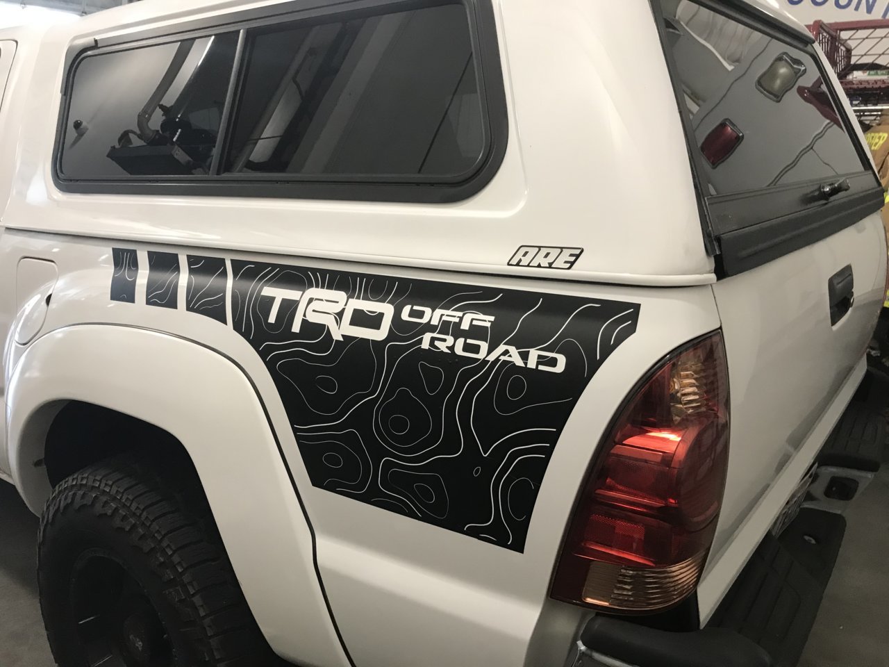

    Custom Bed Decals
    B9C48DFC-77FD-49DF-B3CA-BF0405FC1416.jpg 1C103F42-B6B5-4463-86E9-D434BF11986F.jpg 8AEFFE81-009D-4674-AAD7-7A49677E8B5E.jpg

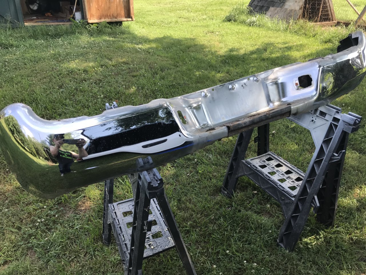

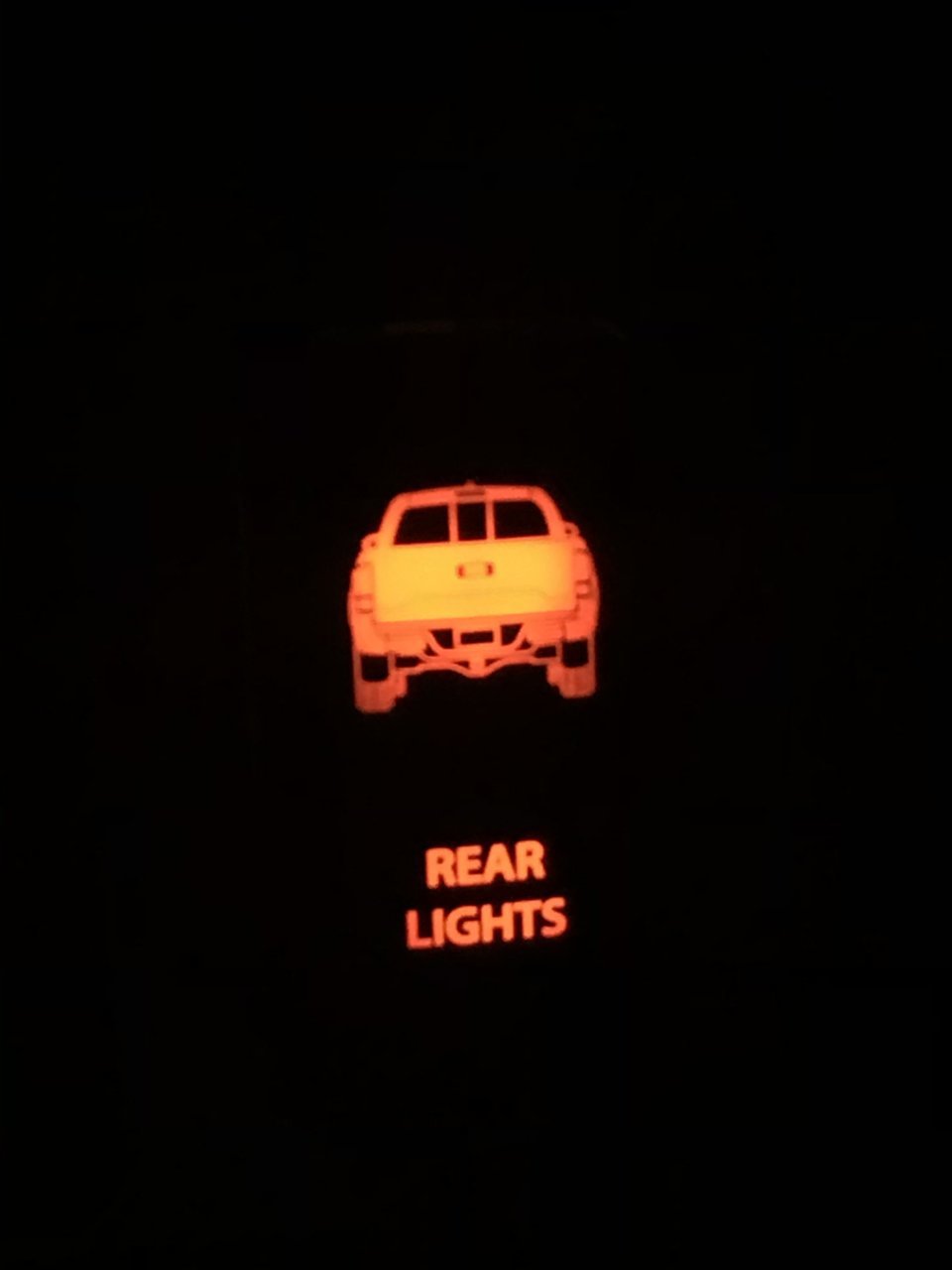

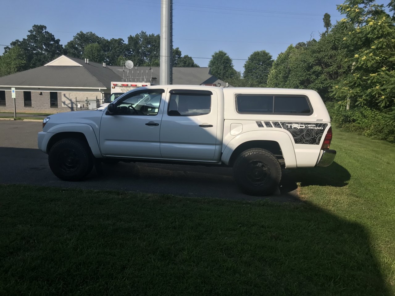

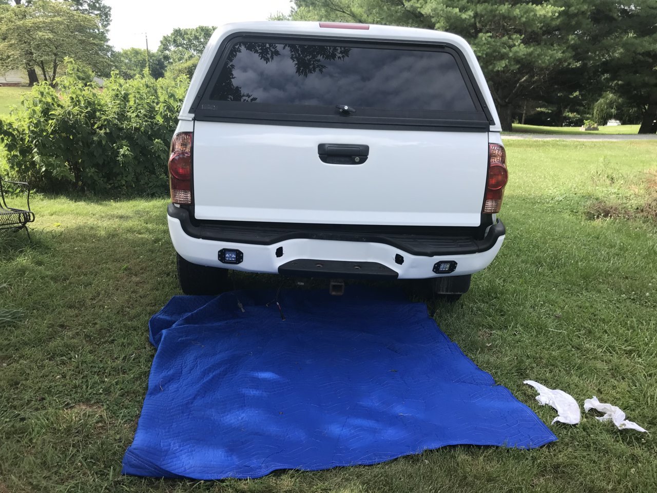

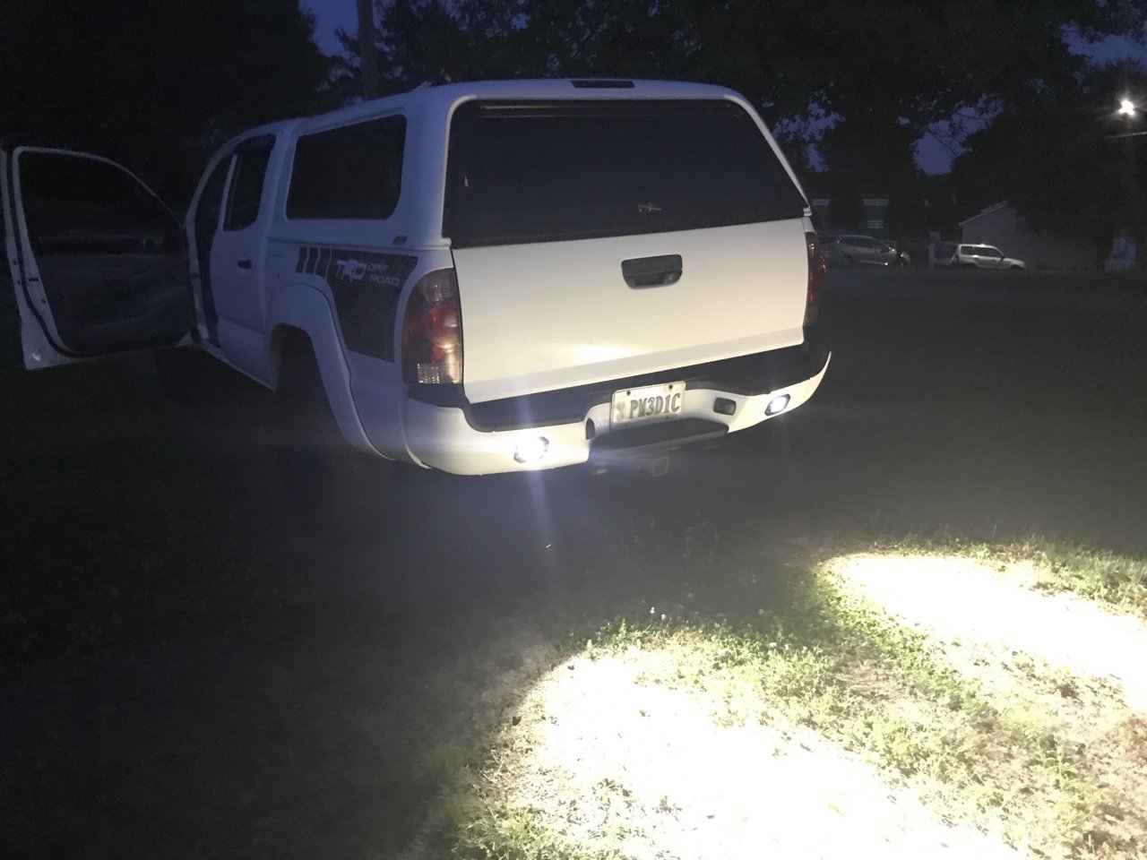

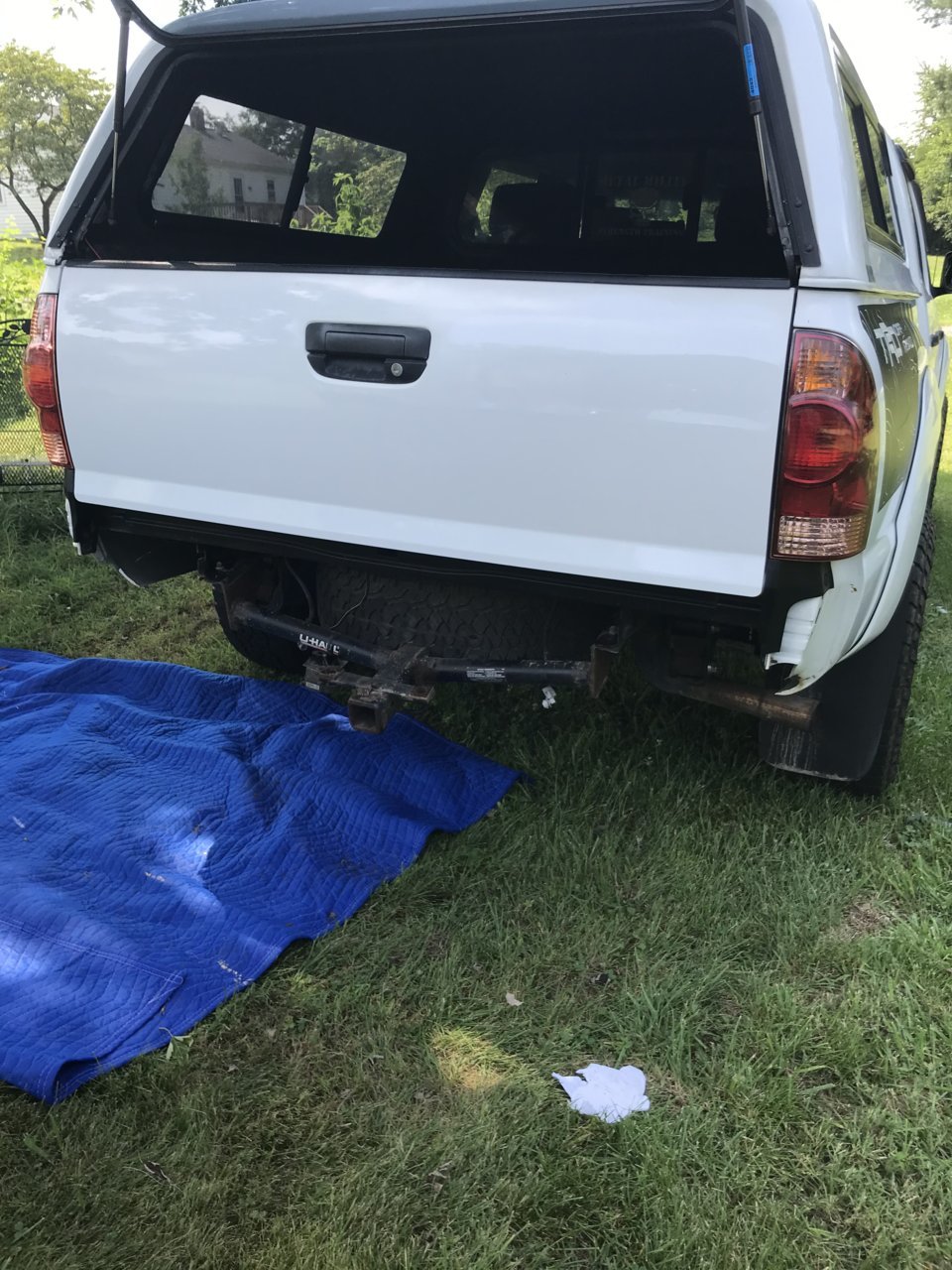

    Rear Bumper “Fix” and Bedlined
    B3746294-1A63-4717-A6F0-E205050FE593.jpg 99244FA5-230D-489E-9D5B-1950356096D0.jpg E2B7C4DB-735E-4344-96B6-0D236B96E8CB.jpg 7F39D911-F7EB-4DCD-84A1-075BDDCCD048.jpg F0C2E98E-194B-4CBF-BA92-E2CCACFE3ED7.jpg
    Straightened the bumper out a bit from an old low speed rear end collision. Finally got rid of the last of the chrome. Bumper was finished with white Raptor liner, and CaliRaised pods were installed with a CH4x4 switch.

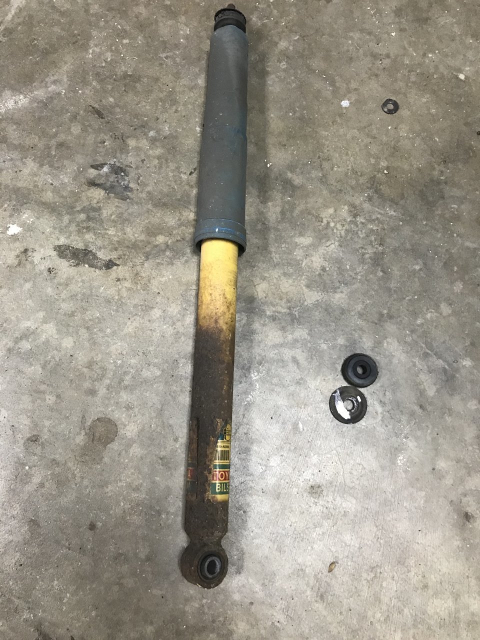

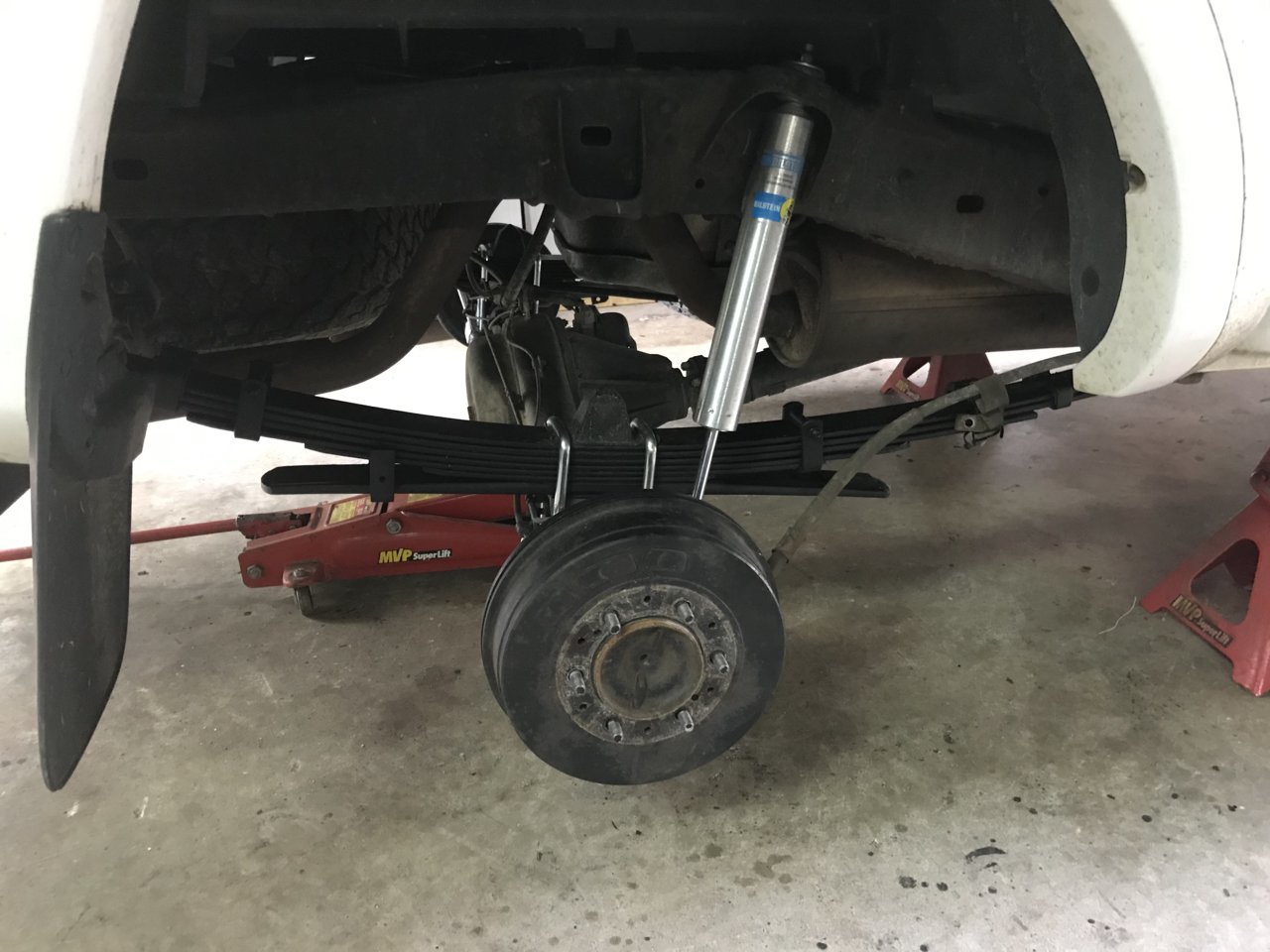

    Suspension Upgrade

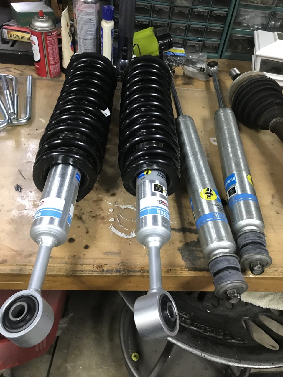

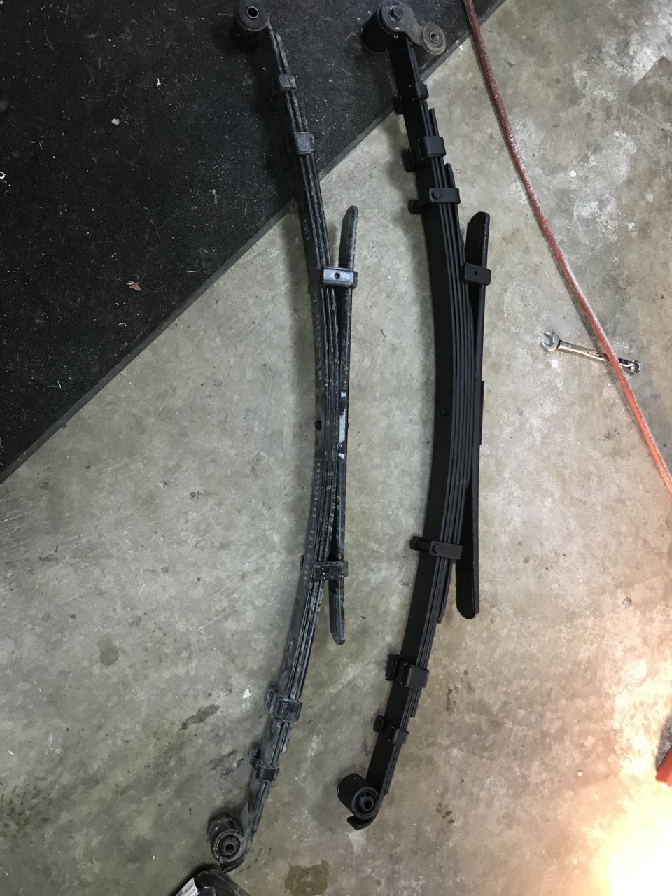

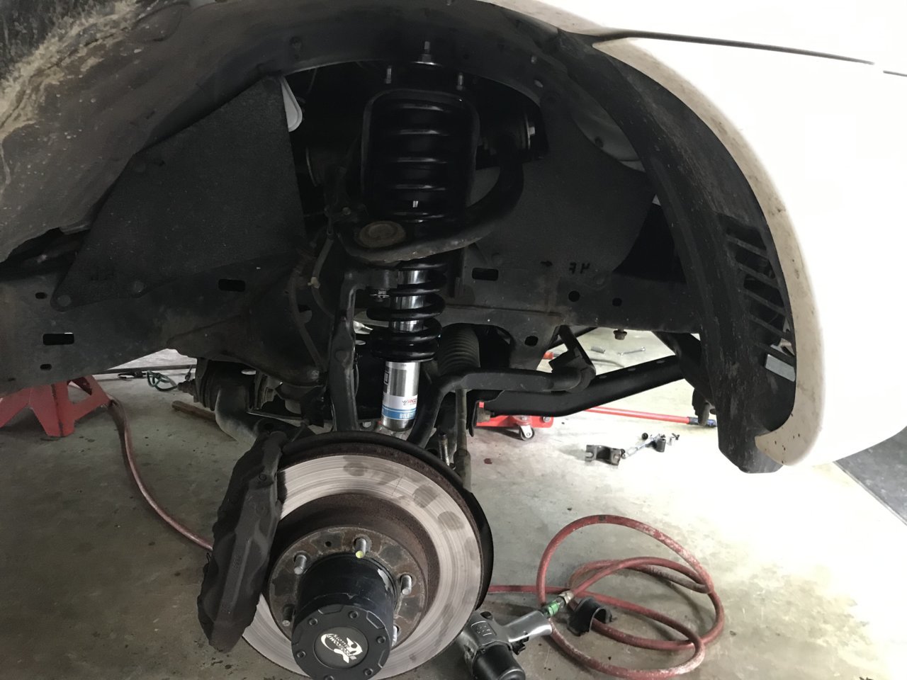

    Today was a big day with a huge thanks to @Casper66
    The old OR suspension was swapped out for new shiny things. With 160k on the old suspension I figured it was probably a good idea.
    5100’s w/OME 885 coils on the front, 5125 w/ 3 leaf AAL pack on the rear.
    The front went up 2.5” while the rear went up 3.25” and pretty much kept the factory rake.
    5D939CAE-1B4B-448E-99A1-7B0E2B262A5A.jpg 270625A4-693D-49A9-9176-B80020CA7D75.jpg A0986854-BEA3-4F2A-9CA2-8282C861DC96.jpg FED4F3E4-7924-4CE3-B74F-7E6C8EB0F0A7.jpg A41991EC-B02D-4141-BE35-EB74F7B522A9.jpg C58C95CC-1862-4A34-82F1-E813B7FB4113.jpg 916DAD84-EA29-4AC1-A962-94C806F0B3A8.jpg
    Some comparison shots of the old components with the new
    E12316EF-0FED-470B-9E91-7B386213A435.jpg F84A1E09-61D3-485D-A1E5-0E1F76C7D2B4.jpg 52A1E142-C15A-4CD6-8D70-0E73D4E0A012.jpg

    Good pics and I was surprised how well the suspension came apart thank the Lord.

    Clearly I had that “good rust” installed.

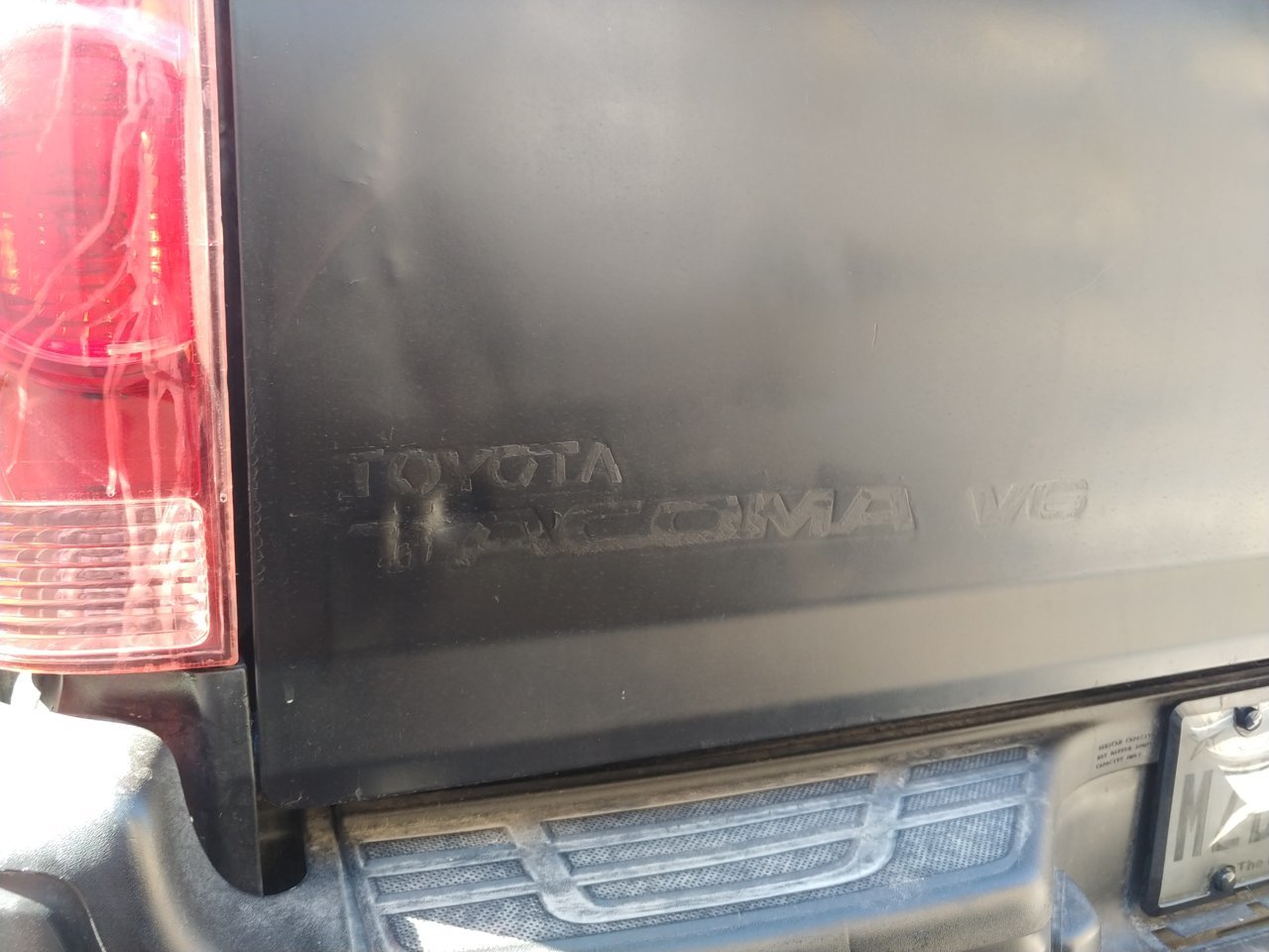

    Those headlights make a huge difference, I need to do that too. Where did you source your replacements? OEM?
    My tailgate was dinged up when I got it, the badges were all broken too so I just pulled the remaining bits off.
    Looks good :thumbsup:

    I couldn't believe the difference the headlights made. I got them from Low Range, they had the best prices at the time with free shipping.
    The badges were a pain the in the ass with 12 year old 3M adhesive on them. I've debated on painting them black and remounting.

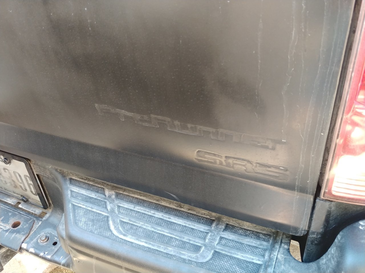

    I'll have to check Low Range for those. I got my extended brake lines from them.
    I still couldn't get all the adhesive off my tailgate!
    They're just in stealth mode now. :rofl:
    My tailgate was dinged up when I got it, and the paint was hit by an exploding can of brake parts cleaner (oops) so I just coated it with plasti-dip for now.
    It's lower on the priority list, but one day.

    I used WD40 and Goo Be Gone to get all the adhesive off, and a lot of elbow grease.

    If you really b the adhesive with your fingers it will typically roll off then a little gum cutter or goof off on a rag gets the rest. Just clean and wax the area good when you’re done

    I'll have to go at it again, I had kept it soaking with goof off for almost the entire day before I started working to remove it the first time. I guess the Texas heat really baked it on there!

    heat is usually your friend in removing this stuff. It can bake it on there though and make it tough good luck

    another opton may be to swing by a body shop and see if somebody can remove it with an eraser wheel for cheap

    I had thought about the shop option, but I have to repaint the whole thing eventually anyway so I figure it'll be removed fully at that point.
