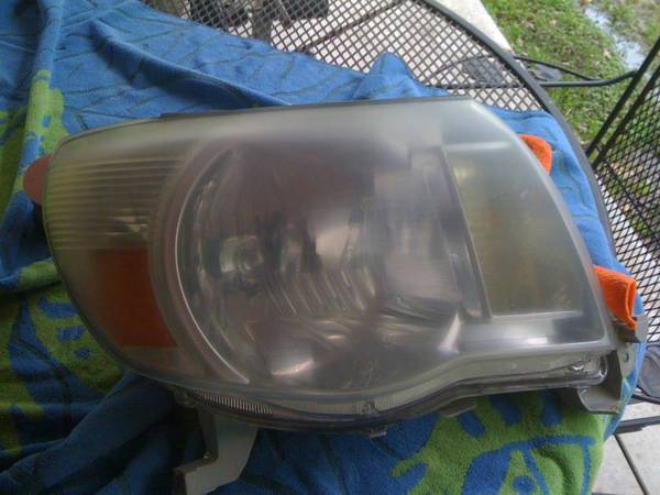

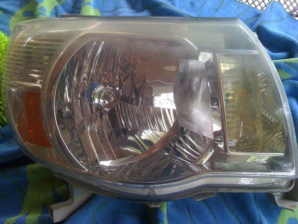

    Alright so I picked up some headlights off of here from PinkTaco24, They had some Haze when I bought them of of her so I thought I would do a review on the Meguiar's Headlight Restoration kit and give it a go.
    Here they are when I opened the package.

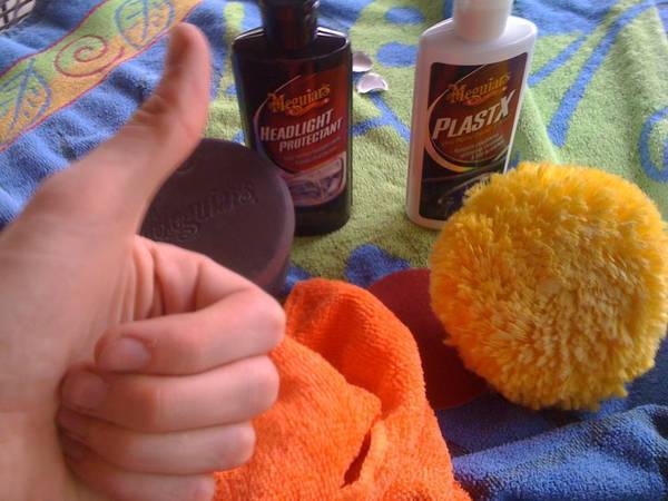

    Here they are after being prepped. About to start.

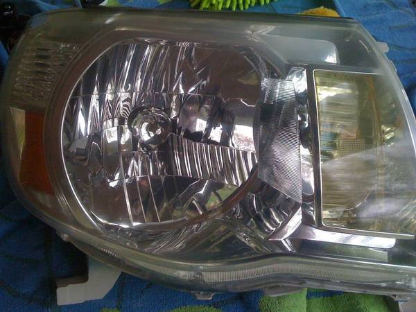

    After wet sanding with 1000 grit from left to right for a while and then sanding with 3000 grit up and down for a while.

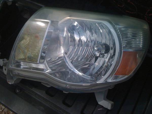

    After using the polishing pad with just a regular cordless drill and PlastX
    Before
    After
    Pretty impressed!
    I followed the directions step by step and didn't do anything out of the ordinary. Now just have to see how they hold up and if they ever revert
    back, The only problem that I encountered is that right by the turn signals it still seemed hazy but other than that it worked great!

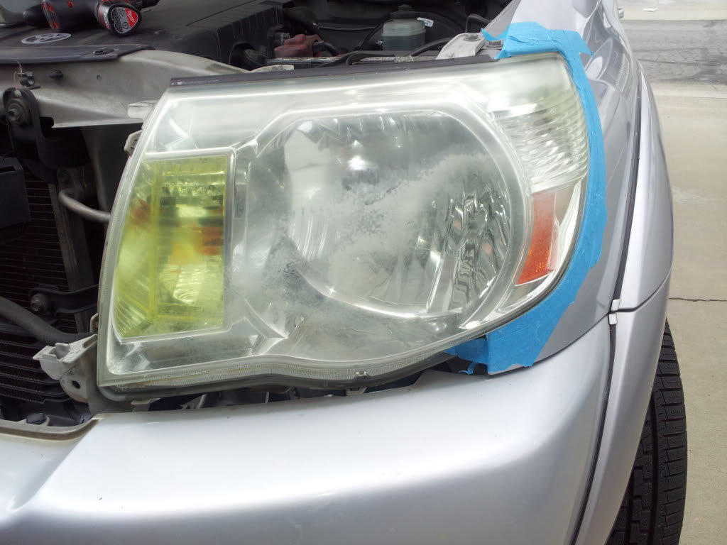

    2013-02-10131838_zpsb67c7533_ea6222c56552d252901731be90a87342320c27db.jpg[/IMG]I just used this product on my 07. It was very easy and with great results. Took about an hour of not so hard work. I didn't add a clearcoat this time i want to see how long it lasts on its own. I will repost as time goes on with progress 2013-02-10134221_zps9a02dbdb_3f1cb7dddcc5b60790bf939ac7b654c76d81e118.jpg
    Take the extra 5minutes to remove painted parts. Well worth it!

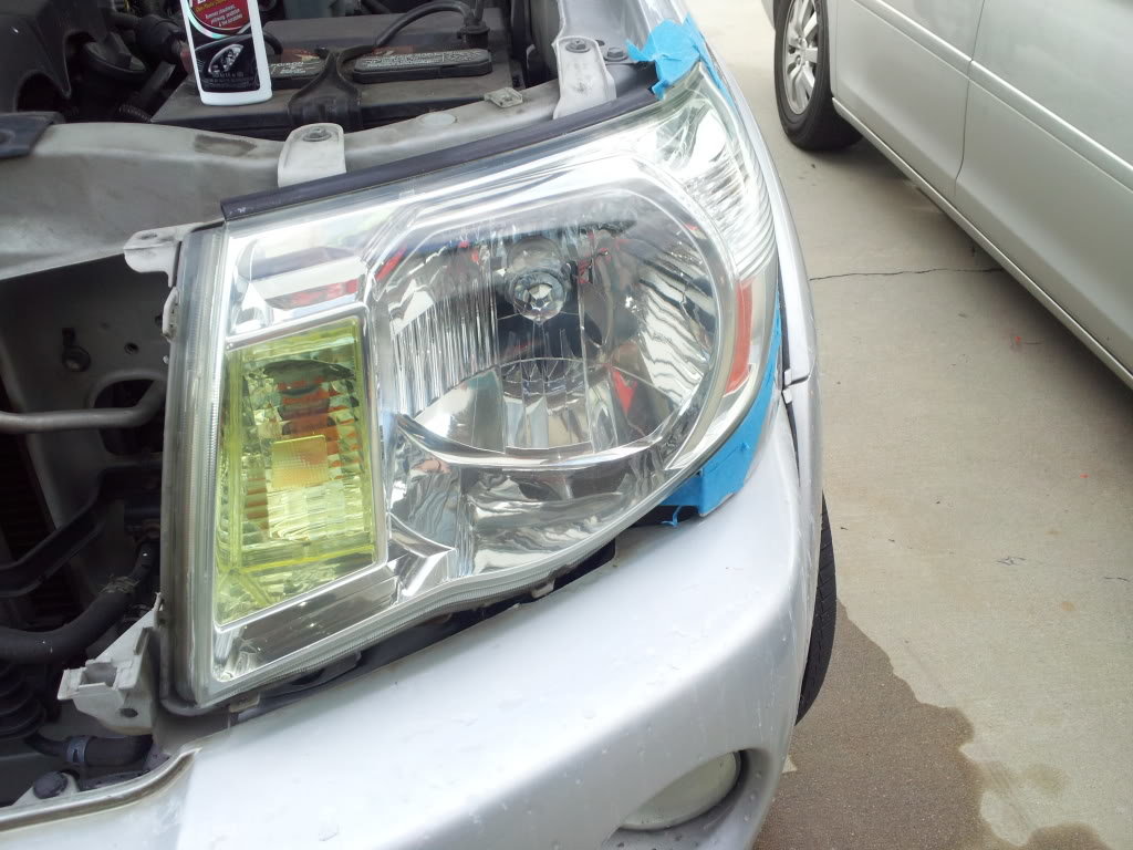

    How long it last depends on how much sun you get. Cali and Texas where you guys are out, yeah you will be lucky to get another year out of them without a lot of upkeep on the wax. Once its been sanded, you loose the UV inhibitor layer (which gets damaged by the sun anyways...) and the polycarbonate deteriorates faster.
