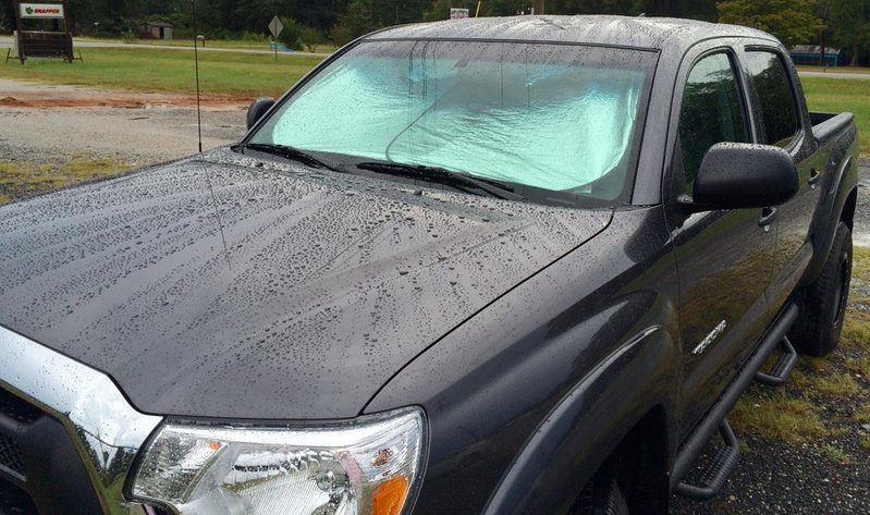

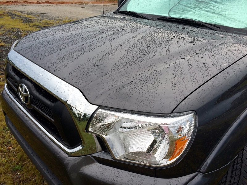

    Post rain results of the Ice Liquid Wax that was applied on Saturday. This was after a hour-long heavy downpour. The Tacoma was the only vehicle in the parking lot that was even beading water. Within a five minute drive down the road the entire truck aside from the bed was 90% dry. Color me very impressed.

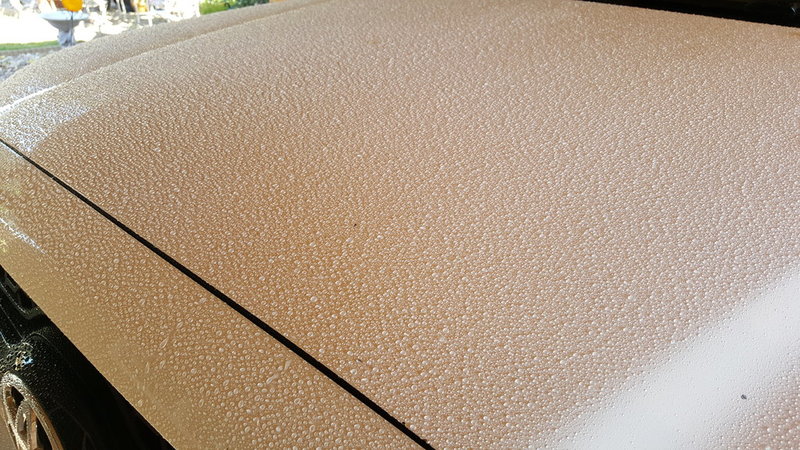

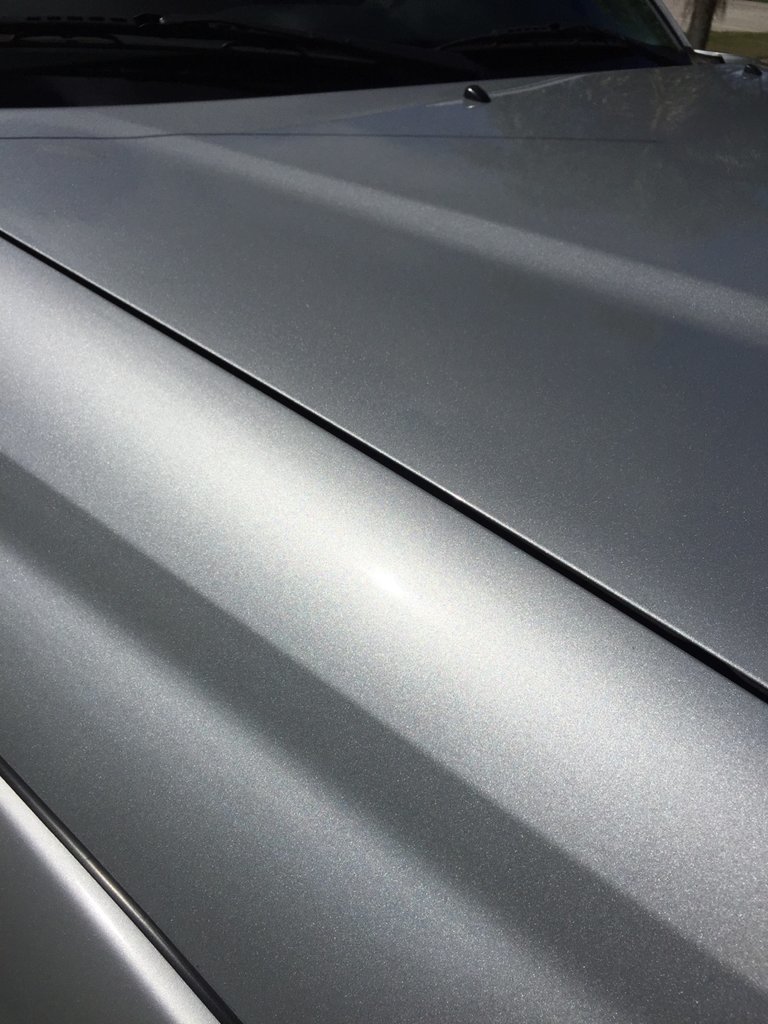

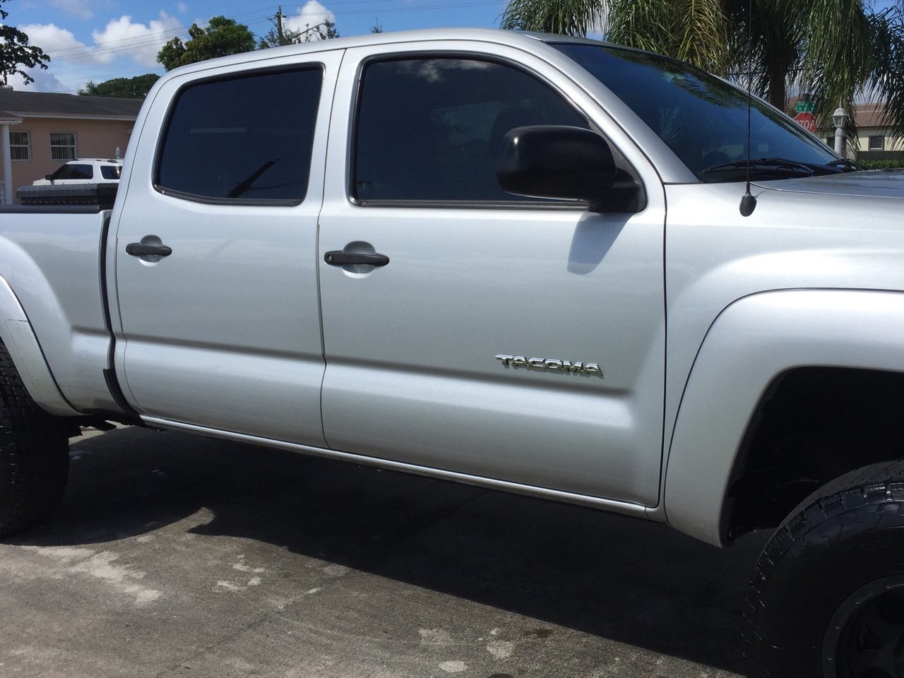

    After reading this thread the other day, I decided to give the ulw a try. I normally use klasse but am all out at the moment. I wish I would have taken a before pic. I hadn't washed my truck in over a year and it was a mess. Clay barred everything first and followed up with the ulw. Didn't think the truck would shine like this again. I use this truck for work and take it to the woods often during hunting season. The results are very impressive. Just hope it last.

    That color looks really nice when it's cleaned up. Nice work.
