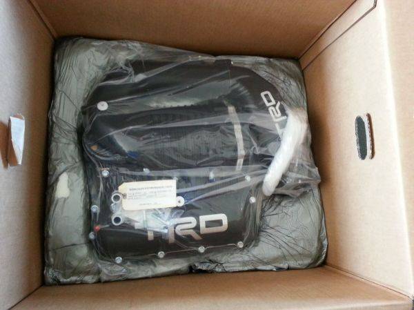

    It's here...

    I hate you. :rolleyes:

    I thought you were going to wait a bit and just run with the new pump for a few days?

    Torspd Custom Turbo kit [] Borg Warner 9180EFR Turbo [] Haltech Elite 2500 [] TiAL Q BOV [] TiAL V44 Wastegate @ 15psi [] CP Pistons [] CP Carrillo Rods [] ARP Head studs [] ARP Main Studs [] ARP Header - Head Studs [] Ported Heads w/ 1mm oversized valves intake/exhaust [] Brian Crower Forged Stroker Crank [] Darton M.I.D. Sleeved Block [] Kelford Camshafts [] Torspd 160* T-stat mod [] APR Large Fuel Rail [] Walbro 460 LPH E85 Fuel Pump [] FueLab FPR [] APR T56 Conversion Kit [] KP RACING Built T56 [] McLeod Racing Custom Twin Disk Clutch [] One Piece Aluminum Driveshaft [] MGW Shifter [] Custom lowering kit [] Ohlins Front Coilovers [] QA1rear shocks [] Custom Ron Davis Radiator [] Dual SPAL Electric Fans []
    Have you had the hood open, truck idling, and listened in the engine bay?

    I was... can't wait lol. I figure if it runs now with no leaks I don't see why anything else should magically come up?
    Not yet. I finished the pump install late last night and went and got gas (20 mi round trip). It doesn't sound bad and my sister could hardly even notice it but I know my trucks sounds and it was different. I don't know if it is a product of the new pump or what... but my high and low idle are about 300 RMP lower each. :notsure:
    Did you disonnect the battery during install?
