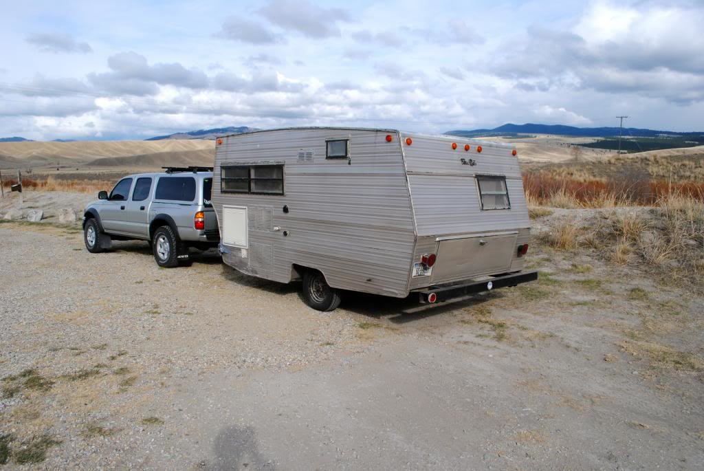

    Go ahead and post pics in here no bother to me. I will be honest and say that I remembered a smaller trailer than that though. Hope I wasn't too loud going by! lol When you gonna make it over this way again? I still haven't met you in person... :(

    I think the picture makes it look bigger. The trailer is only 14ft.
    I made a run to Belgrade and back today after class...Wanted to hang around a grill with Lisa but it started to rain and I had an assignment due tonight. :(
    I'm sticking around this summer, hopefully we can all get together.
