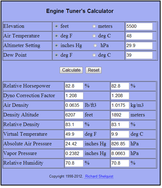

    Just did some calculations for my power levels based on temp, dew point, altimeter, temp at this very moment... LOL power levels up here are so sad

    So according to that you would only make 82% of the hp that you would make at sea level? When you run a dyno do they correct for that then and give you sea level hp?

    A dyno operator will set a SAE correction factor based upon altitude, pressure, etc. However, from the dyno overlays I have seen it is generally a pretty poor representation of actual power.
