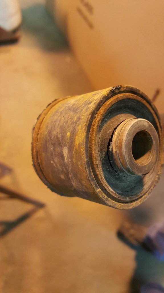

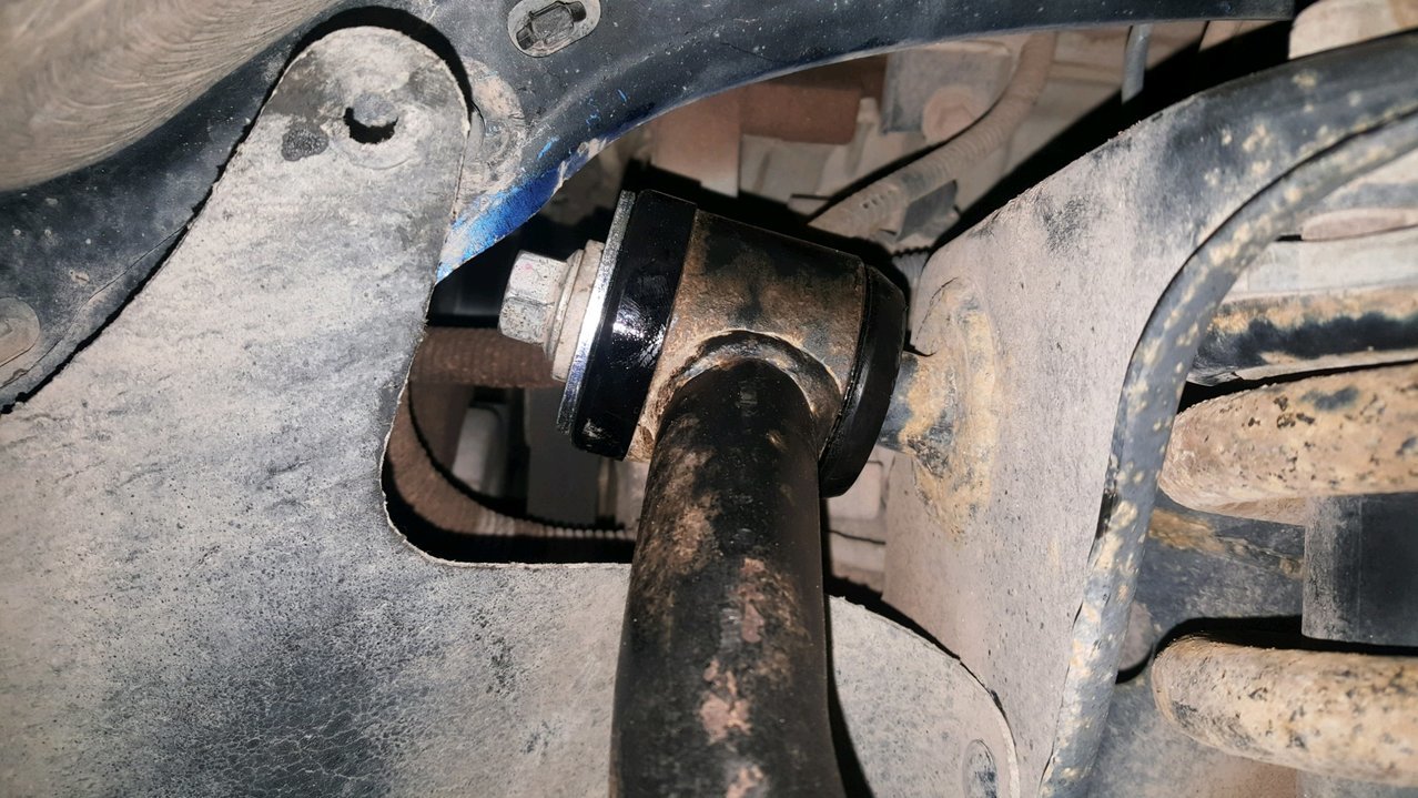

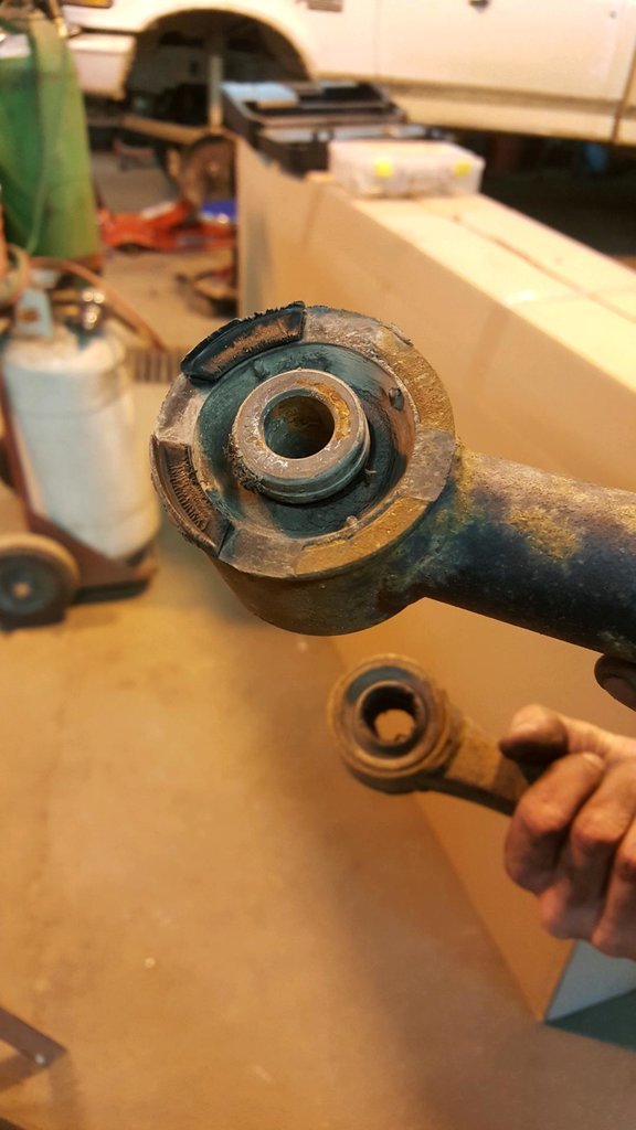

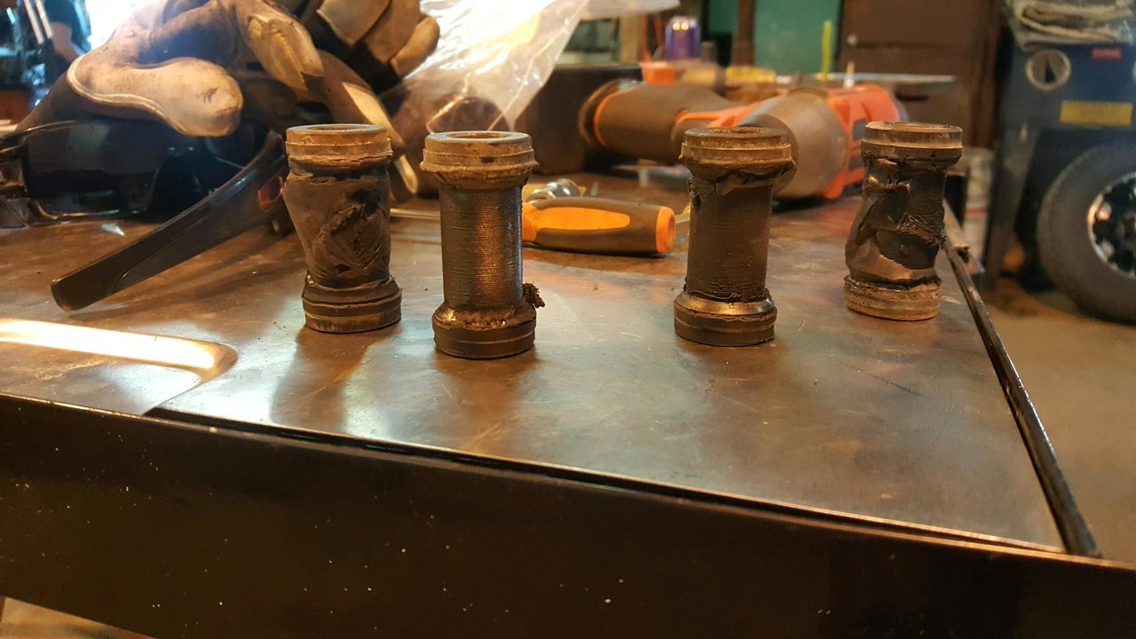

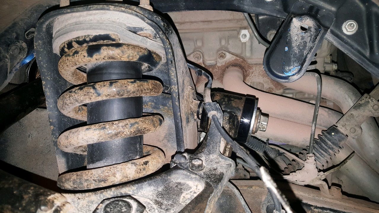

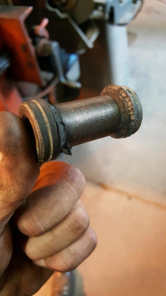

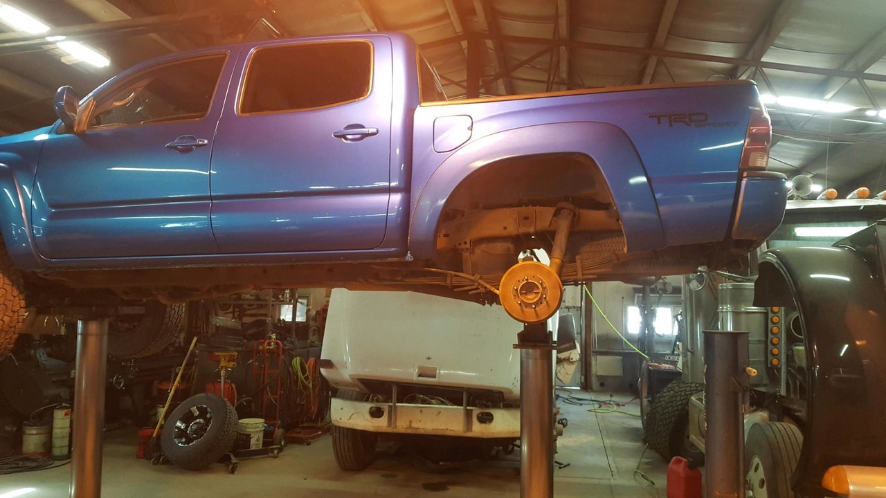

    Spent all day Saturday working on the pickup. Replaced some shot Light Racing rubber bushings with the poly ones that are MUCH better quality than those which they replaced. Also replaced the front bushings on my Dakar heavy packs with poly ones. Truck is going back on the lift tonight to replace the drivers side hub assembly and we will also be searching for a thud that I am experiencing when I have a stopping event when changing direction. Sound started up when I had replaced my CV axles so we'll start there...
    Last but not least I removed the 3rd leaf from my Dakar leaf pack and added a 1" block to compansate for the change in height. Ride is SO MUCH BETTER! I can actually feel the rear end of the truck articulate when going over obstacles. I really regret not doing this years ago. If anyone reading this has the Dakar pack that comes with the OME setup and is dealing with a stiff rear end do yourself a favor and get it done. Only thing I wish would be different is that the height decrease wasn't as significant as I was expecting and the 1" block actually lifted me a tad. If I get a hankering to change up my suspension again I will probably change the block out for a smaller one. Considering the shackle flip kit anyway. @Yager78 @bigstik
    Still riding that fence of keeping the truck or trading up. If I keep the rig I think that I will finally see what all the hubbub is about and spring for a set of Kings.
    P.S. Don't mind the rust. :p THANKS MINNESOTA. If I do decide to buy new shocks imma rehab everything underneath there. Good thing is that everything appears to just be surface rust.

    After installing my LR UCA I would not want to have to replace those bushing. Only because the bolt to get them off is a pita

    I installed the bolt backwards after going through the mess of taking it out the first time. Much easier insert and removal going forward.
