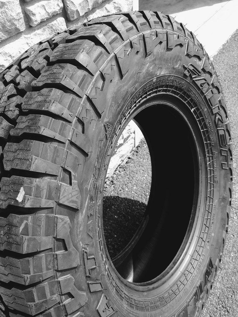

    Daddy got a new set of shoes today too :D Falken Wildpeak AT3Ws in 285/70/17. Just couldn't pass up the DTD Labor Day sale. Sucked me right in. Will be beautiful running alongside those Ray 10s

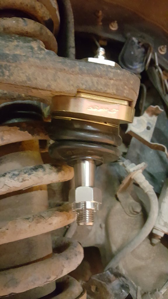

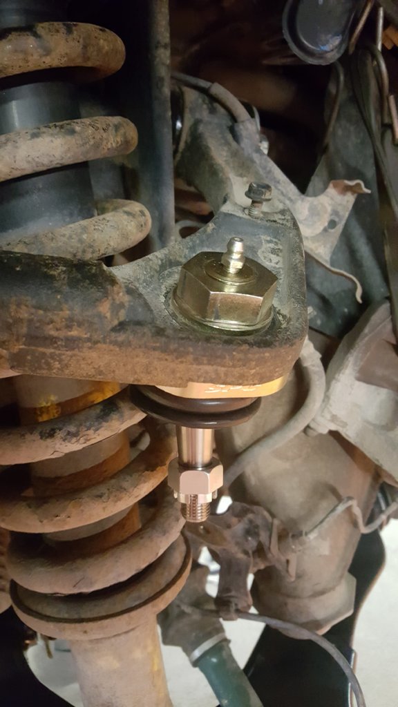

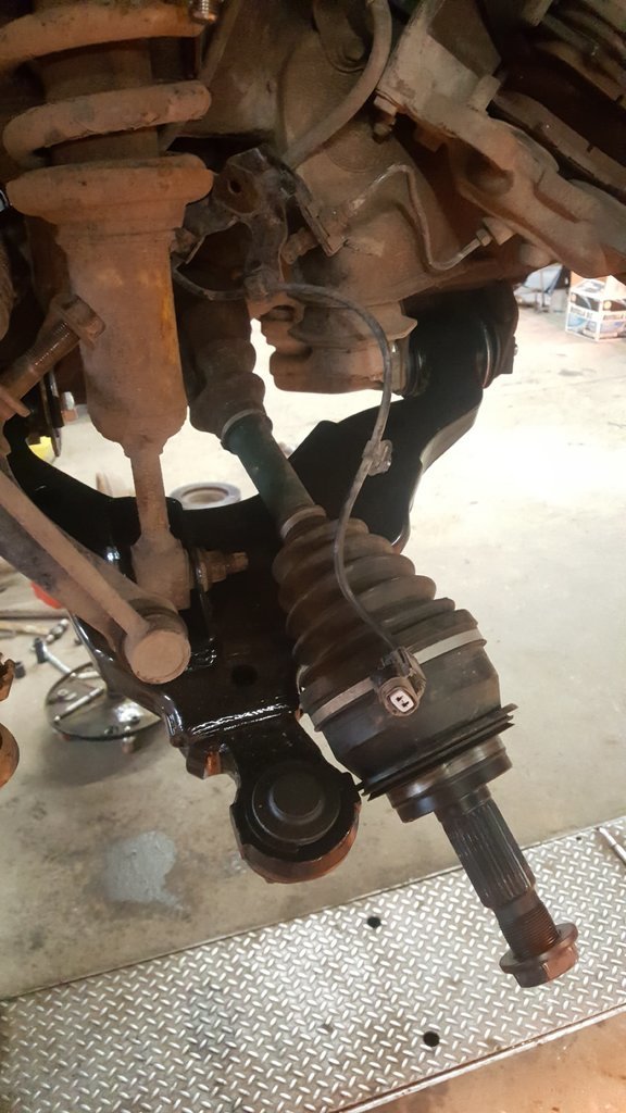

    Truck got some much needed TLC this weekend. Myself and @bigstik wrenched on the truck for about 7 hours getting everything done. That said, here is what all was completed:
    • LR UCA Ball joints replaced with new greasable design (joints were starting to make noise on both sides) - Both sides
    • LCAs replaced with Moog arms - Both sides - Will likely rebuild the stock LCAs as well with poly bushings for if I ever need them and/or resell on TW if I ever get rid of the rig
    • LCA bolts replaced (sleeves were nice and seized in there)
    • Driver's side hub replaced ( Thanks @nj636 ) - I bought one as insurance. Once we took everything apart it was apparent that the one needed replaced for sure.
    • Carrier bearing replaced (more involved than I anticipated it would be as getting the carrier bearing off of the driveshaft proved difficult, but we managed)
    • Stainless steel extended brake lines installed on rear end - In anticipation of hopefully funds coming through for a little extra travel down the road :spy:
    No more clunks or noise of any kind from the front end :woot:! Platform has been reset and ready for upgrading. Now I can get this thing aligned and ready for the ever beautiful SCS Ray 10s and the new tires that I have sitting around. Next on the to-do list is to clean up some of the surface rust I have on the spindles and UCAs + other misc areas on the truck. Considering the age + 2 winters in MN it actually isn't too bad in the rust department. Lots of surface rust, but nothing that is concerning in the way of a real issue, which is marginally refreshing, but I wouldn't turn down a new frame. Would all but solidify me owning this thing for a very long time.
    Few other things in the works, but $$$, so we lie in waiting for a moment to pounce.

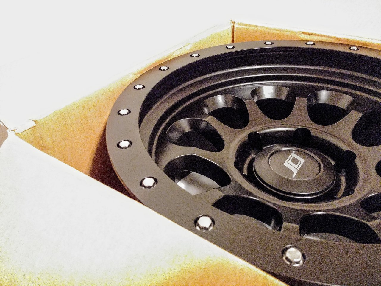

    OH SHIIII..... I did a thing today. Will get better pics someday, but for now here's your tease! Dont mind the park job :pccoffee:
    SCS Ray 10s wrapped in 285/70/17 Falken AT3Ws
