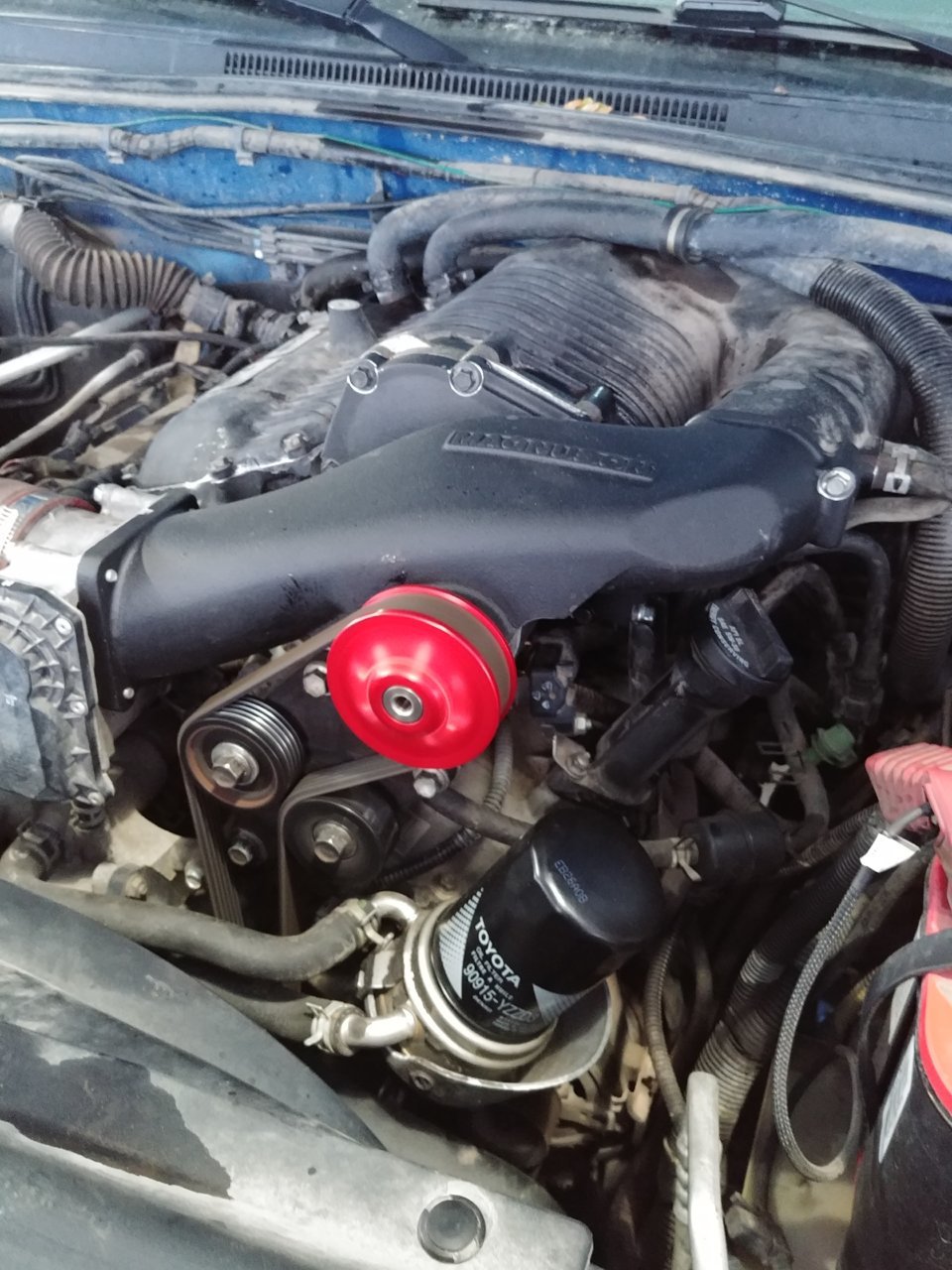

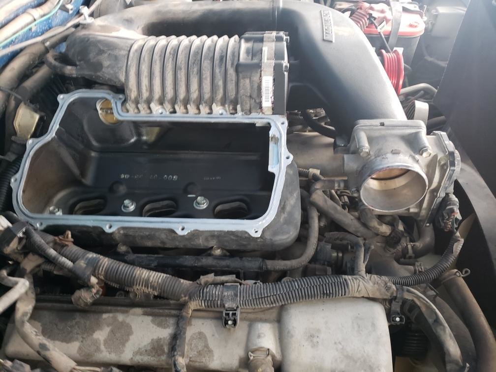

    Bout time I update this damn thing! A few things have gone down in the last few weeks. The big one was the supercharger rebuild! Expensive AF, but it just needed to happen... Had 60k on the blower before she decided that it was time for a rebuild.
    [​IMG][​IMG]
    Don't mind the hilariously dirty engine bay. I'll take care of that this spring. Either way, the nose drive seal went out, and was giving up fluid. It was only a matter of time before the bearing decided that it was tired, and gave up the ghost. So the teardown commenced... After pulling it apart it was determined that trying to rebuild that nose drive assembly would not be fun, and since my truck is the DD I didn't have a ton of time for it to be down for the count. I reached out to Magnuson who charged me a nice cool $500 for a new nose drive assembly. I no longer have a TRD nose drive though... I'll look into what it takes now to rebuild this OEM one. Also purchased a new URD 2.85" pulley to have a fresh new setup. Since we were in there I checked out the idler pulleys, and they were SMOKED. Replaced both of them as well. NAPA was very proud of them too BTW, pricey little bastards.
    Took the whole blower apart inspecting the rotors, and the other interior components. Everything else looked A-OK!
