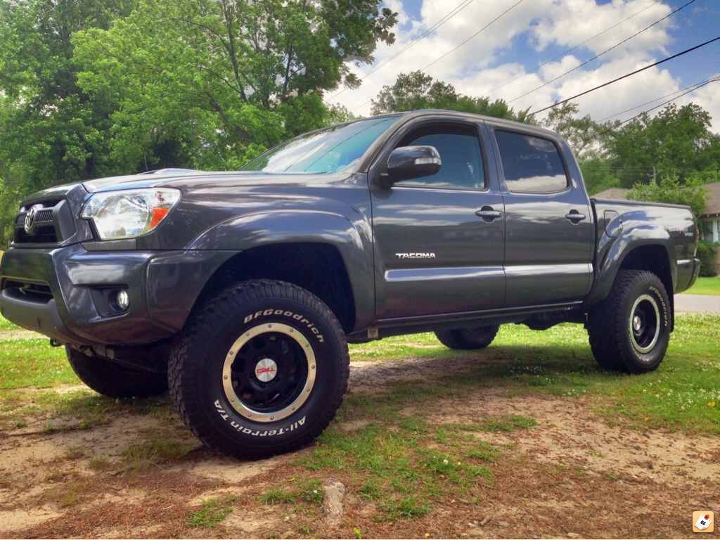

    2.5" spacer up front, 1" tapered block in the rear, TRD Beadlocks, 285 BFG AT's
    I'm running hell bent steel 2.5" top plate spacers on the front with Low Range offroad tapered 1" blocks in the rear. With my sport coils it rides identically to stock. The only difference is the heavier, stiffer tires. It clears 285's no problem and looks great in my opinion.
    All together was less than $175 and install was about 1.5 hours.
