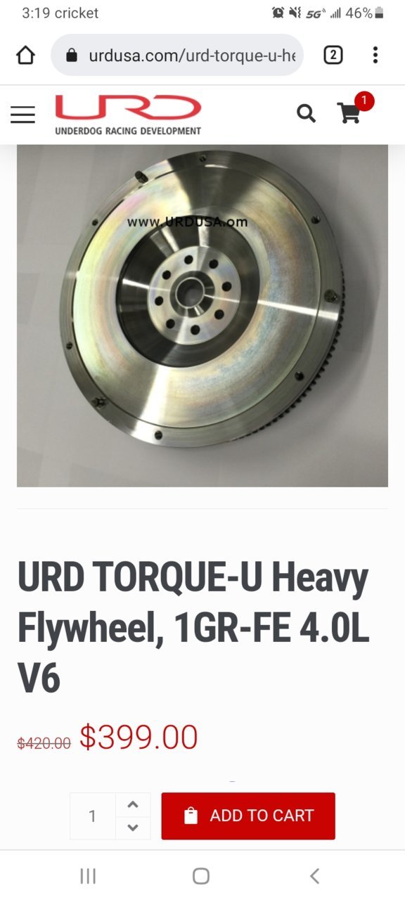

    Screenshot_20220219-151924_Chrome.jpgProbably doing this

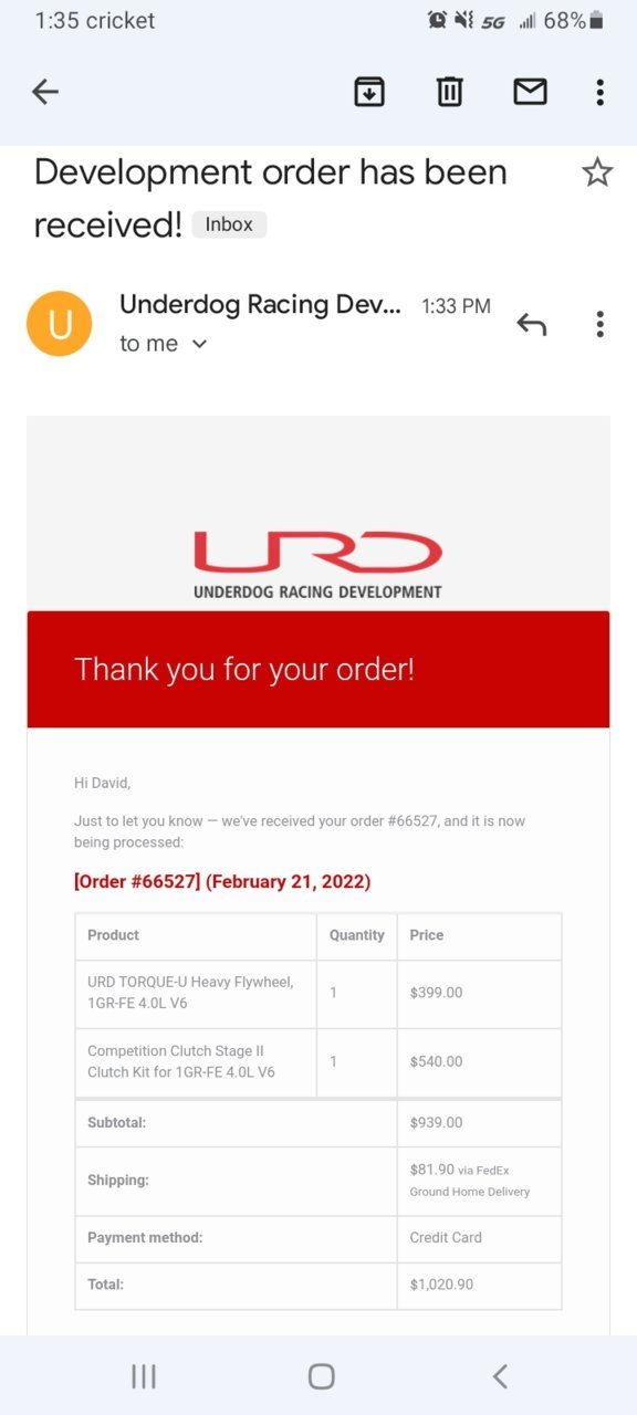

    Screenshot_20220221-133505_Gmail.jpgWent ahead with the heavier flywheel and a stage 2 clutch. Also the release bearing fix. Never ran any performance clutch. About to go from 265 70 17 to 285 70 17 also. 2" lift front 2.75" rear lift on O.M.E springs and bilstien 5100's,adjustable sway bar endlinks,1" diff drop, freedom off-road UCA'S, Tom Wood's single piece double cardan driveshaft,Tom Wood's double front driveshaft, ECGS sintered bushing fix, MBRP high flow fart can,TRD Runner wheels.
    Can't find a new truck I like so I do this.
    Toyota replaced my frame,fuel lines,brake lines LCA's and most bushings in 2018 for rust perforations.
