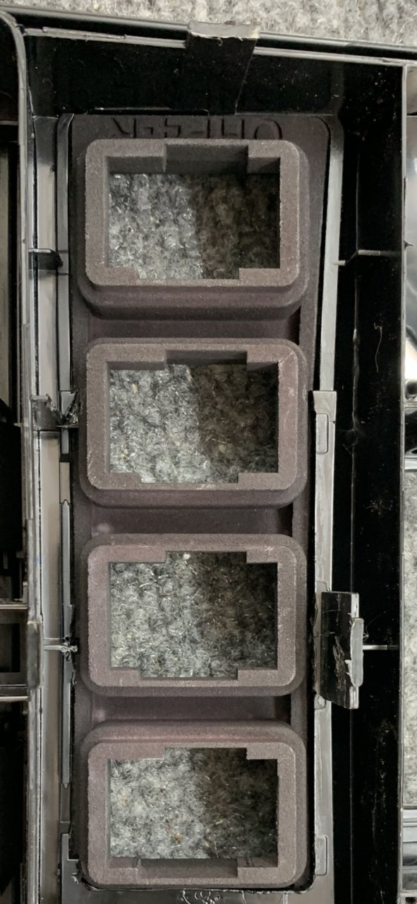

    Anyone put in the Meso 6-switch panel in their overhead? I am having issues. I got everything trimmed out, but it seems that there is no "lip" on the console itself to support the switch panel. It pushes all the way in on the right side. Am I missing something?

    Unfortunately to fit that many switches, you have to trim out most/all the plastic in the back. The panel will sit flush... but push out the back unless secured in place. I suggest to get it sitting correctly, then use JBweld or your preferred epoxy and go around the perimeter on the backside securing it in. Tip: Use a thicker viscosity epoxy so it doesn’t drip and run through the cracks of the panel when drying. here’s a quick pic of the backside showing all that’s trimmed out. Good luck!

    Ok, cool. Just so I am clear, all of the plastic on the backside of the console needs to be trimmed out?
