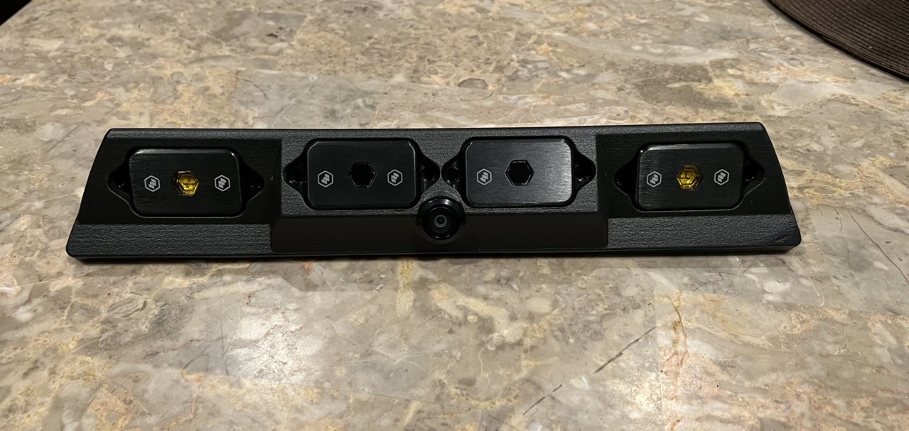

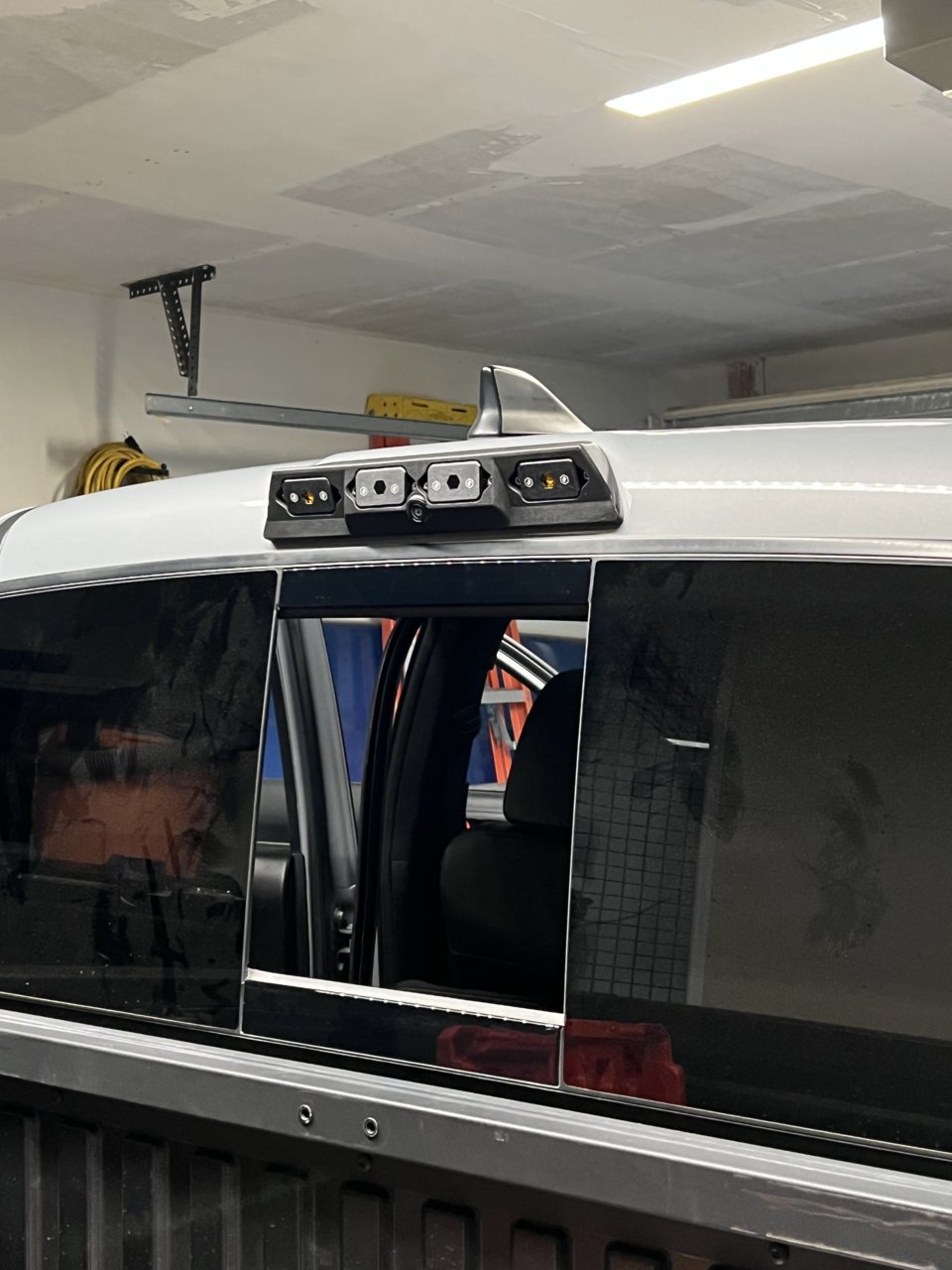

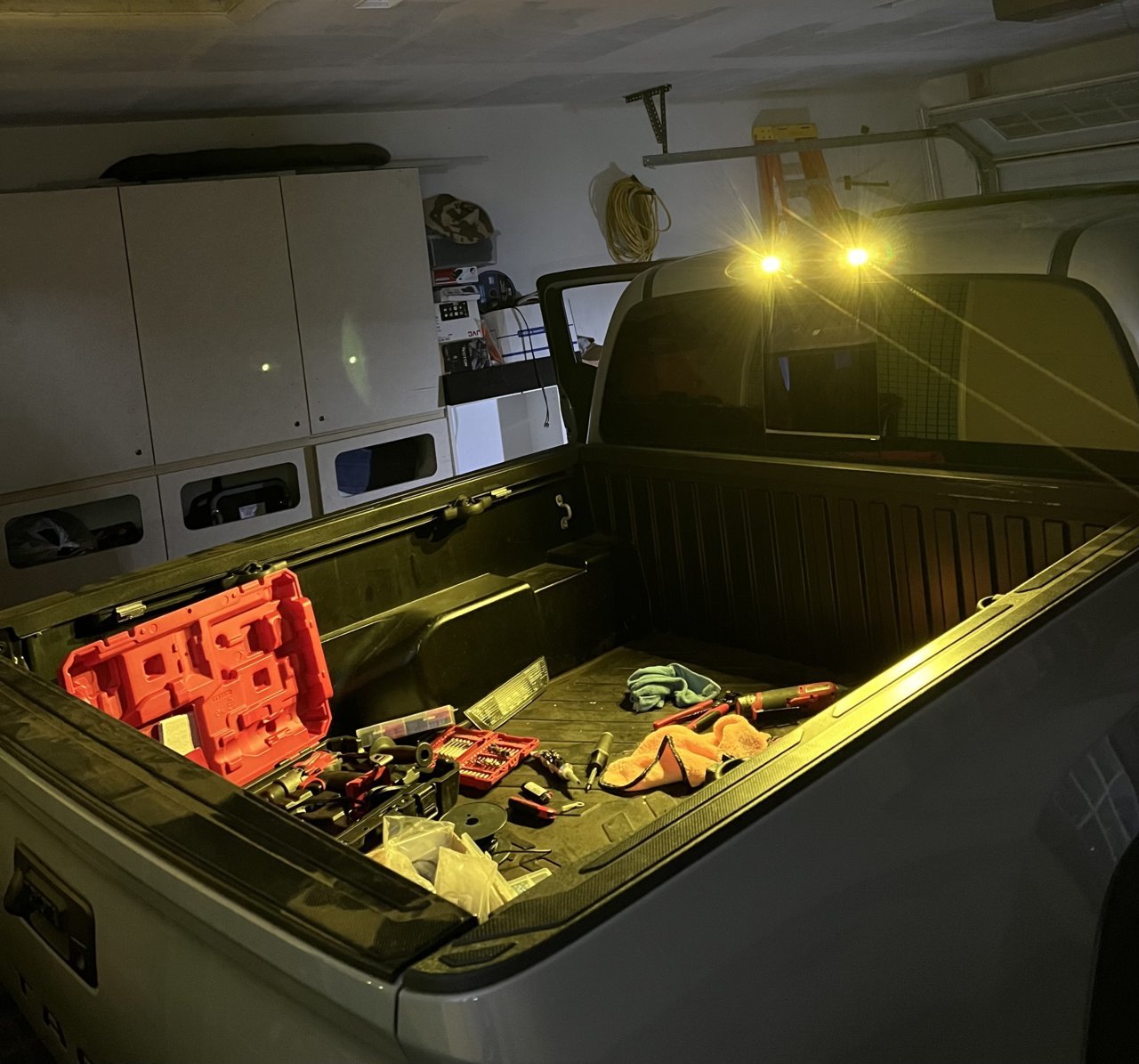

    Installed Meso BD4-CAM third brake light. Love the look and the light output. Thanks to @Xx_Evilvirus_xX
    1F4DBFA2-4A33-4DFF-A82D-21C759CE88A9.jpg DBAEB4A5-5E2B-4797-9A42-B0732E259F1E.jpg 5B6B904C-2DEA-48AE-95D8-EF749DD3087F.jpg

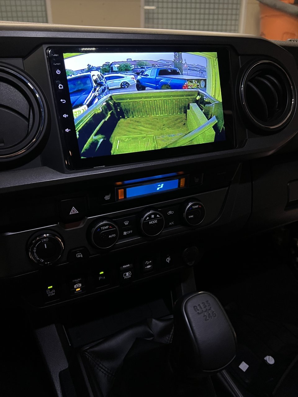

    Pic of camera view?:popcorn:

    Here it is with the ambers on. I’ll get a better shot during the day tomorrow.

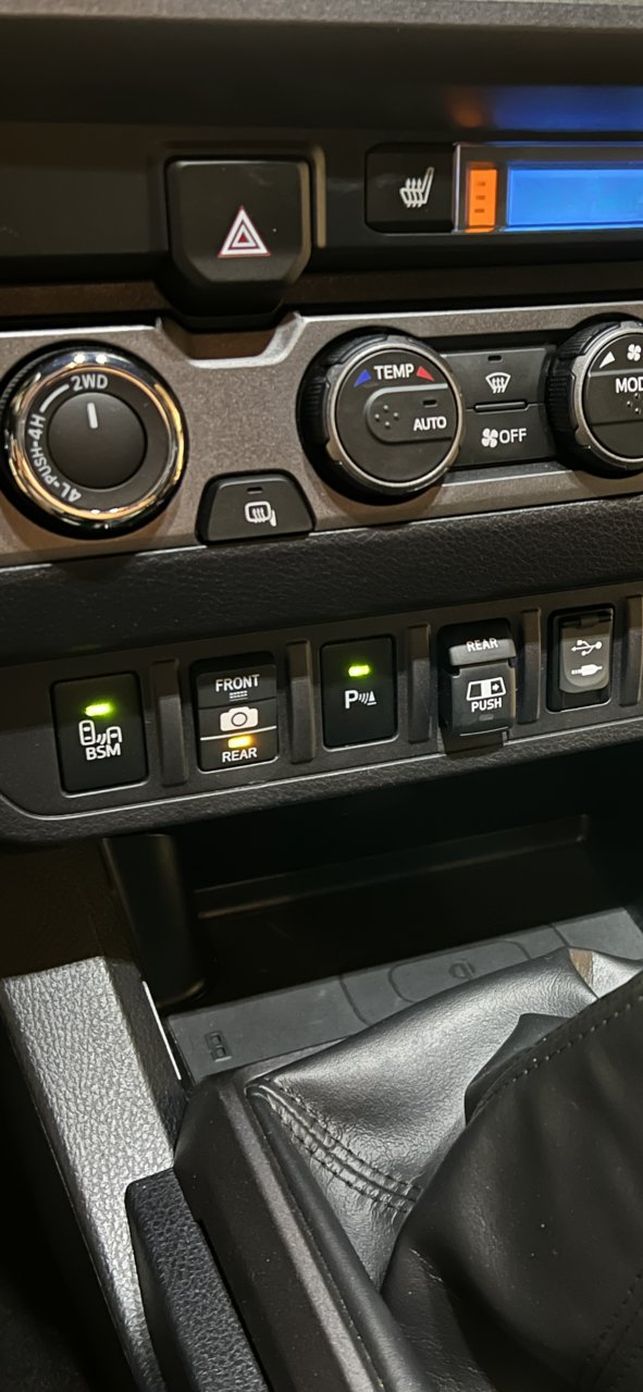

    Also wired it to the anytime back up camera switch.

    What a perfect cam angle:D. Dig the Yellow bed lights.
    Which model camera?

    Thank you! I used the echo master Pcam-220.

    If you connected to the anytime backup camera, does the rear camera still operates at anytime or only in reverse as normal? I am assuming not anytime...

    :gossip:Anytime the switch is selected to the added cam...and vehicle on or at acc.

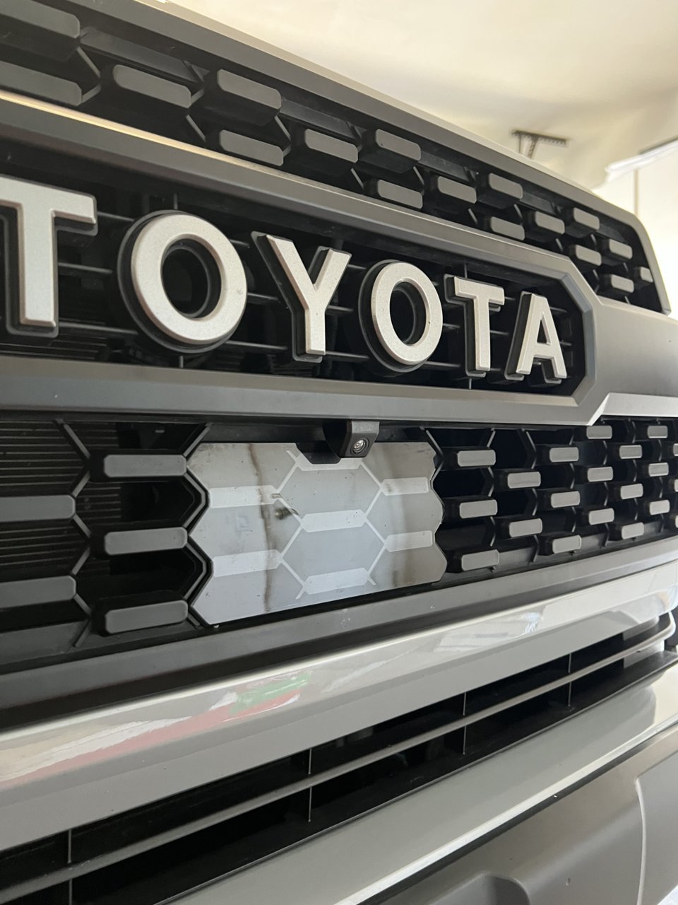

    The added third brake light cam comes on anytime with the switch. The OEM reverse cam still operates are normal. Also added a front cam as well. EB3A3EBA-ABFA-4D04-B280-3E479DE51FF1.jpg

    Only one anytime switch. I did not connect the OEM reverse cam to the anytime switch. The “rear” on the switch controls the new third brake light cam and the “front” controls the front cam.

    I have the same setup and it's a fantastic third brake light. The only con I found is it interferes with the keyfob signal. (have to keep cargo lights off).

    Yes I do get key fob interference. I have to leave my cargo lights off in order for my key fob to work.
