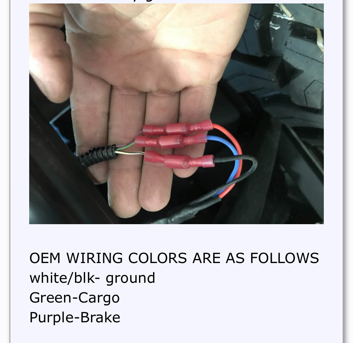

    has info come clear on wiring these? it looked like the pigtails mentioned aren't the right size... do you know if that's confirmed, and what wiring solutions are available? I'm sorry if i missed it.

    The pigtails are not used for 3rd gens. There is just 3 wires- ground, brake light, and cargo light.
    The KC lights just have one black and one red. All reds from the KC brake lights are connected together then to the purple wire, all reds from the KC cargo lights are connected together then to the green wire, and all the blacks are connected together to the white/black ground wire.

    Looks like @PapaRee helped ya out there! It's all about just marrying up colors. We were working on attempting a full plug-and-play solution, but the R&D for the opposing plug was going to be hilarious for a limited run product like this.
    Are you comfortable with splicing/crimping wires?

    thanks for the reply. yes I'm totally comfortable with it. i just wanted to see specific wiring for the kit, making no assumptions. :thumbsup:

    But if I understand correctly, on the 2nd Gen’s, it is not about cutting and splicing I don’t believe? We need something like what @74cam did: https://www.tacomaworld.com/threads...ake-light-build.522181/page-106#post-20318074

    Have not seen many install info on the 2nd gen’s, but the new housing from meso just installs over the back of the exsisting housing, minus the red lens? Am only going by @74cam install pics. So there are no bare wires to grab like the 3rd gens? Correct?
