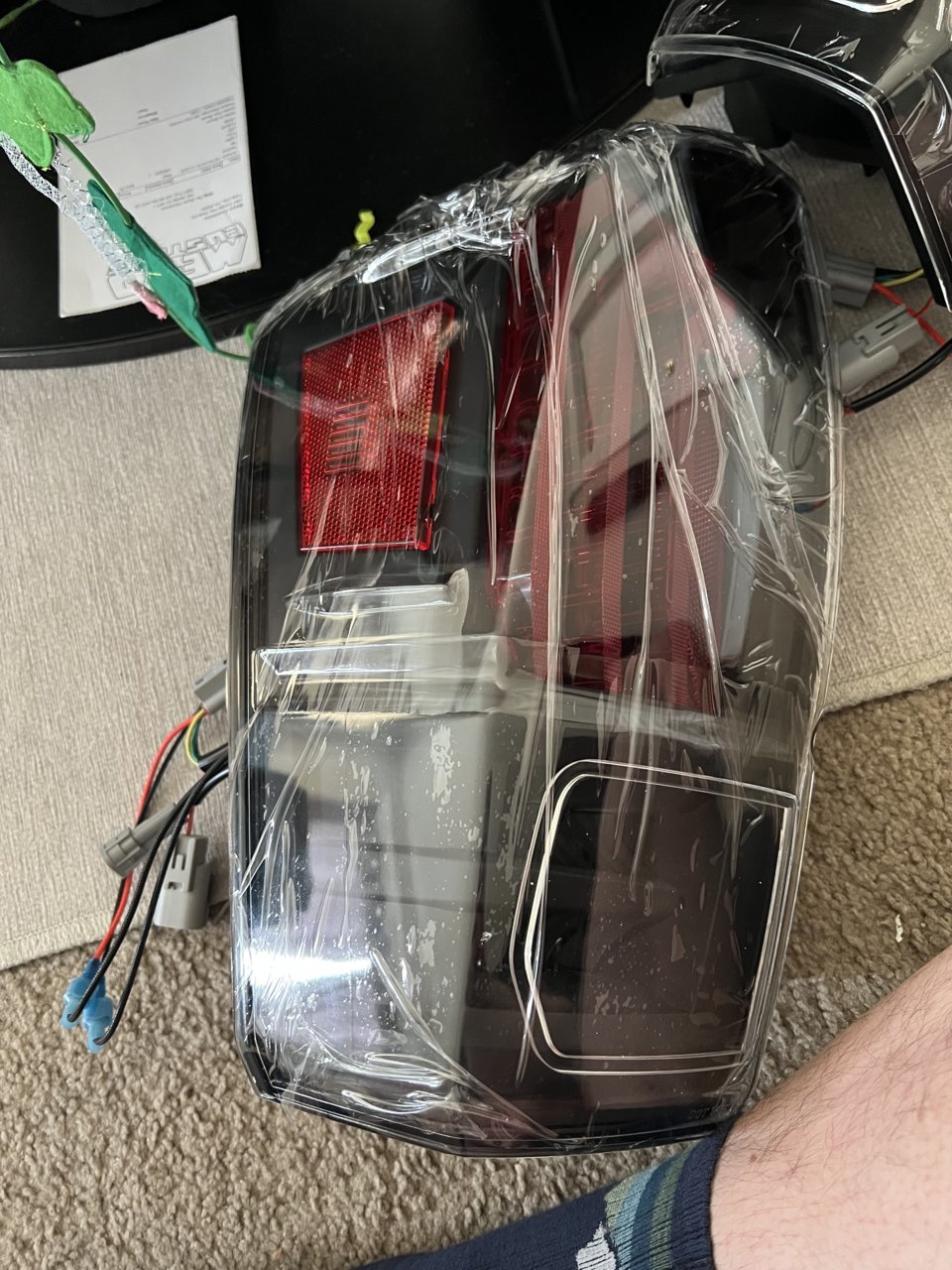

    Just got mine in, heading outside right now!
