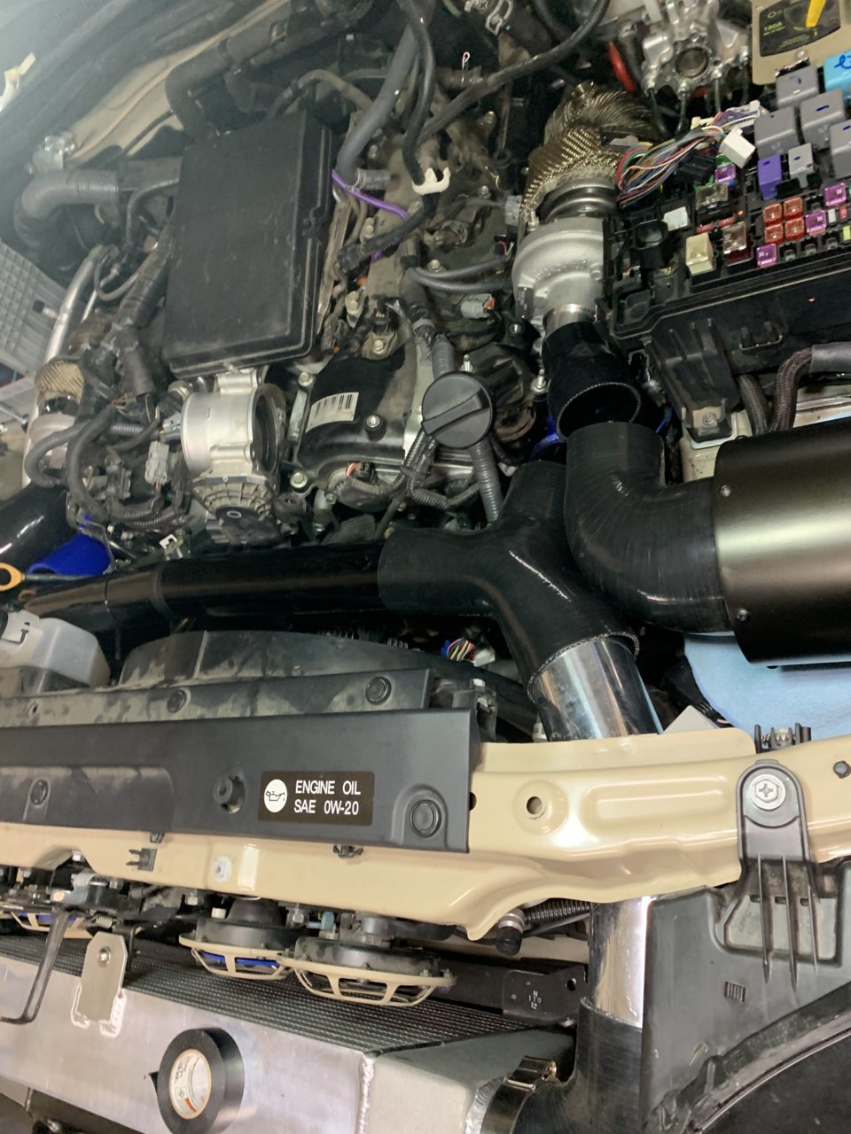

    Are you running into any issues mocking up the fmic or anything else while installing the turbo kit ? I have a bumper with winch and I'm hoping it fits.
  14. Aug 25, 2020 at 9:55 PM
    #1794
    MESO
    MESO [OP] Major Modder Vendor
    Feb 16, 2015
    #148809
    16,292
    State of Jefferson
    2016 DCLB TRD HELLCAT SWAP

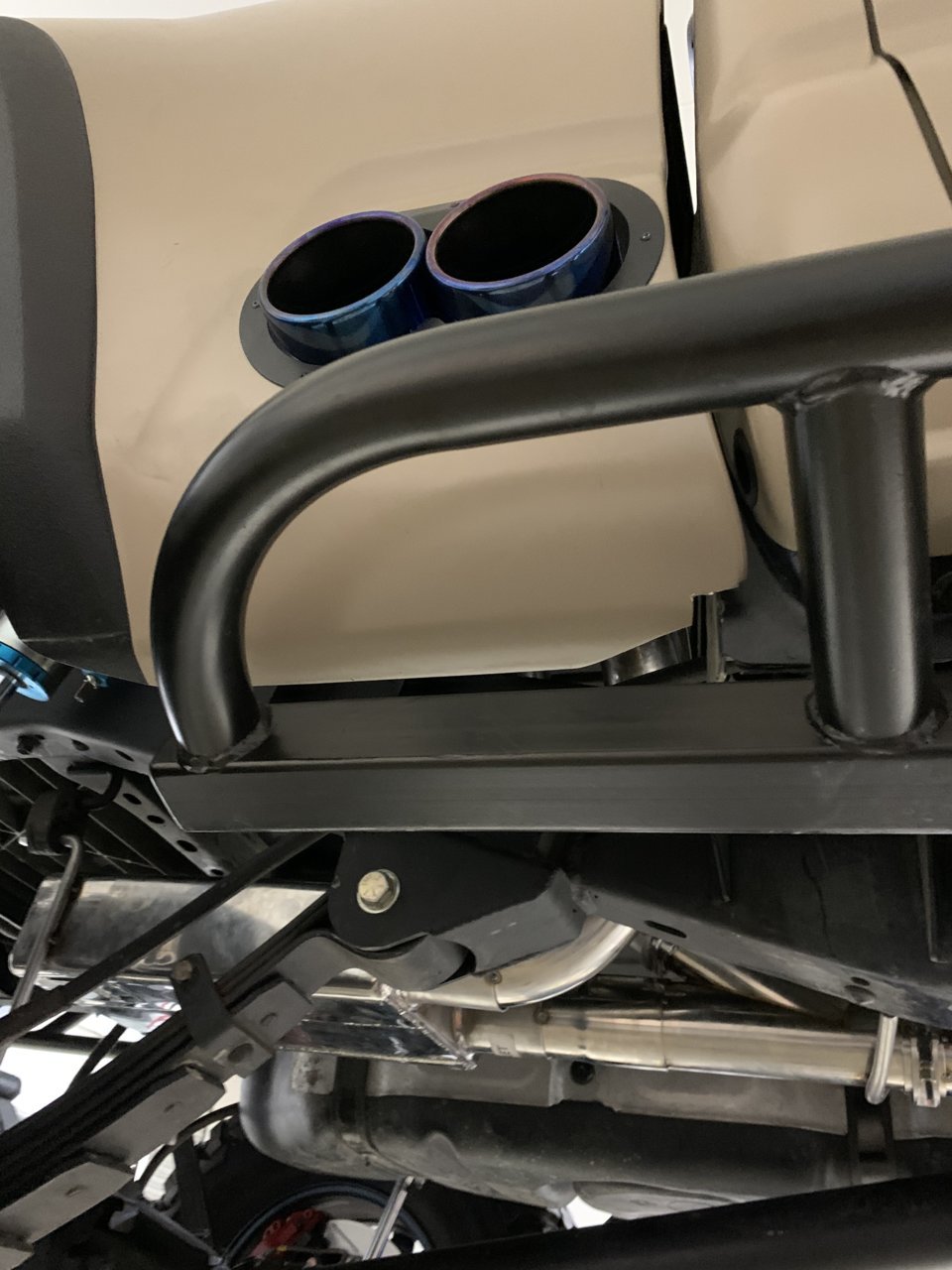

    Yes, many things needed to be modified or removed. Although I’m doing more of a custom setup from what OV is releasing. (Using most his parts though)
    Do you have a TT kit ordered?
    Haven’t updated this thread in a while...
    Lift time

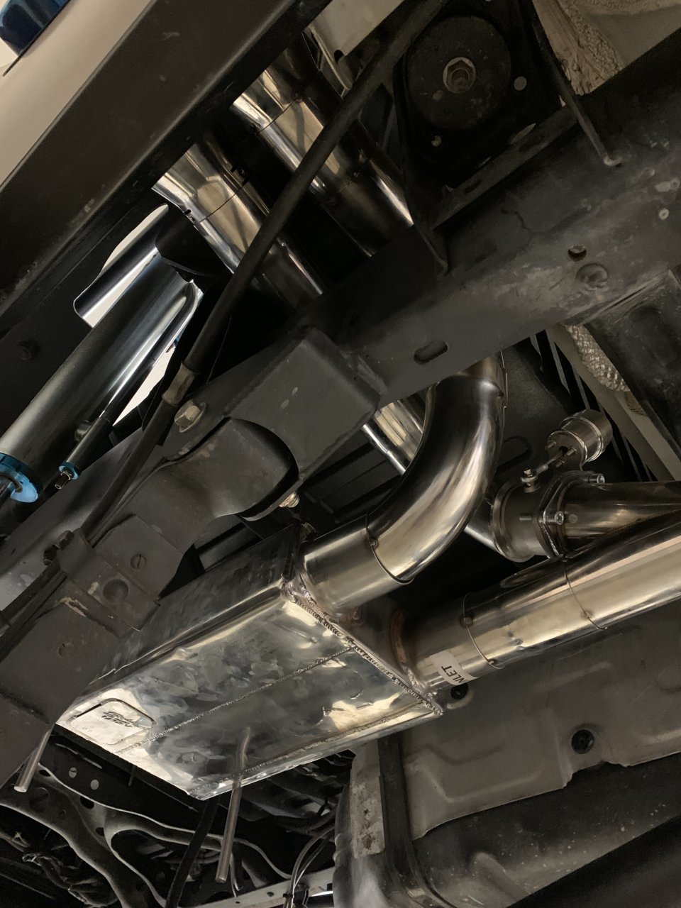

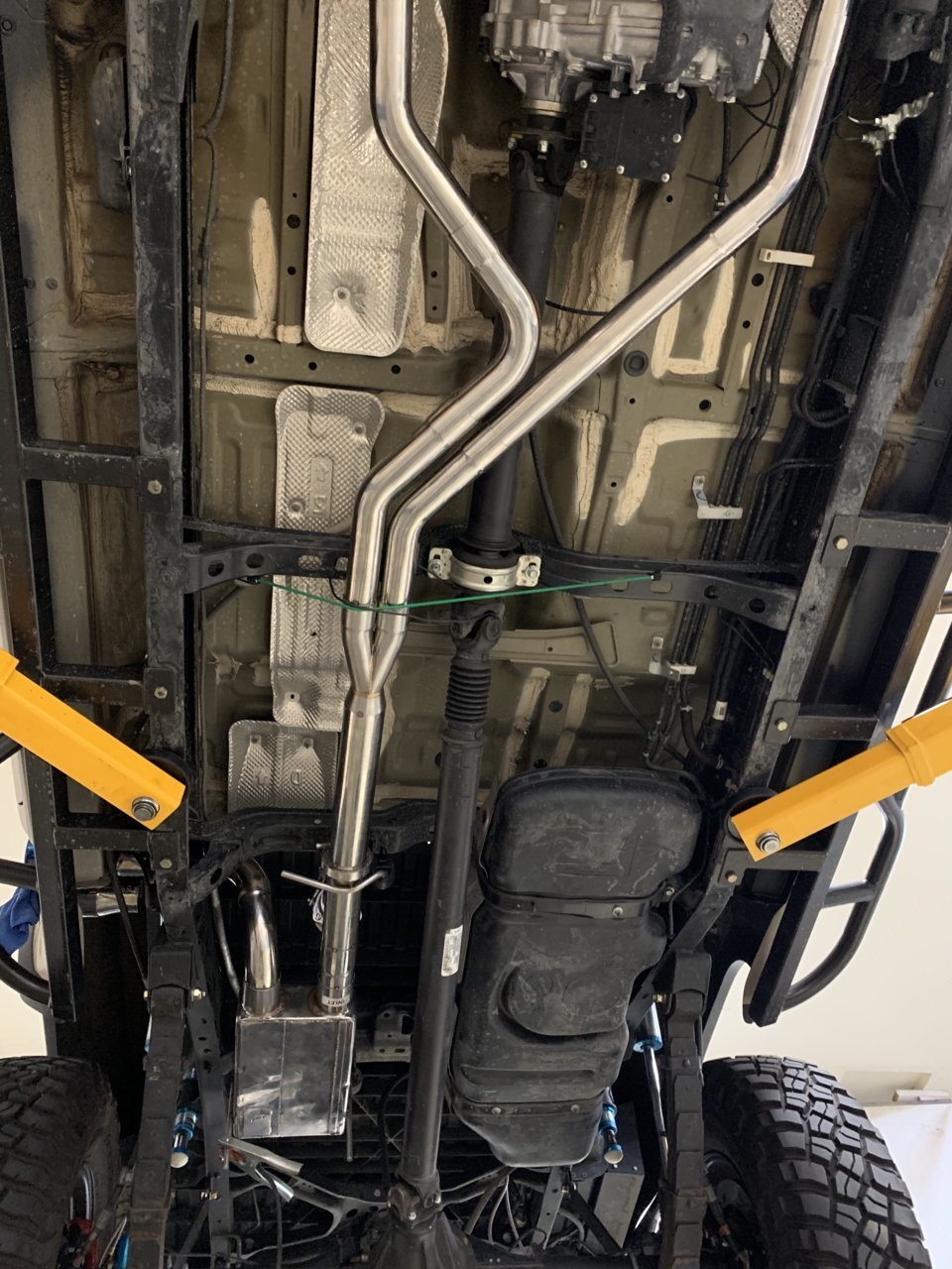

    Exhaust mock up. 2.25” downpipes off turbo no cats—>Dual 2.25” Y pipe(equal length)—->3” side exit(with bypass)
    My exhaust tips are BUSINESS IN THE FRONT(Front tip-muffled) and PARTY IN THE BACK(rear tip-straight pipe)
    twin spooly bois:eek:
    downpipes wrapped to keep some heat in
    Final testing of all the IC piping. So many fittings..
    finding a spot for my BLow off valve. I wanted it pointing out the hood scoop. At least it would finally serve a function?

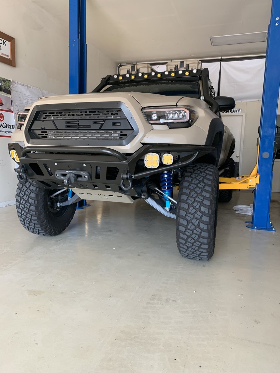

    What lights are those on your bumper?
    is that an xl next to an s2? Or a squadron and an s2?
