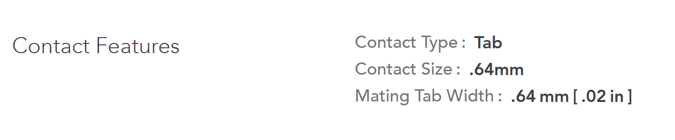

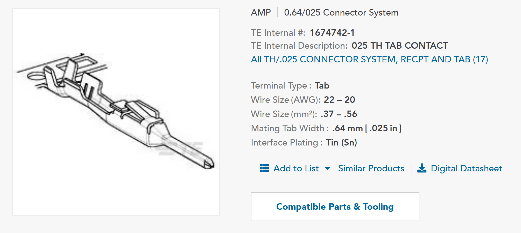

    Secondly, I was able to identify the grey connector housing model name as "4W TAB HSG CODING 2 GRAY" (Model no. 1379674-2) from TE Connectivity but am not sure what type of pin connector I need to crimp onto the wires before slotting them through this thing.
    Anyone know the specific designation for these types of connectors that would typically be sticking out of the back of OEM Tacoma switches? Based on the specifications of the TE Connectors, I planned on purchasing a compatible pin connector manufactured by TE themselves but was wondering if it followed some universal standard or if these were proprietary connections.

    Second, the terminals you are looking for are TH 025 series.
    https://www.mouser.com/ProductDetail/TE-Connectivity-AMP/1924968-3?qs=7xchs0wNA%2F1W2teqBCzKkg%3D%3D
    You’ll need a pretty small open barrel type crimper for them. If you know what wire lengths you are looking for, hit me up and I can probably make it up for you. I can even make amp AMP superseal (like is on the Meso switch now) to a TE Connectivity TH 025 adapter for you.
