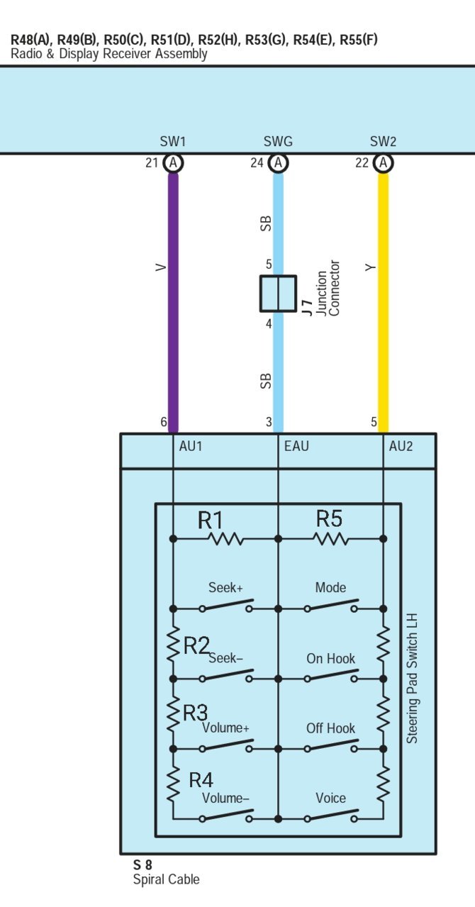

    I'm a Millionaire! One Million Posts!!
    The HU really only has a single input that receives input from the steering wheel controls. The steering wheel control provides a different resistance value to the HU depend8ng on which button is pressed. The HU reads that resistance value and performs the associated function. The ONLY way to do what you are asking would be to program the HU to read additional values, and incorporate addition buttons into the steering controls to send additional resistance values..
