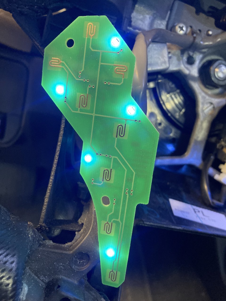

    Installed mine today. 15 minutes. Just checked and I have the same lighting issue with the upper speaker not showing. Seems to be a common production issue @Travis@Meso .

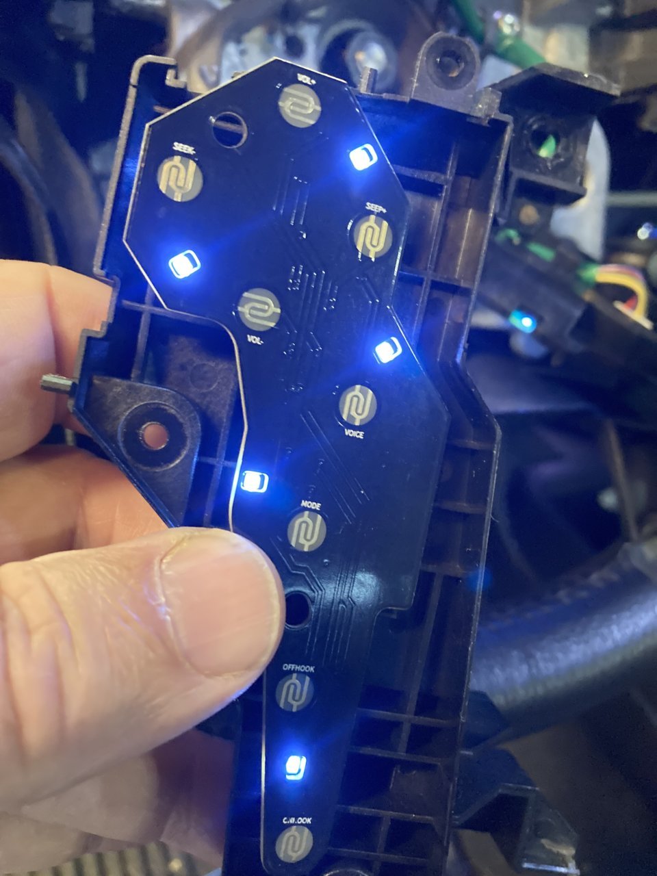

    The MESO lights look to be in the same location and intensity as OEM. Must have something to do with the dome not letting the photons go the way we want.

    Im curious because i just helped with another friend with a different product for his taco with the same problem. Does anyone have a picture of a shot of the back of the buttons both aftermarket and stock? From what i've read so far in this thread, it seems to be less of a problem with led placement and more of a problem of light redirection. Might be able to solve very easily with some precise placement of some kind of reflection material, like aluminum tape. But I'd really need to see the back and how the divisions for keeping the light inside and from leaking sit.
    Edit: i did see now that the leds on the meso board seem to be a lot more recessed behind the board. that might also have a major effect on light redirection.

    So last night I dug into it a bit and concluded that the problem is the design by Toyota not MESO. The light has to travel up to the switch cover through a thin black canyon and then bend at an angle to illuminate the symbol. I reinstalled the OEM board and the light looked identical to the new one, probably why I never noticed that they were supposed to be illuminated. I’m not an expert but it seems to me that the solution is to add a light pipe or a new led at twice the intensity.

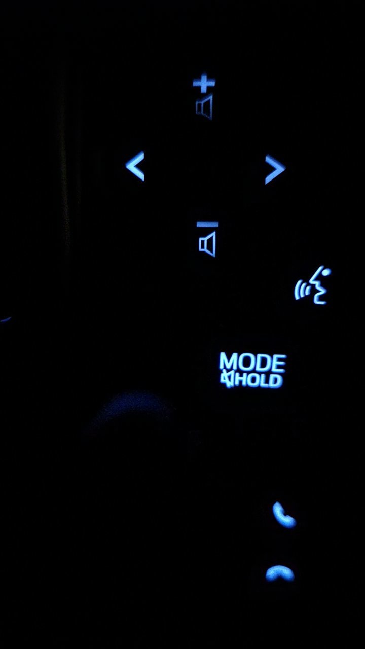

    Checked mine last night and i also have the issue of the light not fully shining through20230919_221607.jpg

    I hadn't paid a lot of attention to the backlight on the OE volume control button before. Turned on the headlights and turned off the lights in the garage last night and it's all fairly dim. Not nearly as bright as some of the other controls. So per @Captqc, it just seems to be a design thing rather than a MESO thing. It's not a deal breaker for sure but if someone comes up with an easy "upgrade", I'm in. ;)
