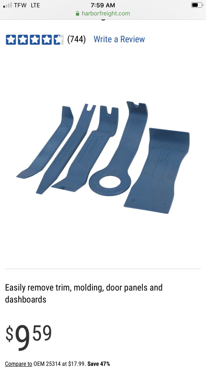

    I bought a set like this I use all the time to remove panels 1A32896D-C08F-45A8-9E08-3F7654670CB3.jpg

    Wow, that's great... thanks! I assume you used the third or fourth one (from the left) to remove the passenger side vent (given the angle on them)?

    A plastic or nylon set like above. I went around with one that has a 45 degree bend on the end and gently pried, moving around until it was out 1/4 inch and I could pull with my hands. Also helped to slip another behind where I had started so it didn’t go back when I pried the other side.

    Yeah I pretty much use the middle one for most things. They have sets identical to this at Walmart and part stores like auto zone. I just happened to get mine at harbor freight because they were on sale for like $5 with a coupon I had at the time

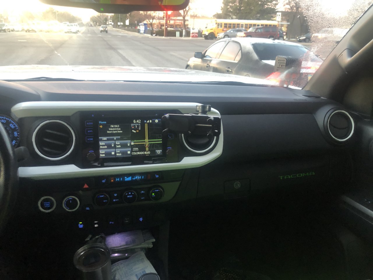

    What kind of paint did you use for the stereo bezel? Is dirt/dust very noticeable on it?

    It was just the Krylon spray paint the dirt stands out because the white lol
