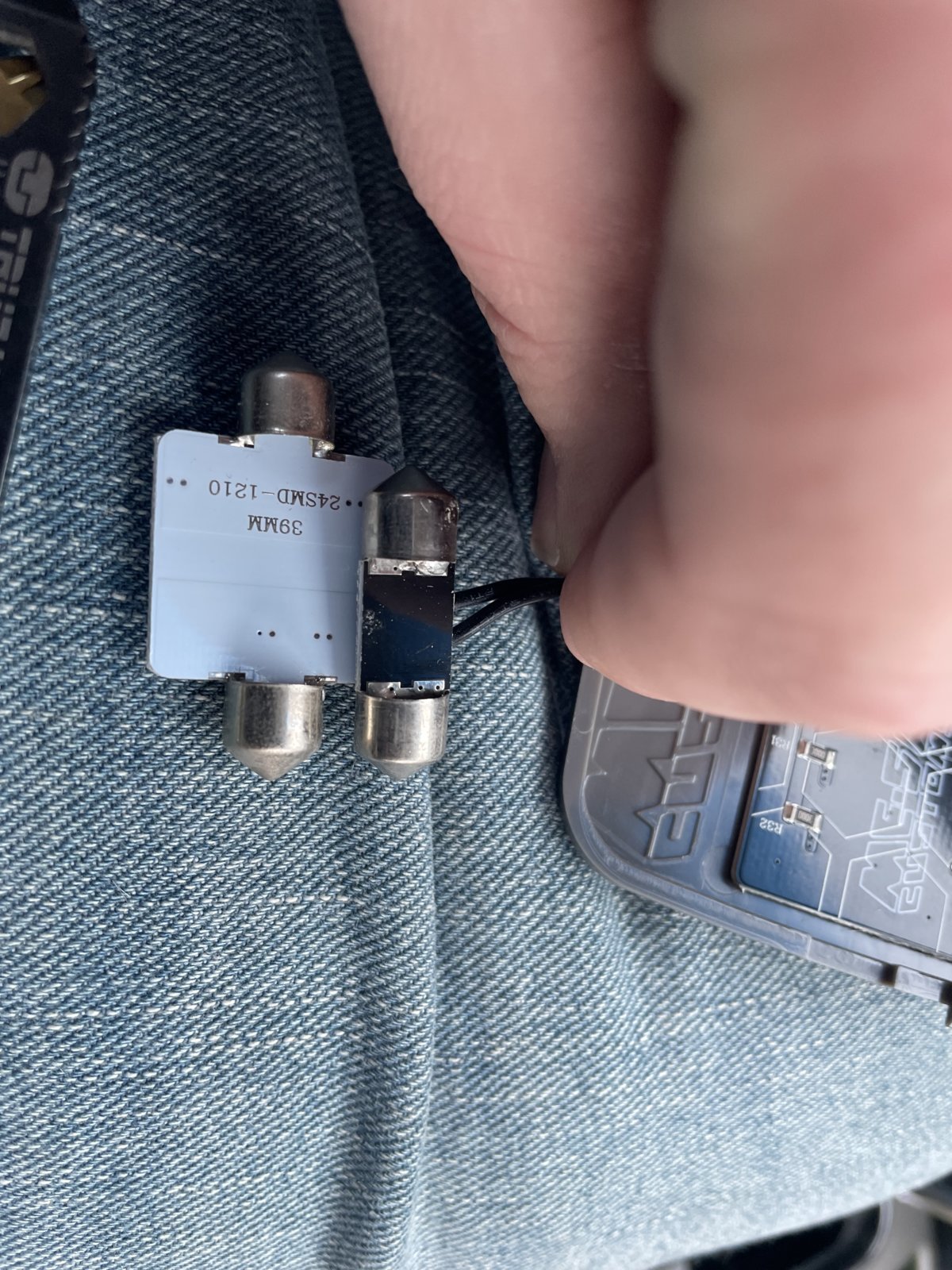

    Just received my dome lights from MESO and was going to put them in on my lunch but the connection is too small. Anyone else have this issue??

    So yeah the led I removed is probably a half inch longer than the MESO. I’m thinking I can bend the tabs to hold it more securely in place I just assumed this was a tried and true plug in and play. I was assuming I got a 4 runner model by mistake or something along those lines.

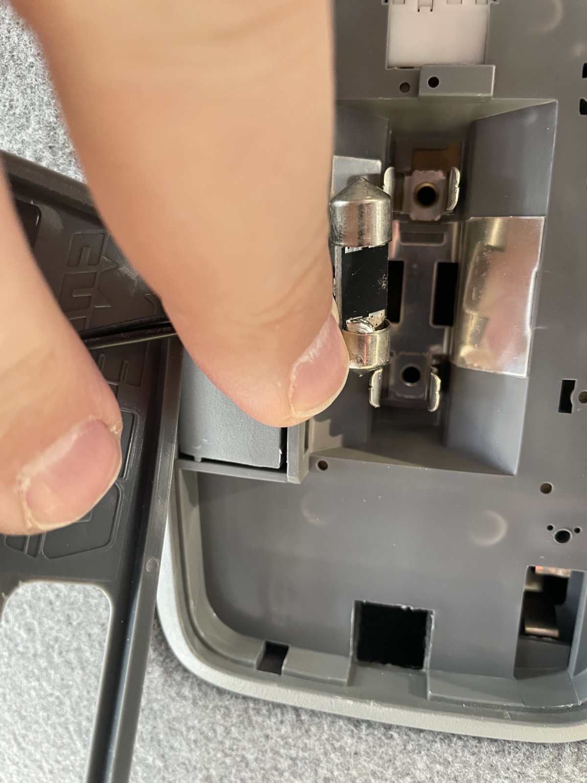

    I don't have this MESO light, but when I changed my dome light bulb to LED the bulb size in the big thread that has all the 2nd gen bulb sizes was wrong for the dome light. I think after a certain year the bulb size changed in the dome light to something smaller, just my opinion though. I ended up buying a longer bulb similar to the oem one and that fit get. The smaller bulb would not work and just fall out on my truck ('05).

    Just installed the dome light pictures. So the oem festoon bulb is 39mm I think and meso uses a “festoon” that fits both 2nd and 3rd gen and just attaches the led panel to the corresponding housing. I’m it looks short but it will fit and be held into place.

    it is definitely too small from the original and is not a “great” fit but it does seem to be holding. I just ended up pressing it deeper into the socket. So far it’s worked and has not come loose.
