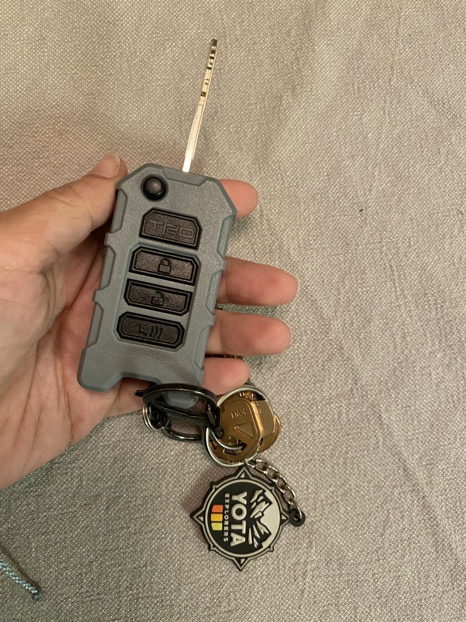

    How are these keys cut? Had a guy tell me the fob won't fit in the vice so he can't cut it.
    I just got home and had the idea to press the button and turn the blade with 90 degrees worth of the flip...
    The set screw...:facepalm:

    11
    Just purchased one and had it cut with no issues by a little old lady in a locksmith's shop. Key worked great. The only issue I had was a few days later when opening the key, it flew out of theholder and I almost lost it. Just make sure you tighten the set screw. Also sand down the button tabs before assembly as they are pretty long which makes the buttons tight and set off the panic and unlock buttons just by breathing on it.
