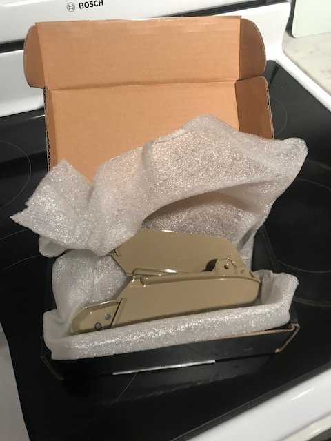

    Okay... going to install these today, and I am sure I've seen a couple of threads on the process, but for the life of me, I can't find them. That said, on Meso's page, he indicates that you have to remove the bumper to install them, but just yesterday I saw a thread with someone saying that they had installed them without removing the bumper...
    Can anyone provide a link or three to an installation thread? Much appreciated!

    Moderately more of a PIA than anticipated, but it worked. Much improved, I think!
