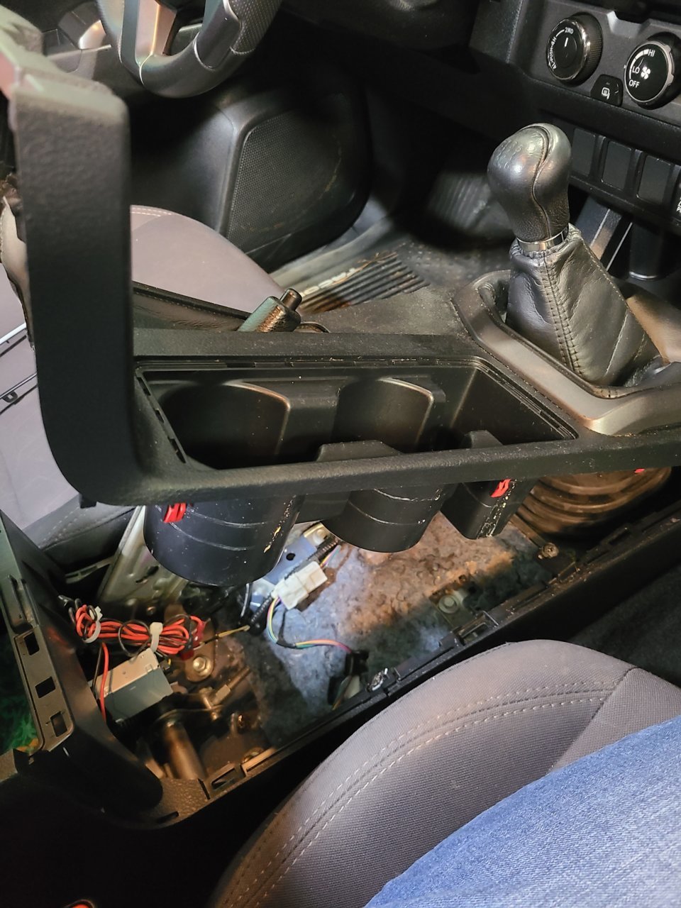

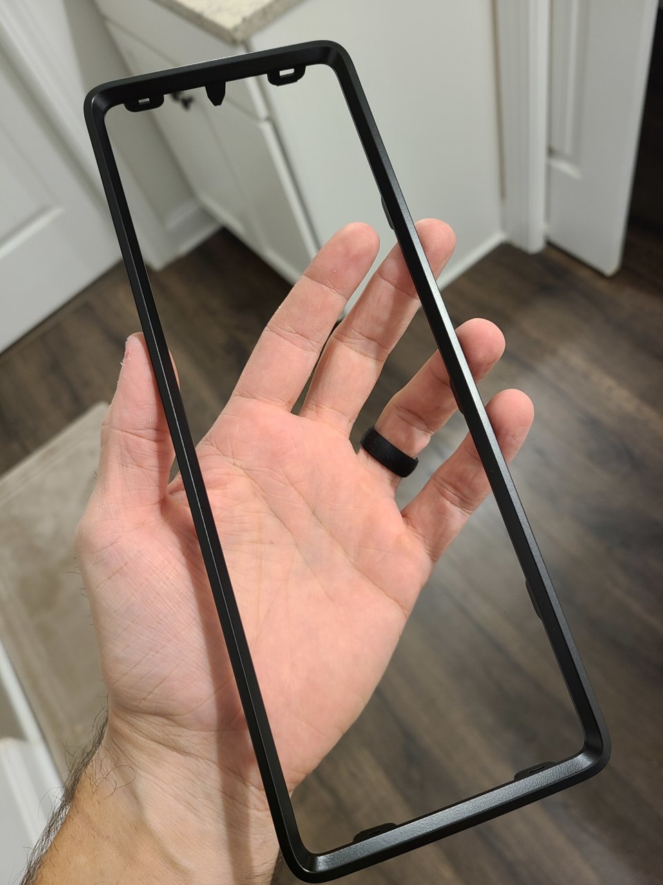

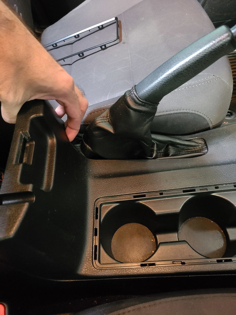

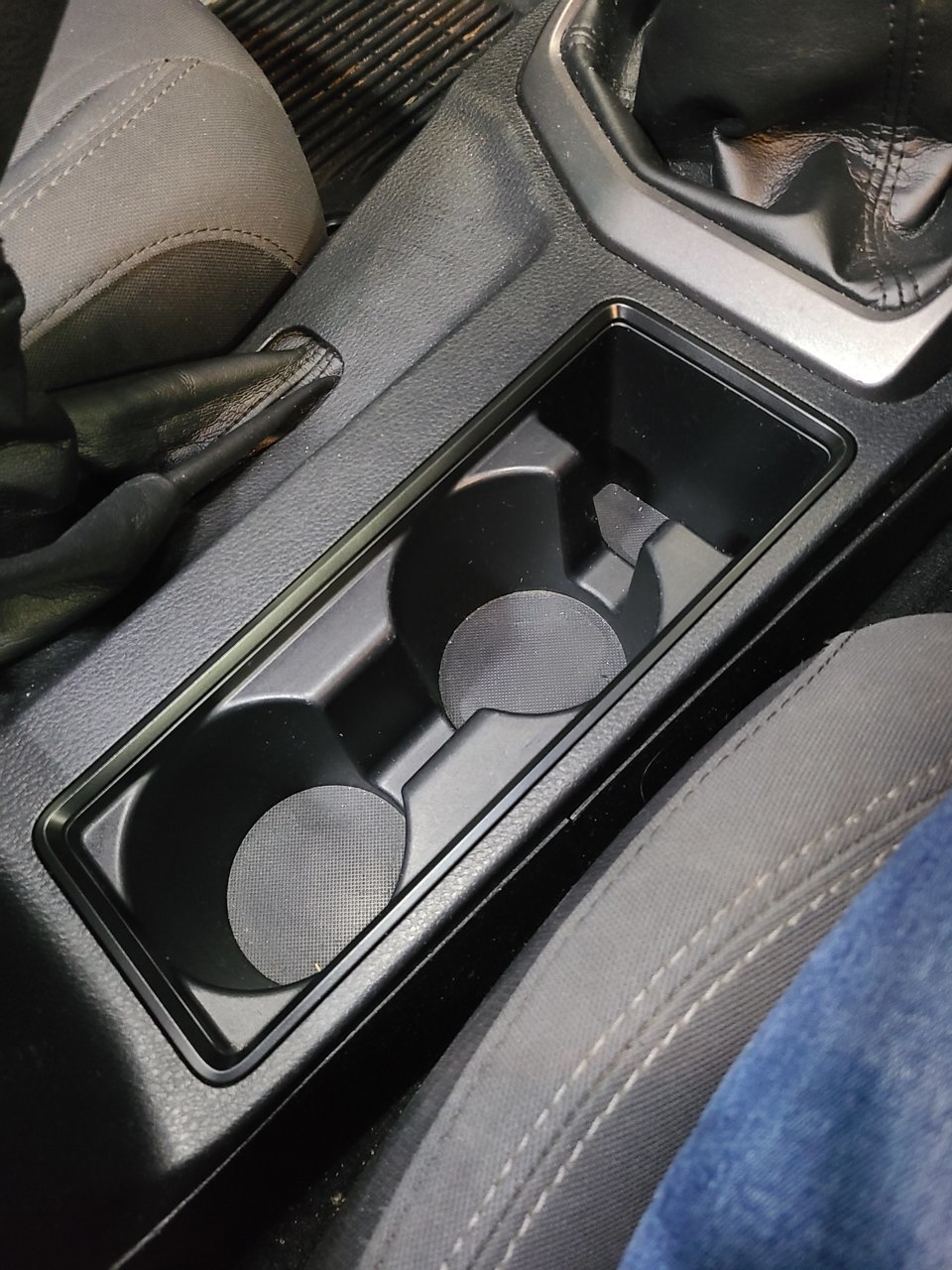

    Pull up from here. I didn't get and before pics because I tend to jump right into things but I took pics when going to reinstall it.
    Lift and push the e brake boot out of the way
    Pull these outer tabs gently toward you with your hand/ flat head screwdriver
    Finished product. I scuffed with an old sanding block.
    And installed
