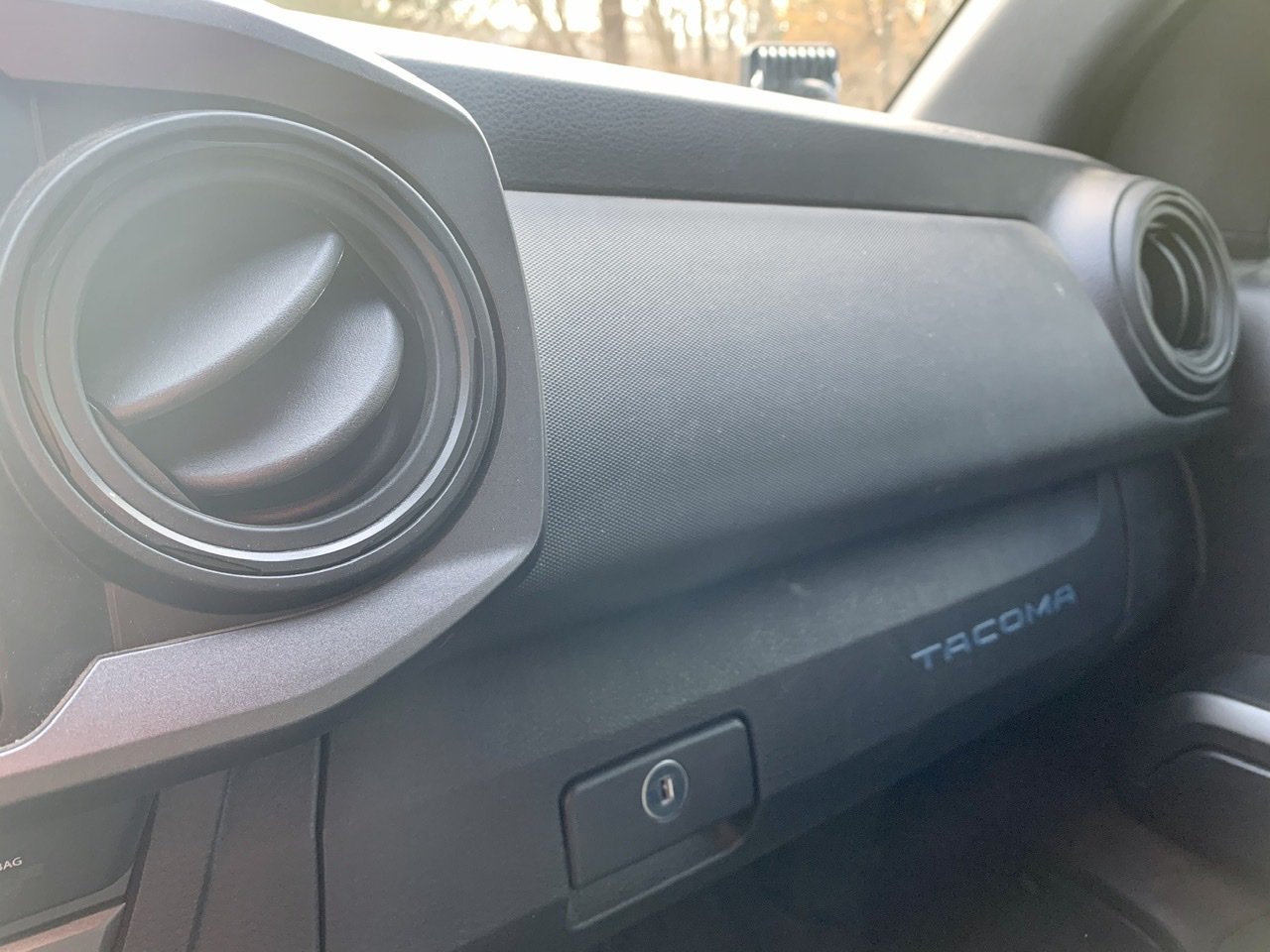

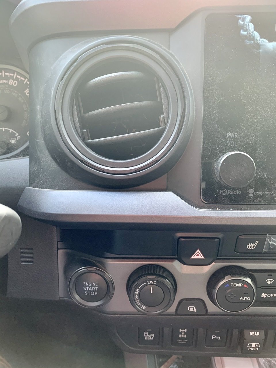

    :wave:
    A+ @MESO
    This is right. Super easy to install. I did a quick little thing on my Instagram. But, I will say where I used a pick, dykes would gave been better, you’ll understand where once you start. The chrome rings are held on with clips and some plastic the factory melted to help secure them. (Aka make them more of a pain in the ass) Make sure to keep an eye out for Meso’s video. All in all, easy mod. And looks freaking killer.

    What Color did you use the MGM or Black?

    Black.

    Black also on the lower?

    Did you take the dash apart? I think the drivers right and left side are more difficult.

    Great install. You might need to be introduced to Obsessed Garage and get yourself some rags and interior detail spray from Adams to clean off your dusty dash board! Lol

    Lol
    The truck needs to be cleaned bad. I agree. That’s dirt and dust from our last Colorado trip. It’ll get cleaned up for the start of our show circuit starting in February.

    Yep. Black on black.

    Yep! Easy peasy. You just pull the the surround off from the radio. Then the rest all snaps off. The worst part is the passenger side vent, but with a nice flat head it pops right out.

    I noticed that the rings are “melted” to the trim as mentioned above. Did you have luck with side cutters it would drilling them out be a better option?

    Use side cutters. Meso will have a video out when the product drops. Should be soon.

    Personally, if you’re going to buy side cutters for it, get some flush cut ones, (Although any will work) this way also, when you cut zip ties in the future, they cut flush and are not razor sharp
