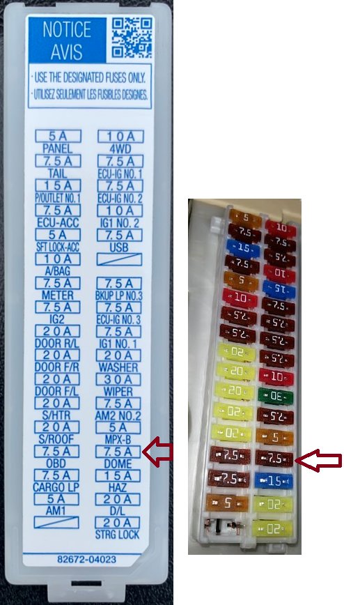

    Got it taken care of. 7.5 amp
    Fuse under the driver’s side dash. Box is just in front of the hood release and a pain in the ass to get to.

    Whats it labeled? Just incase someone else stumbles upon this.

    I think it says 7.5 DOME

    yes it’s marked dome. It’s like the (whoops!) fourth one up on the far right row (towards the passenger).

    Keep in mind that fuses don’t just blow for fun. You may want to to take a look at the backside of the light boards as well as any other exposed wiring to try and diagnose why the fuse blew.
