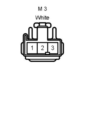

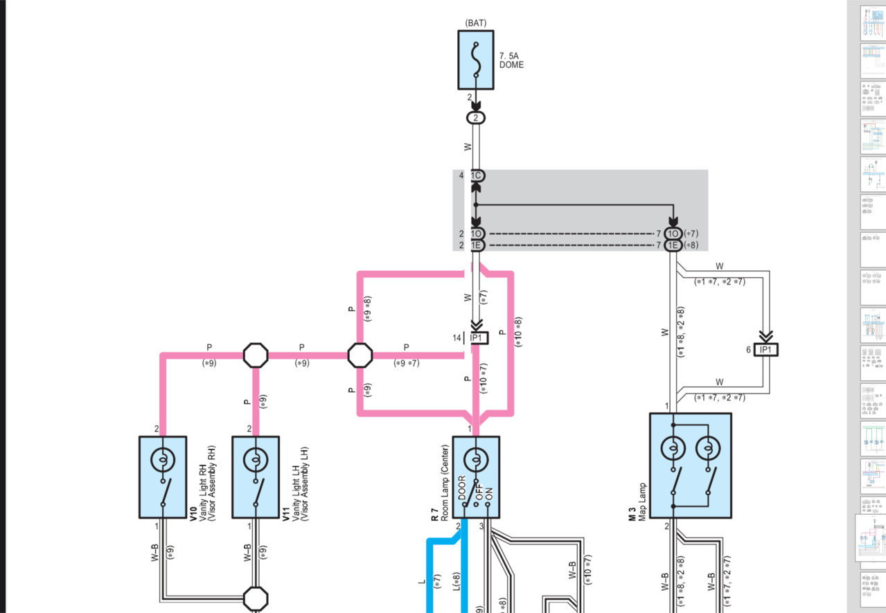

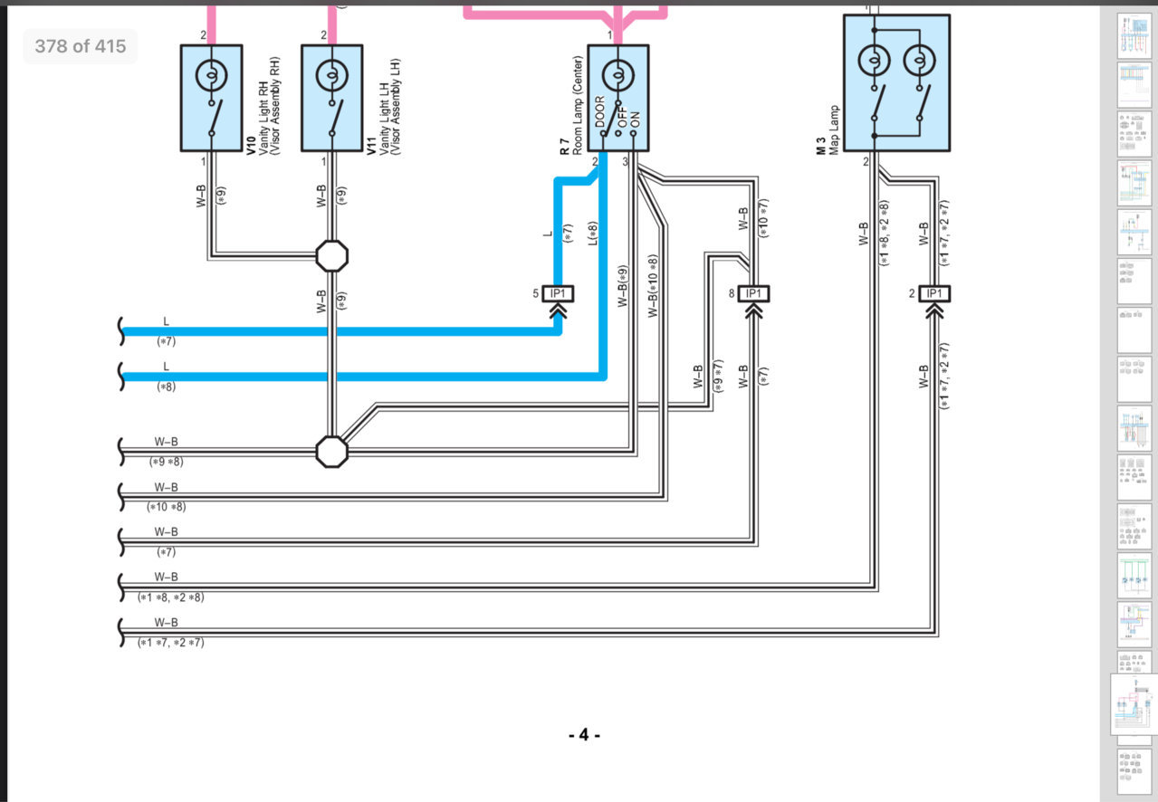

    You can check for power 12v to the white wire (Pin #1) on the Map Light plug.
    The White/Black wire (Pin #2) is Grounded by the Body ECU.
    Let’s hope this isn’t the case.
    The vanity, dome, and map lights all use an ECU ground.
    Are these the ones that don’t work?
    @Muddinfun
    @Jimmyh[/

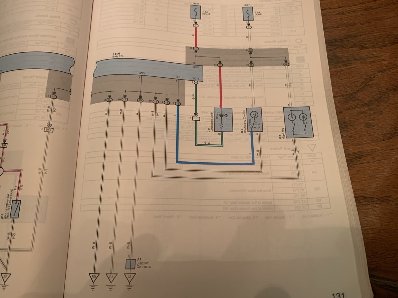

    Actually, not quite. The body ECU supplies the ground for the dome light. The white/black map light ground wire connects directly to body ground. The body ECU just happens to use the same ground connections for it’s ground. This is why the dome light fades to off, but if you leave a map light on, it will gleefully shine bright til the battery goes dead.

    So would checking the pins on the map light connector for 12v and ground be a good start?
    ovrlndkull likes this.
  17. Oct 11, 2020 at 7:28 PM
    #17
    Muddinfun
    Muddinfun Well-Known Member
    Apr 17, 2017
    #216500
    7,489
    Yes. The white wire should be battery power and the white/black wire should be ground. If you have power and ground there, then the problem has to be within the overhead console. Switch, socket, bulb.
