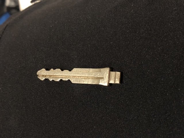

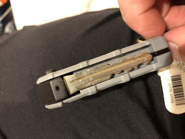

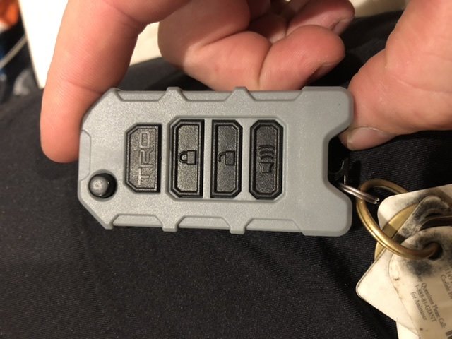

    I took matters into modifying my original key. Take your time if you go this route. I used a bench grinder and a file. I probably could have done a cleaner job with a belt sander but those are the tools I had. FYI I had a small issue with one of the 3 bolt holes wanting to cross thread when I put it all together so be mindful of that.
