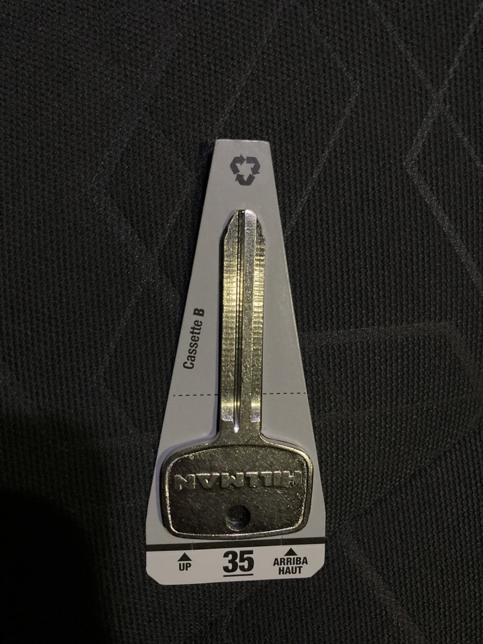

    This matches my experience exactly. I arrived a bit after 8pm on Monday with closing at 9pm. The store was near empty and I had three curious associates all pitching in to help out. I was happy to pay the $3.23 for the blank to ensure they felt that the transaction was appropriately charged and so I could use self checkout.
    Photos of the key blank below in case it helps anyone. The machine scans it and loads the cassette as Fernando mentions. The machine also prompts about a transponder and you can instruct the operator to say no to that prompt and tell them you have that part figured out.
    I extracted the shank from the flip mechanism thinking that would be necessary but, as mentioned, it would have been easier if I had left it intact based on how the machine grabs it.
    Technically, you could actually cut a flat metal key and use it for surfing / running / etc as a door / tailgate only key as well if that helps grease the wheels and get things done. The machine prompts for additional copies after making the first one.
    If you have both of your original keys, bring the one which looks less used with you so the cut is as close to the original as possible.

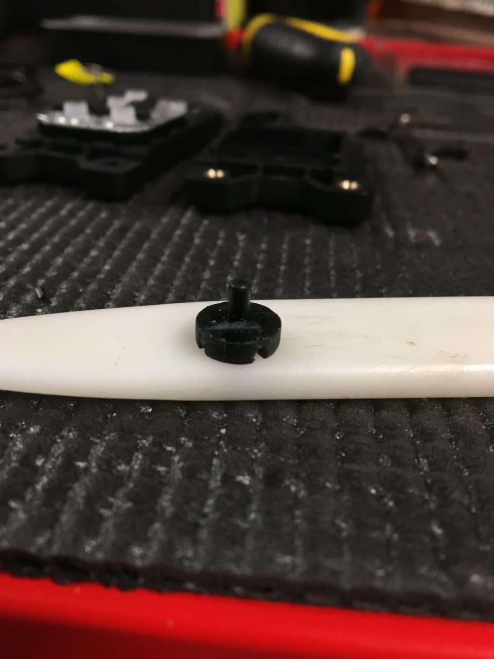

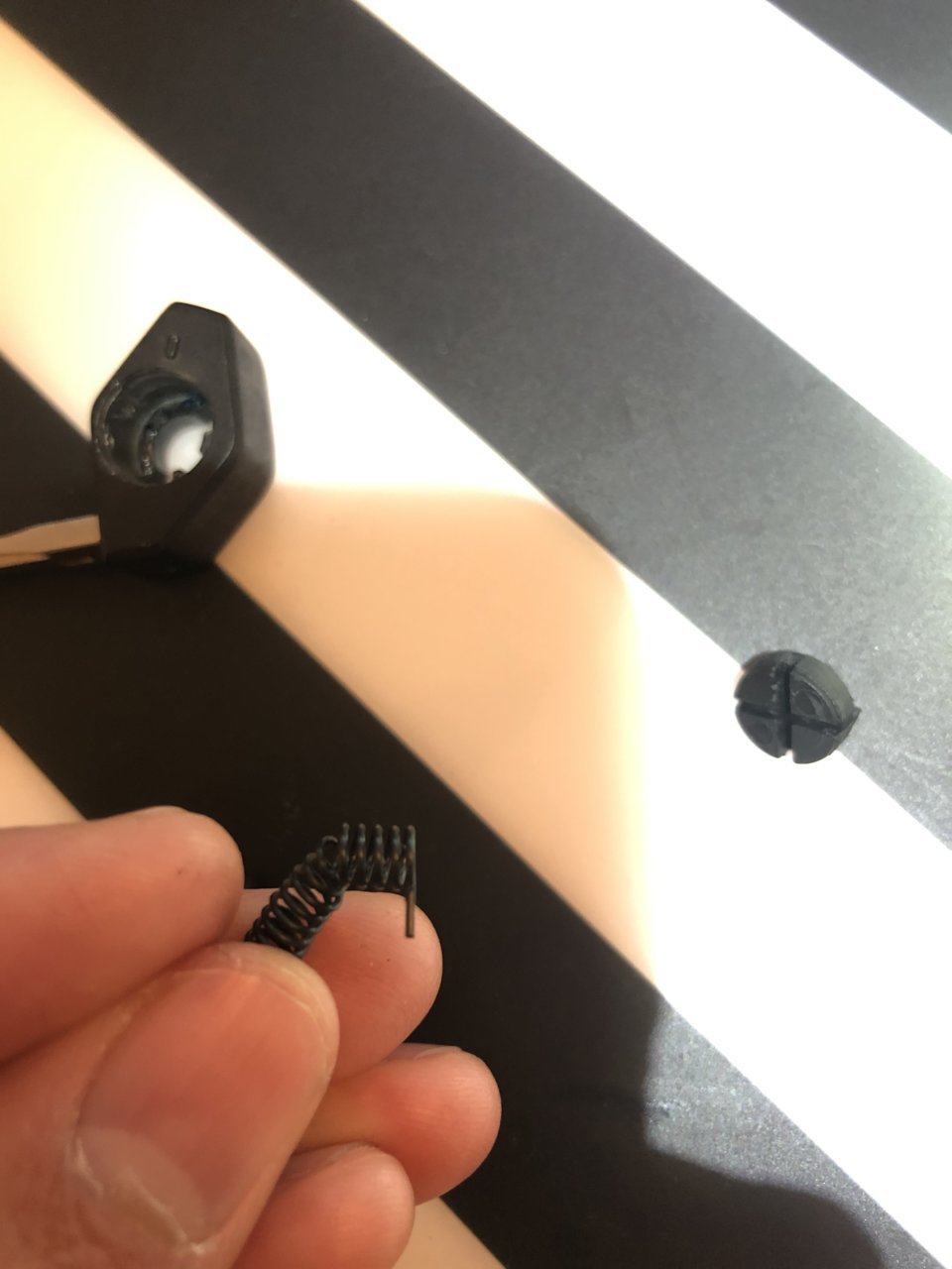

    Anyone else have problems reassembling the spring and cap? Thought I had everything good but the panic kept activating so I took it apart and filed the button but I couldn’t get the key spring to work right. The button to flip closed wouldn’t press in. Followed the video on Meso site, turned the cap counterclockwise but at some point it chipped and now I can’t get it to work at all...

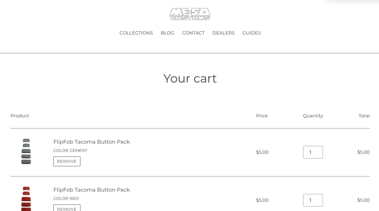

    @MESO - he snuck them in guys. Go to Collections-> Fob and Accessories > and there they are.
