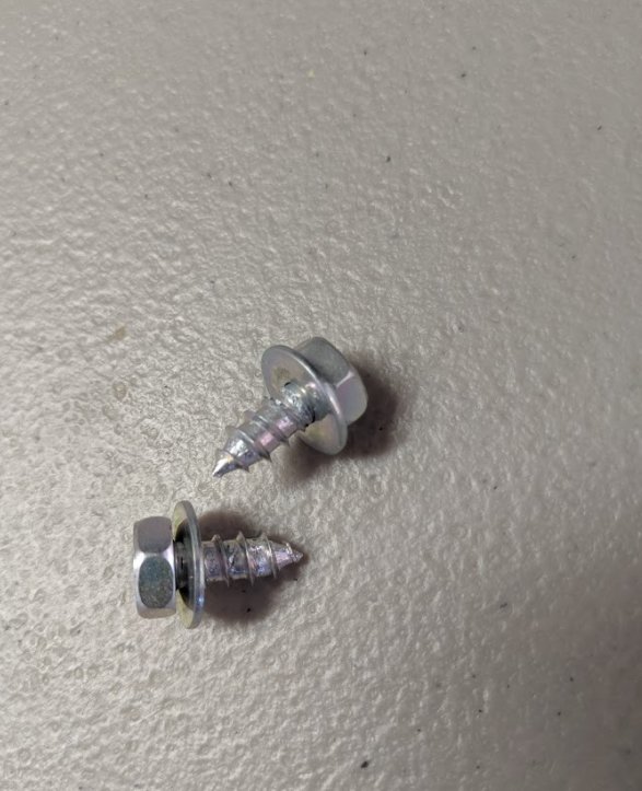

    I got everything put back together then realized I had these leftover lol... anyone know where they belong?

    Look like the speaker screws.

    Nope! I did it too haha.

    AH I think you're right. Too bad I'm not going to take the door panels back off to find out haha. Must have got the first two in then reached for my beer.

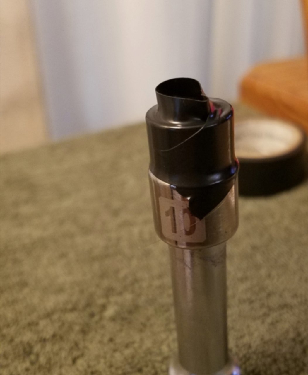

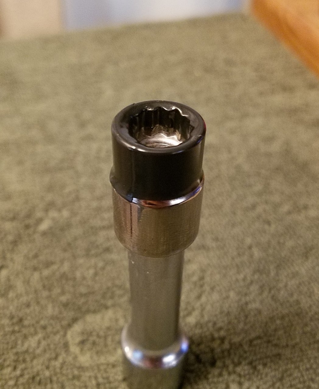

    For those who dont know this trick, I've been doing it for years on nuts or bolts that might drop into an inaccessible location.
    Wrap the socket tightly with about a 1/4 in tape past the top of the socket once. Pulling it fairly tight will make the tape want to curl over.
    Then fold the tape inside. You will have to push the socket on the nut but it wont come out until you pull it out.
    Same thing for putting the nut back on. Just press the nut into the socket. If tape starts to wear, just replace it.

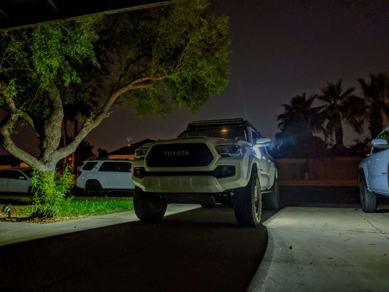

    Very happy with the results from these. My neighbors are probably wondering why I keep locking and unlocking my truck :D but they are so awesome!
