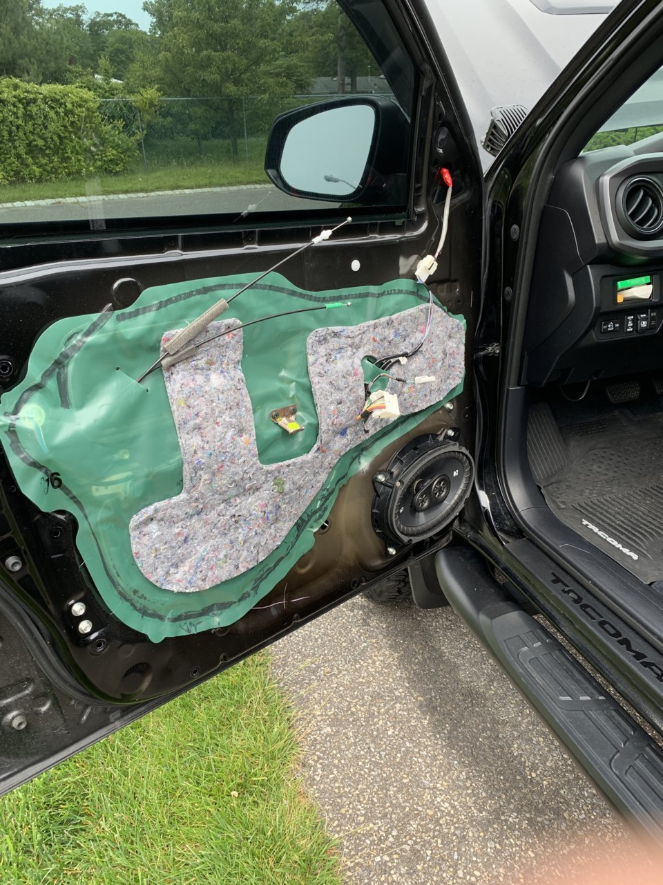

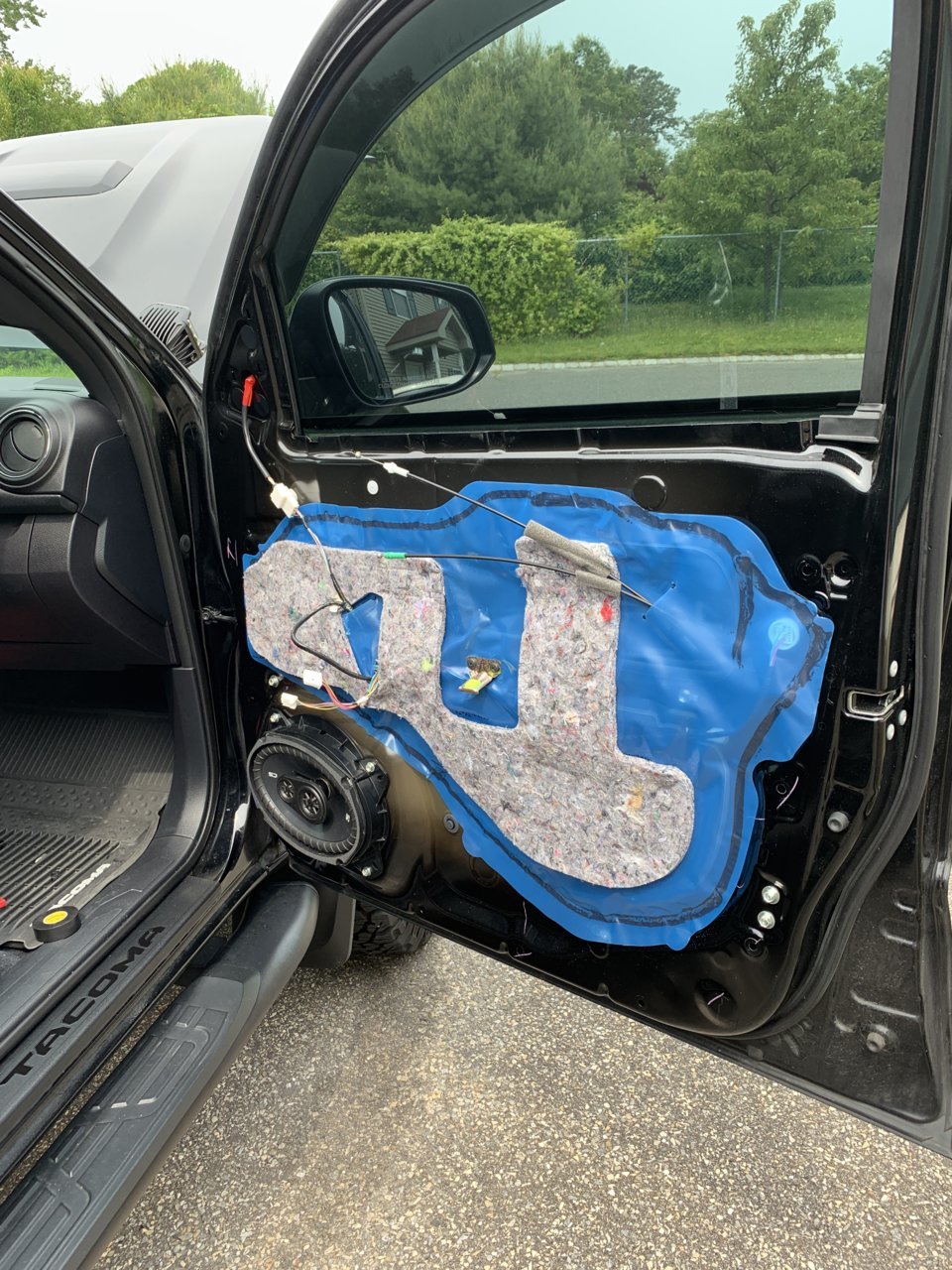

    Both doors are off, and I fixed my speaker situation. One of the wires from the magnet to the connector was vibrating, touching ever so slightly. Yahoo, no more of that annoyance! Moving on to the hard parts! No broken clips or lost clips at that! Lucky! Yeah I think I mounted the speakers upside down but with the bracket kit from crutchfield I had to install that way to line up with the screw points.

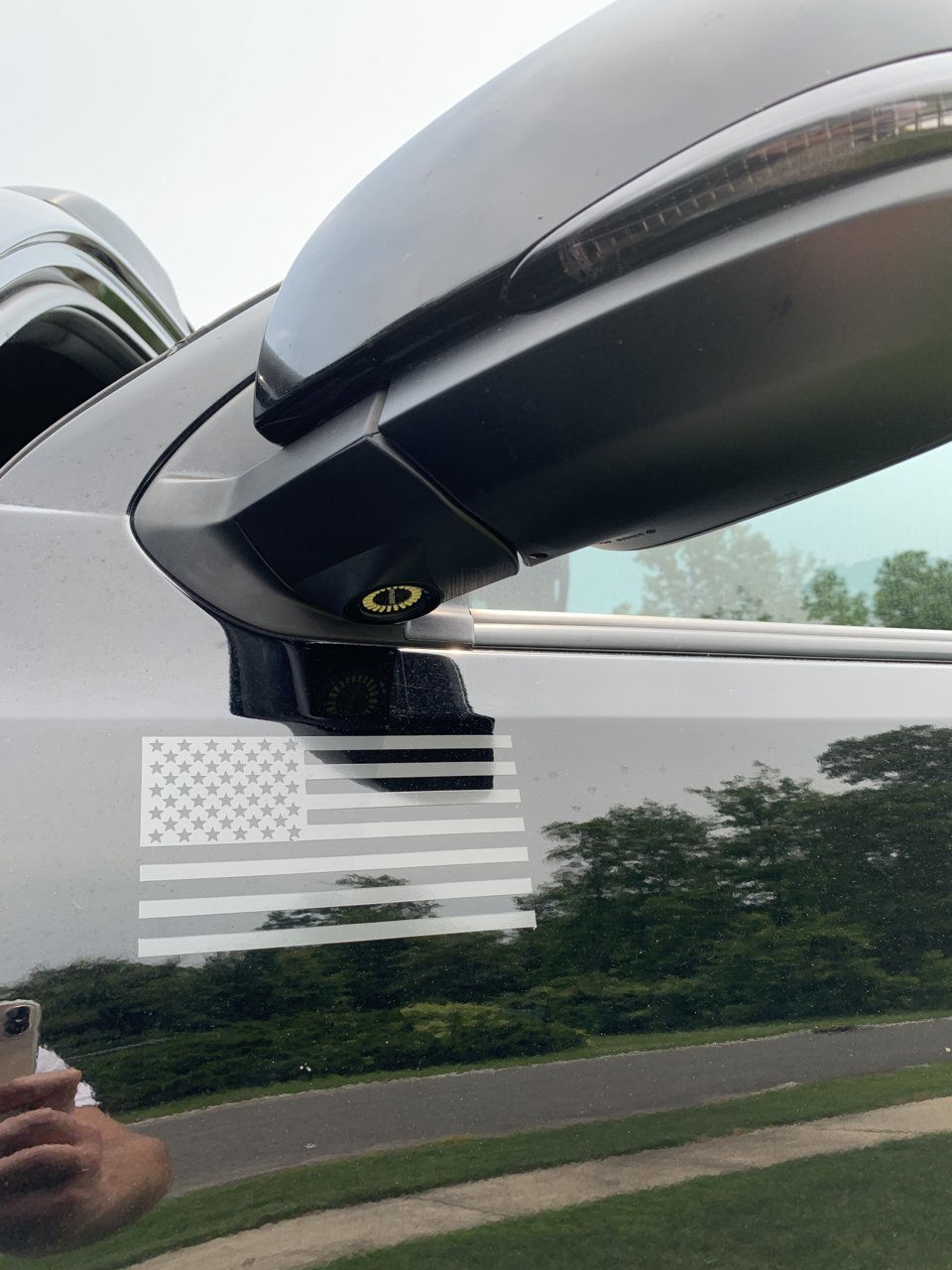

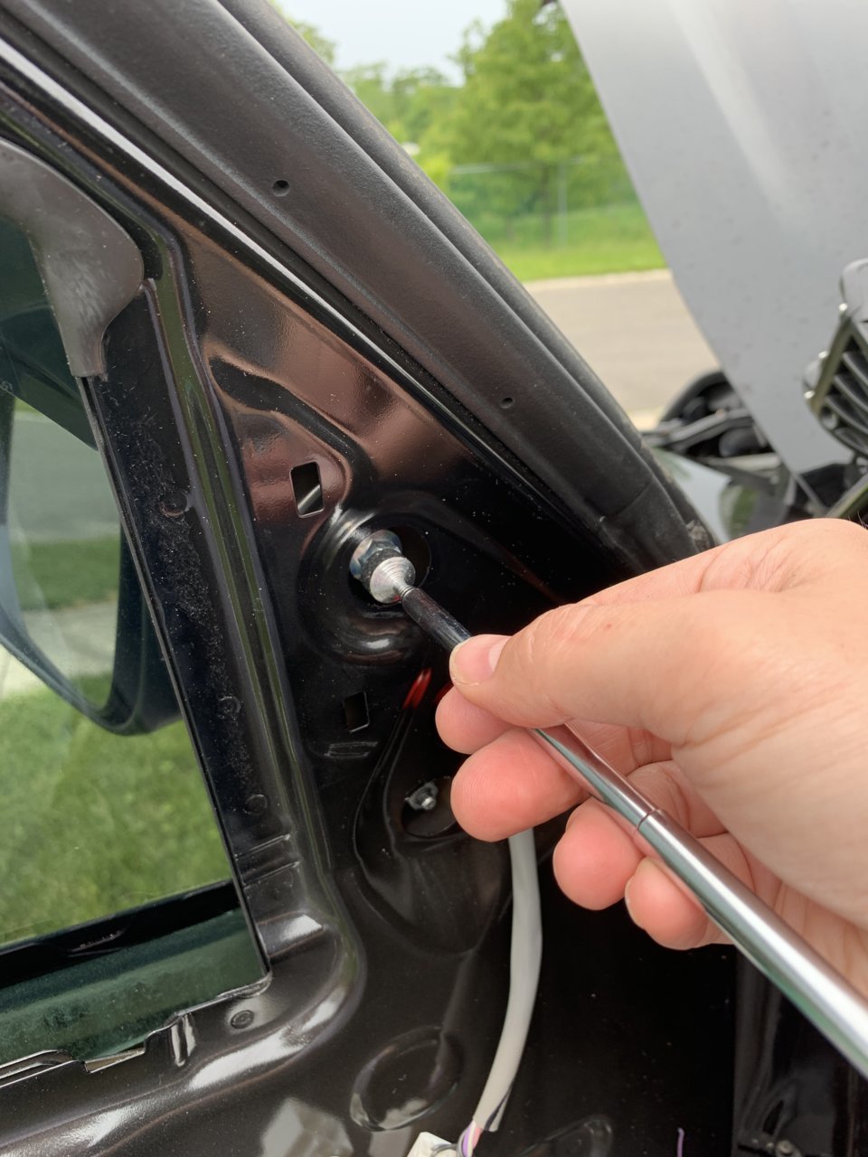

    Well got the mirrors back on with the puddles installed. I have a ‘17 and I did have to dremel that spot on passenger side. Also had a little tip if anyone has a magnet tool to help prevent “nut drops” :D. Now on to the fun wiring. Wish me luck boy hope it goes smooth. Its nice not to be in a rush installing these. Got to take little breaks inside to eat and such.
    For magnet trick, loosen them almost all the way and use the magnet and hand turn them off holding the magnet tool. Just make sure you have a good strength magnet. That’s how I did all mine without dropping. It can happen very easily in their location.
