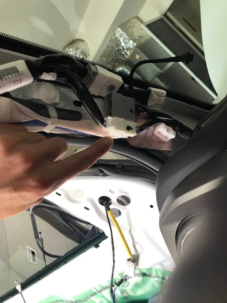

    Hey guys,
    In the middle of installing mine now... does anyone else have the plug where my finger is pointing at? It comes off the stock harness. Because of this plug, I can't get the wires to tuck in to reinstall my A pillar cover. I have a 2019 Offroad 4x4. Thanks

    @Justin_Exploring is that the same harness you were referring too?!

    Yeah that’s what I was referring to in my last post. I removed that bracket and cut it so the harness’ could move independently. Gives you the wiggle room to position everything, just make sure nothing is blocking the airbag.

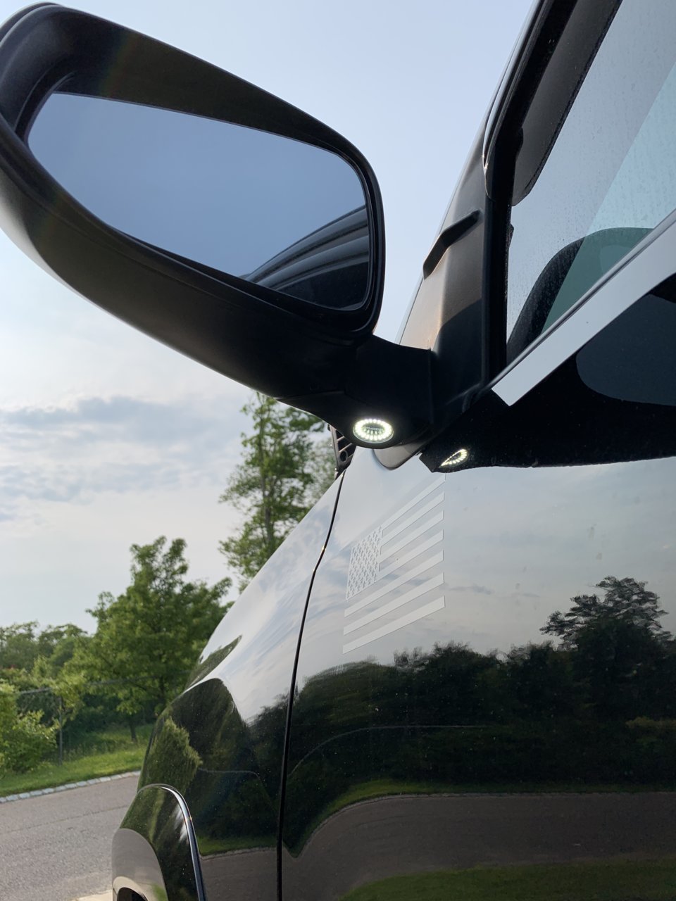

    I redid the angle on the lettering to my liking for the VLED today.

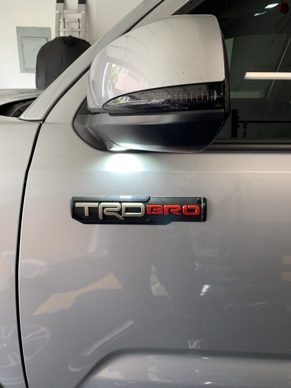

    Annnnd, done! Took a bit because I was running speaker wire while I had the pillar apart. Boot was easy with long needle nose pliers and pulling both sides.
    Overall, super happy with the result. Bad ass! A few @MESO mods in this shot :)
