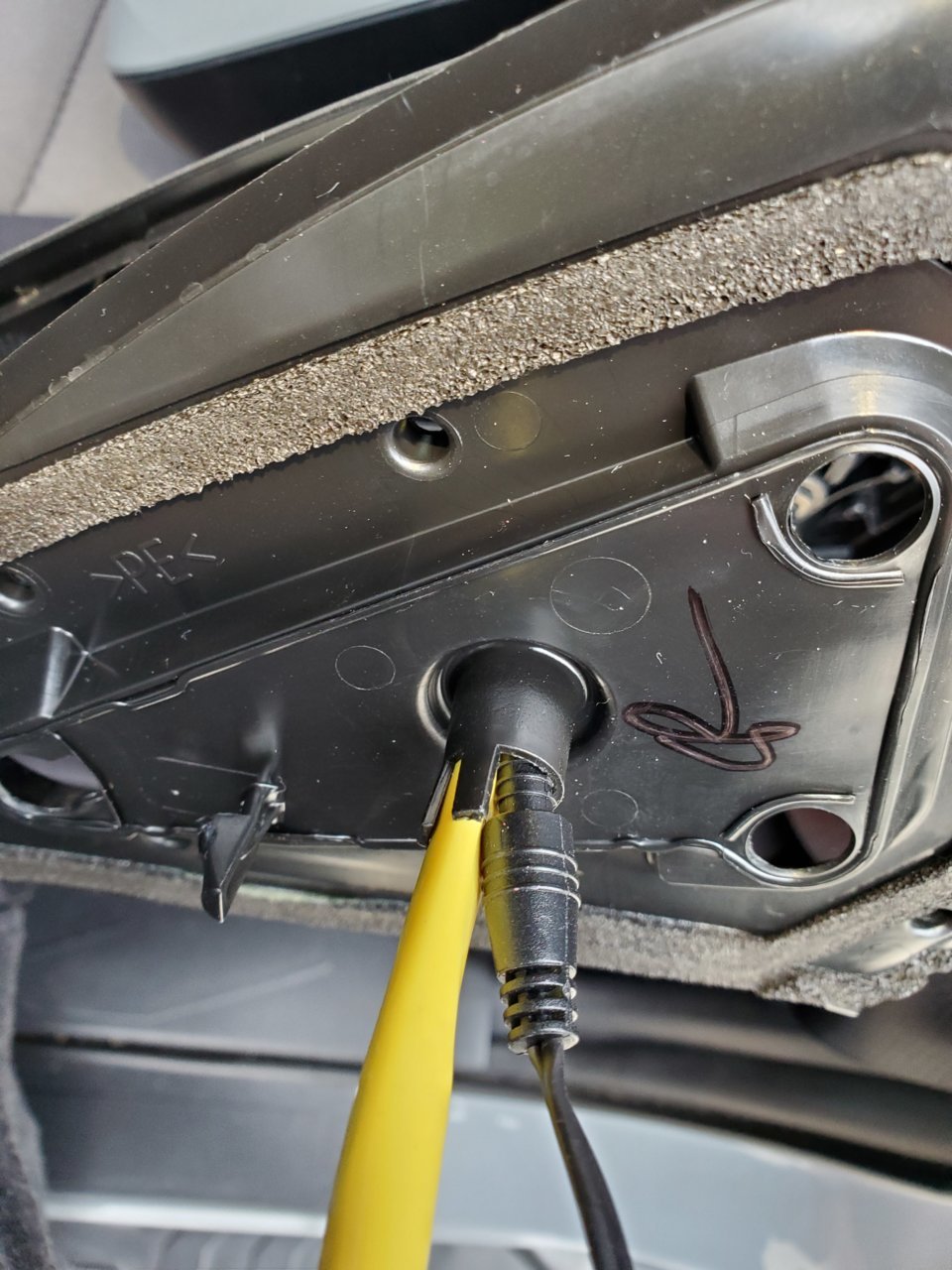

    Are we supposed to fish the connector thru this hole? I can't figure out how you guys did it....

    Do not do that! Lol it will go through. Flatten out the existing wire there with your fingers, and pull it through while holding those flappy tabs up, they will go through

    Just got it, thanks man!!

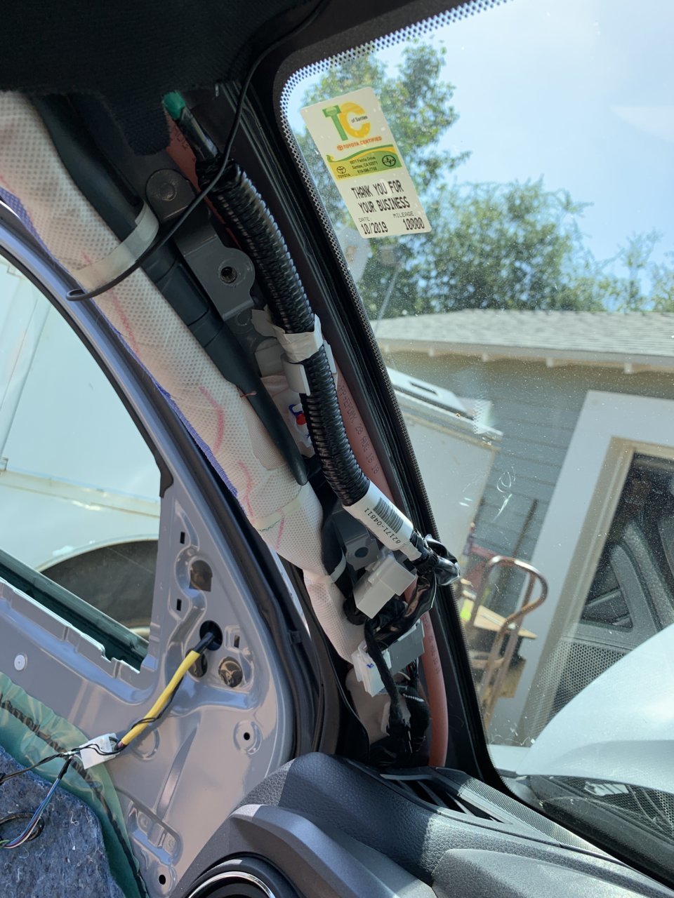

    Just finished installing and testing, all works just fiddling trying to get the a pillar back on flush since there are so many cables now.

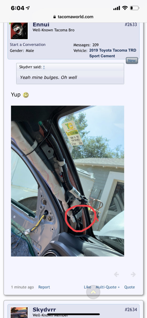

    Yeah mine bulges. Oh well

    Yup :)

    Dude is that your dash cam wire? Scary stuff.

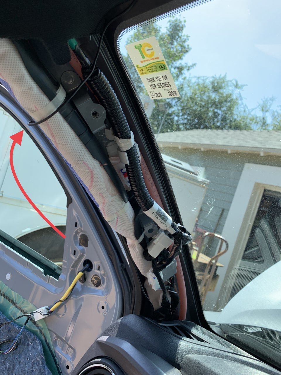

    I disconnected this from the sheet metal and slid it lower down to allow me to have more space. DC3A3F77-EF94-41D3-BF2B-221BB59D2D27.jpg

    Believe it or not, in that pic it is already disconnected (just wasn't tucked down yet) :)
