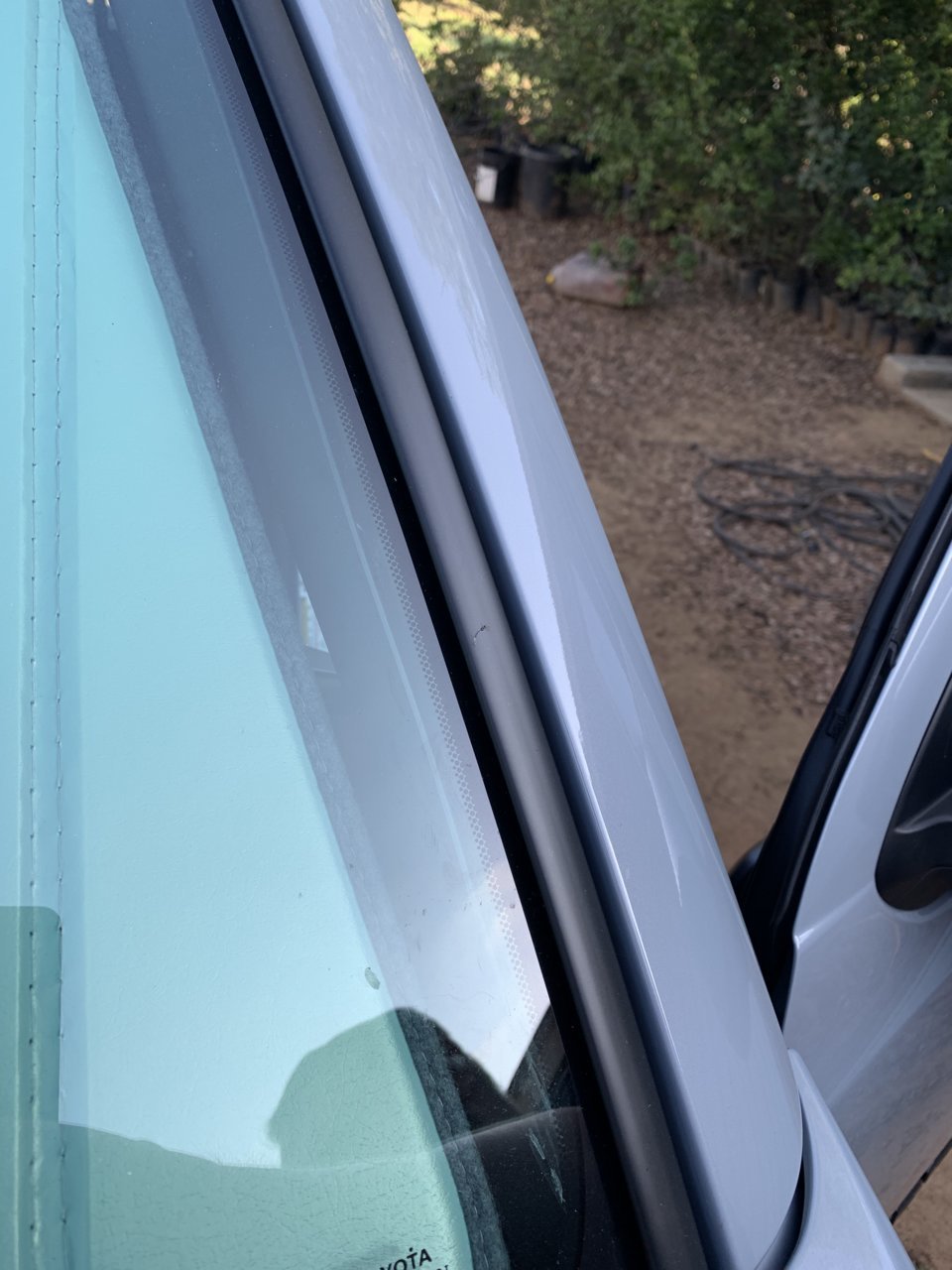

    I have a OEM moonroof, I got it to a satisfactory point (not perfect) but only by a; harness clip detached (which you already did) and b; against my gut feeling, I did slightly pull some cables down and push others up to "spread apart" all the cables and spread out that thickness some. It's really just the extra harness that causes it to get "phat" in the center.
    Also, this may sound weird but after the a pillar trim is back on I did squeeze and push up and down the end piece closest to the window to help mold a tighter fit, as well as up and down the front end where the weather strip is help is conform more snug.
    I don't have a pic at the moment from the inside but I did include one from the outside I took the day after I completed my install. I believe you will see it "not perfect" but good enough to the point that nothing is visible or aesthetically detracting, unless you purposely are looking for it :)
