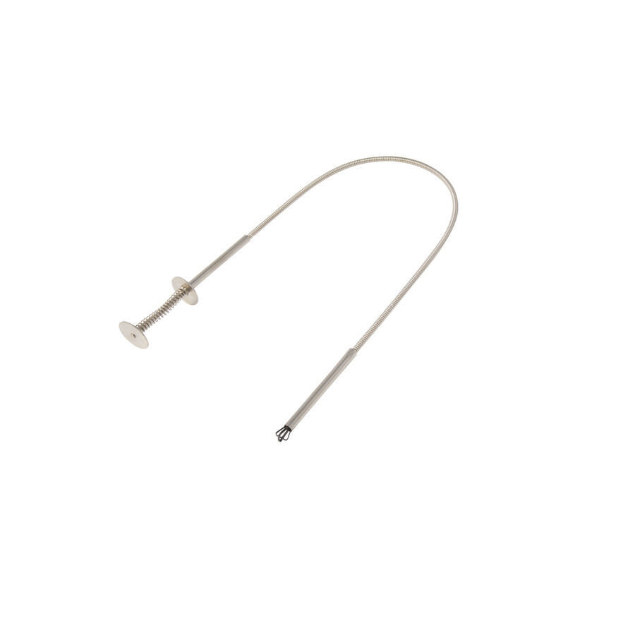

    Just finished installing mine. Pretty easy and straight forward, took about an hour and a half, and thats with me routing the harness like OEM. Little bit of advice, purchase a mechanics claw like the one pictured below, and there will be no need to cut the plastic door shroud or remove the panel under the steering wheel.

    Someone else mentioned just pull out the door speaker?

    You don’t have to remove the speaker. Just pull back the plastic sheeting and stick it back.

    I did that as well so I can run the puddle light harness with the OEM harness and zip tie it.
    From years of tinkering and fixing up cars, I've never been a fan of removing the plastic door shroud, never goes back the same way, and the adhesive just gets messy.

    The vapor barrier "glue" sucks in the heat. I wouldn't have pulled it if I wasn't doing sound dampening. Pulling the speaker is a much simpler solution, (which is why I recommended it).

    I second this. Had ZERO issue removing speaker, definitely recommended.
