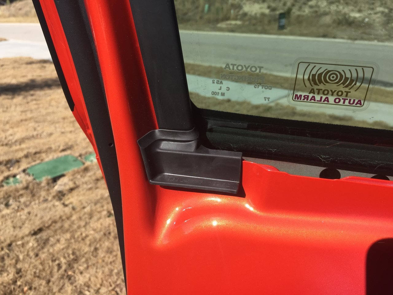

    So I think the rest is pretty manageable. But my one question if anyone can help me out is how to put the window drains back in and how the orientation goes. Sorry for being a noob.

    It goes back in that corner rear side of the window seal.
    It slides on in the corner right above where you have it.

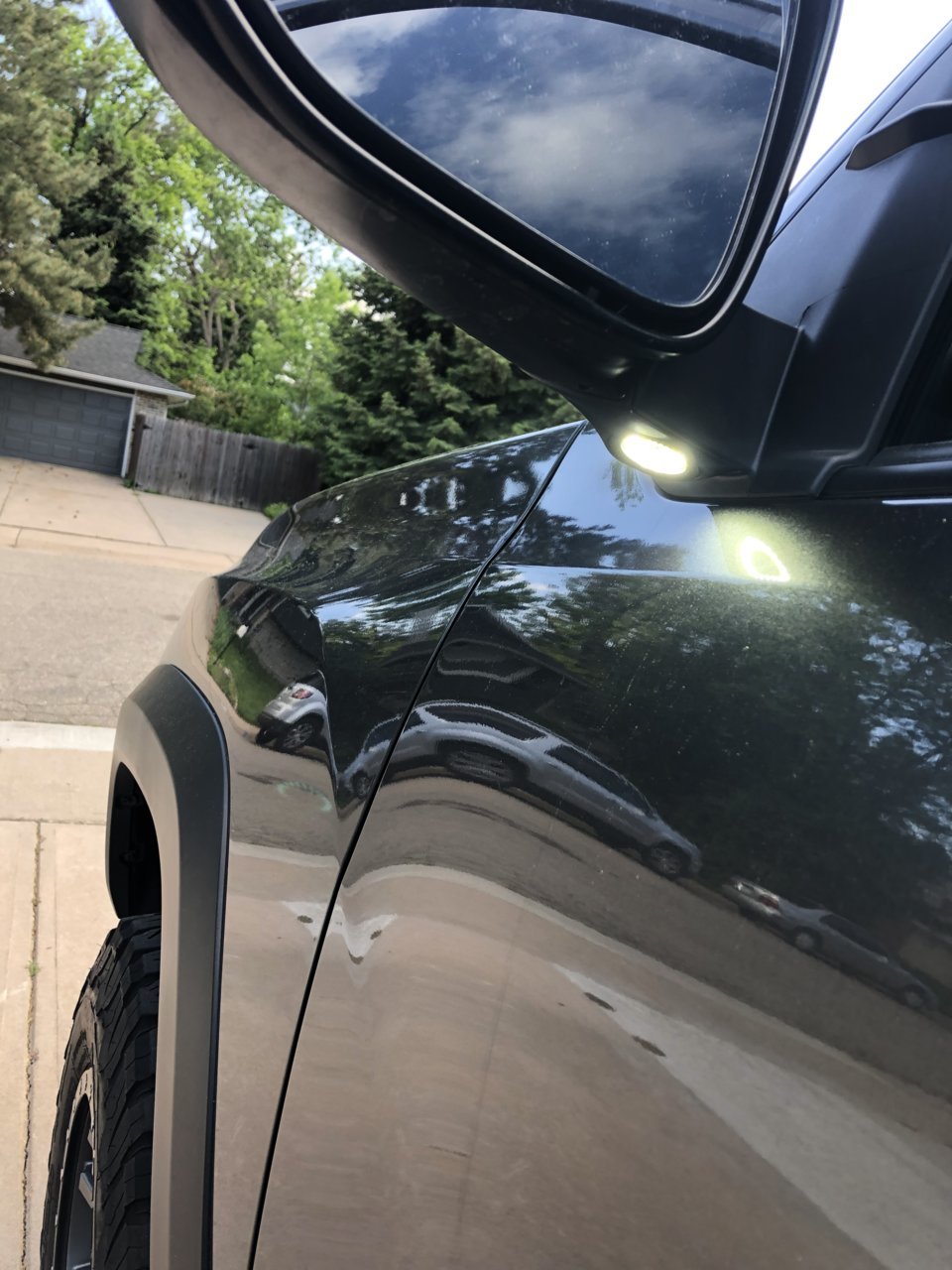

    I bought a set from someone local yesterday just finished installing them .

    Just in case you still need the info or a visual is needed. :)

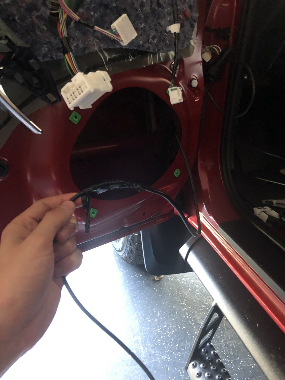

    Im stuck on the boot, just cant get the canle through :(

    If you weren't so far away I could help, but Texas to SoCal might take a tad bit longer than you'd want to get it done. :rofl:
    Best that worked for me was to take both sides of the boot out and scrunch it up as much as I could so there was less space for the wire to have to travel.

    May try that next. I have thick sprinkler system wire that ima run through first, then attach the cable to it and pull it back through.

    So the cable pull through method with a little soapy water took a hole 10 seconds...
