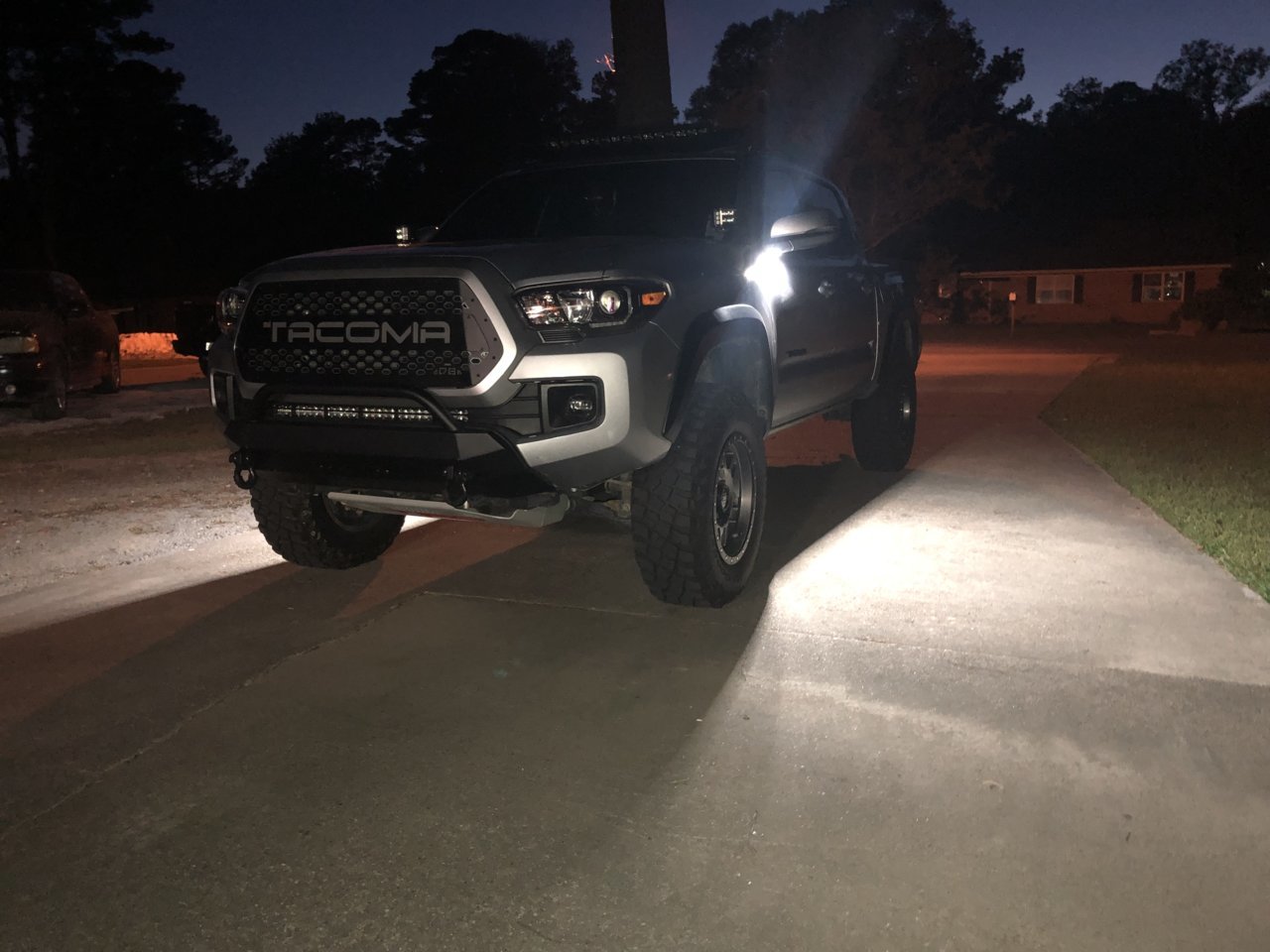

    Blinded by the Light. Such an awesome product.

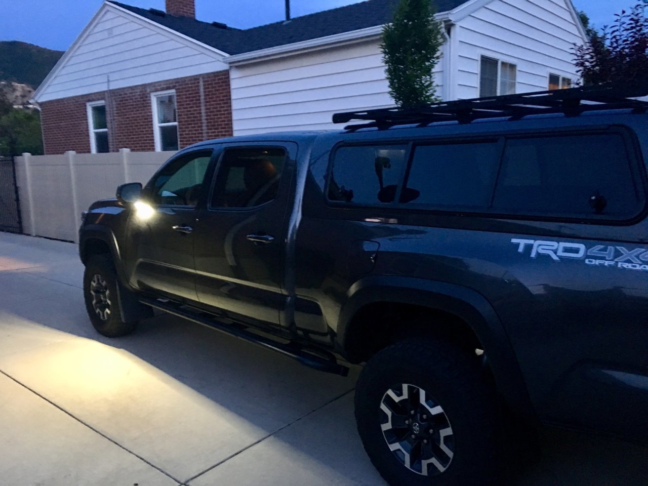

    Finally got mine installed today. Was part of the first batch but then ordered the Kicker speakers, Noice sound damping, Subaru tweeters, etc... and just got to it today. Install went smooth per the instructions and this thread. Navigated the boot easily with a large zip tie, electrical tape, and dishwasher liquid. When I disconnected the cables at the kick panel, I completely pulled them out so I had the entire assembly out for threading the new wires. Had to push all the connectors back through the hole in the kick panel but that was easy. Overall, easy peasy, well done @MESO ...I had plenty of wire length and everything went super smooth, got everything tucked up nice and clean.
    Also, for the connectors in the driver A-pillar, I moved one of the small plastic clips from the factory connector to Meso’s, clipped it in the same spot and then pulled the slack and old connectors down towards the kick panel. No bulge or other issues this way. I don’t have a sunroof though. No pics on install process because I was in get shit done mode...
    Hardest part was the damn Noice sound damping in the doors for me. Still need to do the speakers in the back doors, but that will wait for another day. Been walking by my truck every 20 min just to watch it light up... STOKED!
