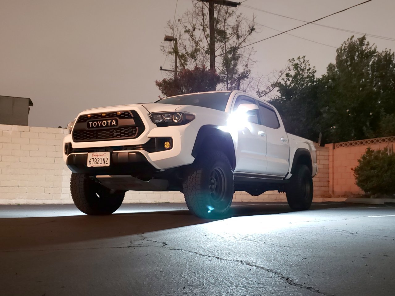

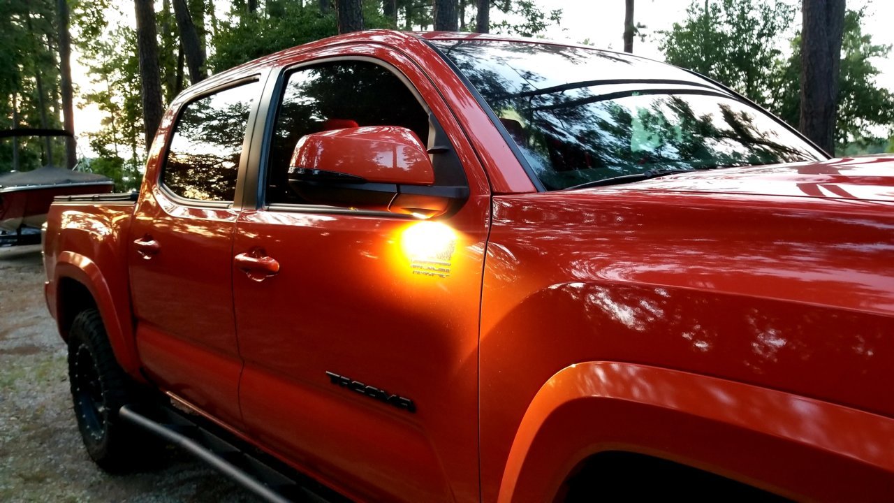

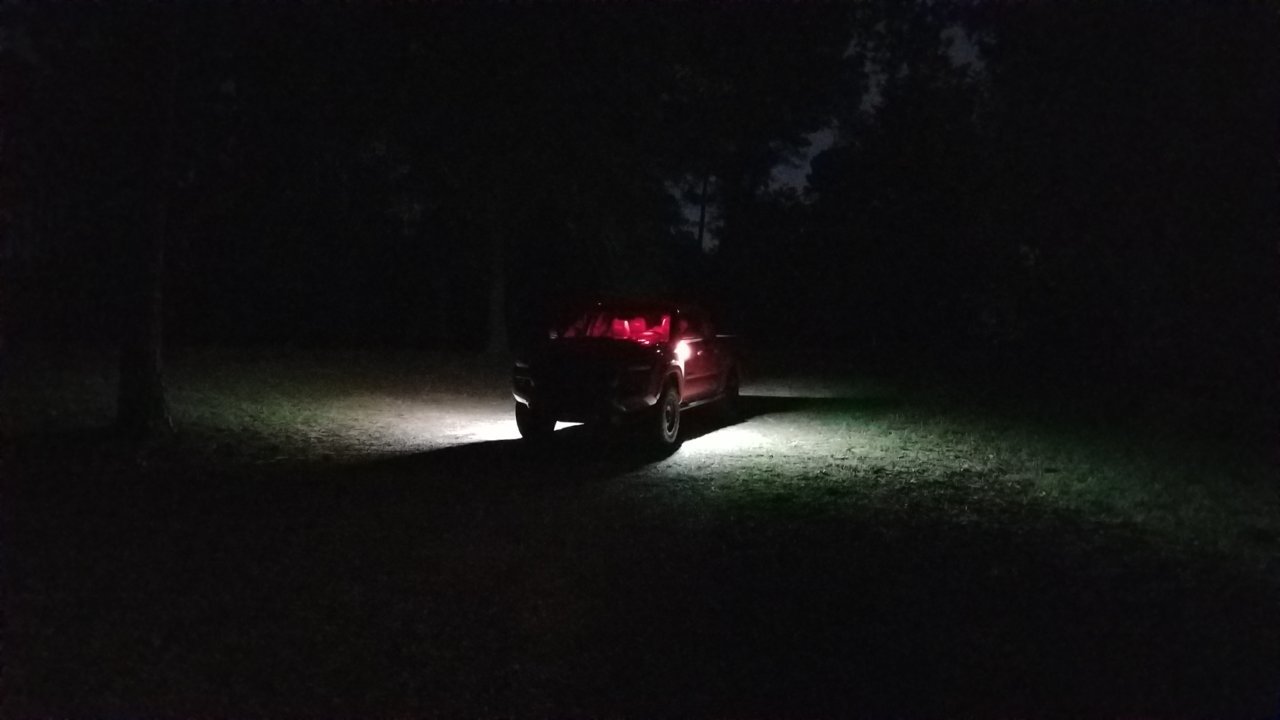

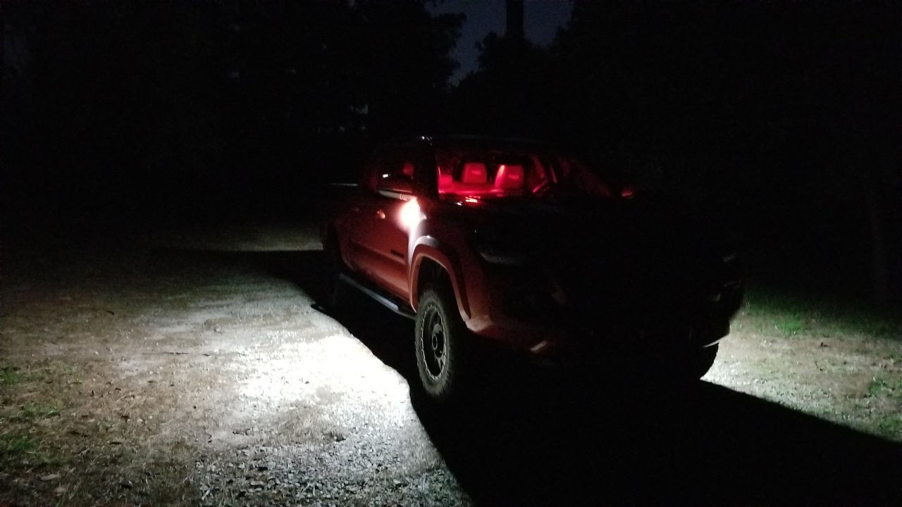

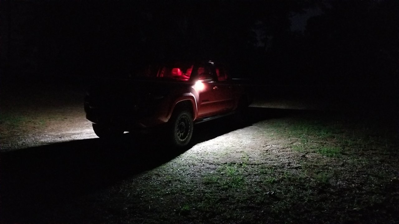

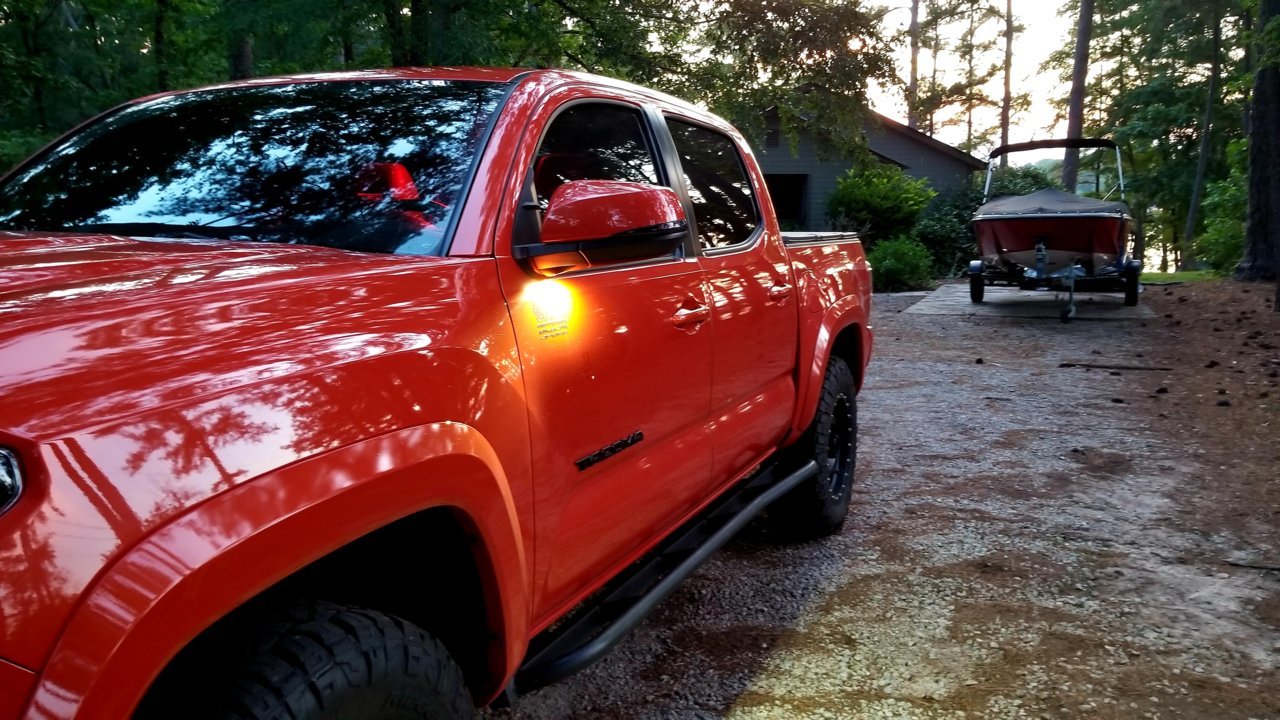

    The puddle light's look awesome. plenty of light. Even the neighborhood wildlife were checking them out. Thanks again for the help to determine my problem. Will be checking fuses tomorrow. 20190615_205612.jpg 20190615_205558.jpg 20190615_205542.jpg 20190615_205524.jpg 20190615_220309.jpg 20190615_220319.jpg 20190615_220329.jpg

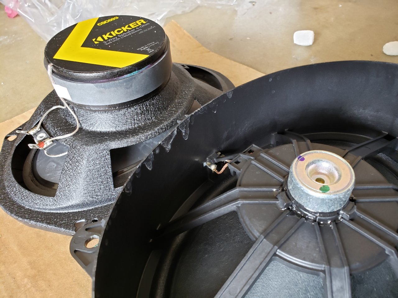

    Was a long day today installing the puddle lights along with front and rear speakers and sound deadening. The puddle lights went in smoothly, I was worried about feeding the harness through the rubber boot but it was pretty easy. I used a clothes hanger wire and fed it through, afterwards I electrical taped the harness to the clothes hanger and pulled it through. I didnt have any harness shortage issues, ran mine under the carpet and had some slack left. These lights are so ridiculously bright in person pictures dont them justice. Props @MESO for another great product. those that are skeptical on upgrading the speakers and tweeters do it. Day and night difference. Just look at the magnet size difference.20190615_122722.jpg
