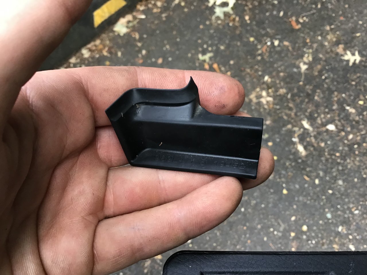

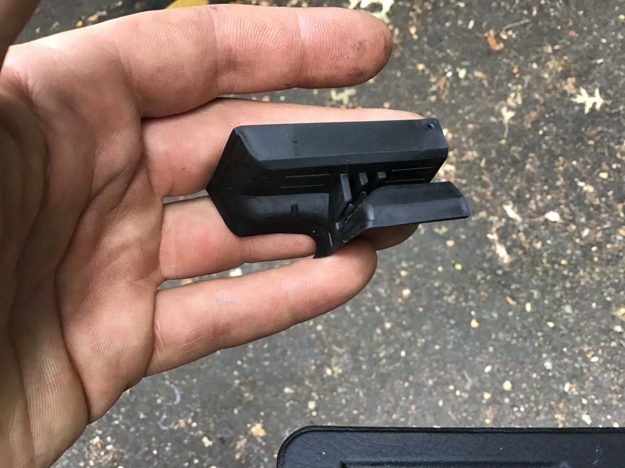

  14. Jul 6, 2019 at 6:12 PM
    #3434
    piotr1aj
    piotr1aj Well-Known Member
    Aug 31, 2017
    #228685
    142
    Seattle, WA
    ‘17 OR QS/DCSB/MT
    ED16D2E6-64D2-4D83-845C-BCBF0A9C51F5.jpg C8041966-3969-4BF6-9A64-60E0E1F55D76.jpg C8041966-3969-4BF6-9A64-60E0E1F55D76.jpg This cam off my driver door during install. Anyone know where it goes?
  15. Jul 6, 2019 at 6:21 PM
    #3435
    Idahotaco88
    Idahotaco88 Well-Known Member
    Nov 13, 2018
    #272568
    334
    Steven
    2017 black AC OR
    Kings 2.5 with adjusters, icon rxt stage 2. SCS stealth blue on 35s
    drivers window seal down in the back corner of the door. mine came off too

  16. Jul 6, 2019 at 6:23 PM
    #3436
    Skydvrr
    Skydvrr IG: @kalopsianick
    Sep 13, 2017
    #229889
    12,654
    Nick
    YMH
    Black '17 OR
    First pic is correct orientation. Far end of the door. Bottom corner

  17. Jul 6, 2019 at 6:26 PM
    #3437
    piotr1aj
    Aug 31, 2017
    #228685
    142
    Seattle, WA
    ‘17 OR QS/DCSB/MT
    Thank you sir!
    Skydvrr[QUOTED] likes this.
