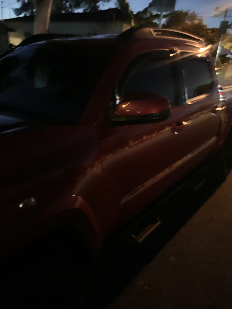

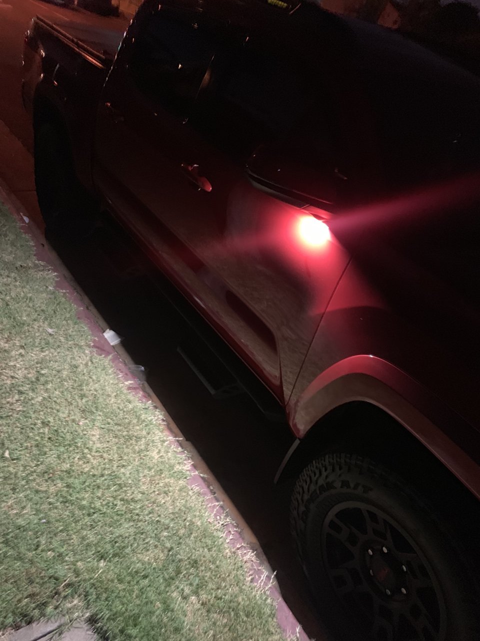

    @MESO one of my puddle lights on the
    driver side went out but the passenger one is fine

    Do you have any type of test light or multimeter? First and easiet place to
    Check is right at the light. Pop the cover off and test to see if there’s power.
    Yes= bad light
    No= connection came loose somewhere upstream
    Inferno__Taco likes this.
