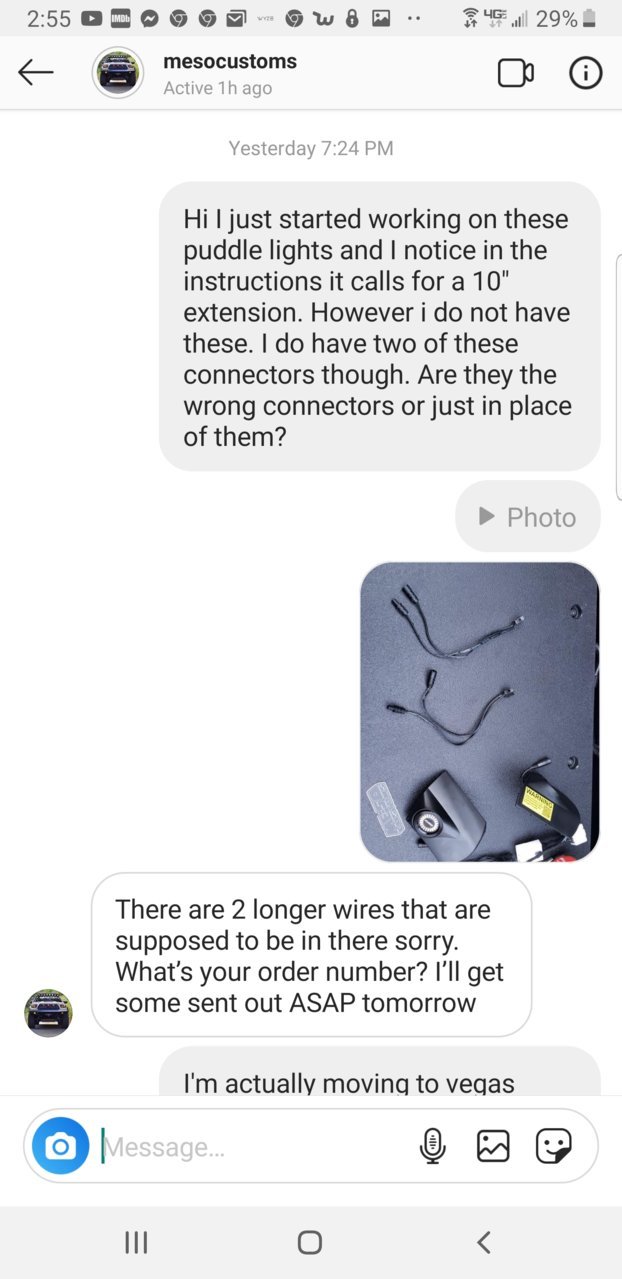

    Here is the only reply I received in regard to the wires.

    Maybe someone can enlighten a poor fool. I'm reading page by page, I'm at 128. Looking for answers about these cables. I'm now getting conflicting answers about if I have the correct wires from the meso instagram(not rightwires) and customers(i got the right stuff).lol I'm just going to install and see what happenes..lol

    Photoguy190, I may totally be off base but with zero help from the source I'm left to guess.lol have you tried or do you know where he was posting about the "updated" wires??
    ETA: I'm still searching the thread for an answer, hopefully will come across something.

    There are wires that you don’t have picture that come with the kit. Lay everything out that you got and let us see. I’m pretty sure in your Instagram communication he though the long wires are missing as they are not pictured.

    Dang photoguy33, I think you hit the nail on the head! I literally just found it and was on my way to say something. Yes, that is definitely the miss communication. He must have thought as you said about the "missing wires".
    Thank you guys sssooo ssoooo much! I really appreciate the help with this!

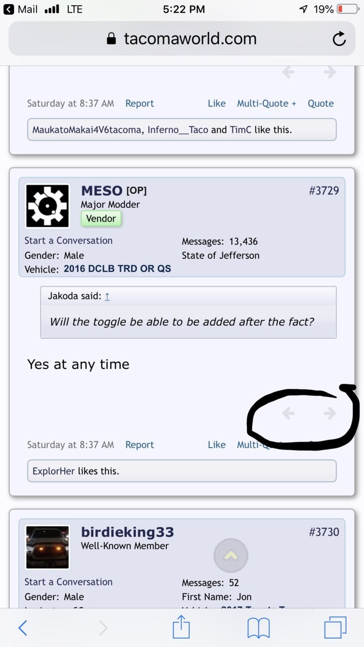

    Here is a useful tip! There are arrows above the quote button for long threads you can use them to jump between 1 individuals post in this case Meso. So you can go to one of their post click those arrows and jump to the next time they post. Super helpful if you wanna catch up on a meso thread. Start at the beginning the skip to only his post! Makes it much more manageable. Granted you might miss good info from other members but it’s a fast way to get a good understand.
