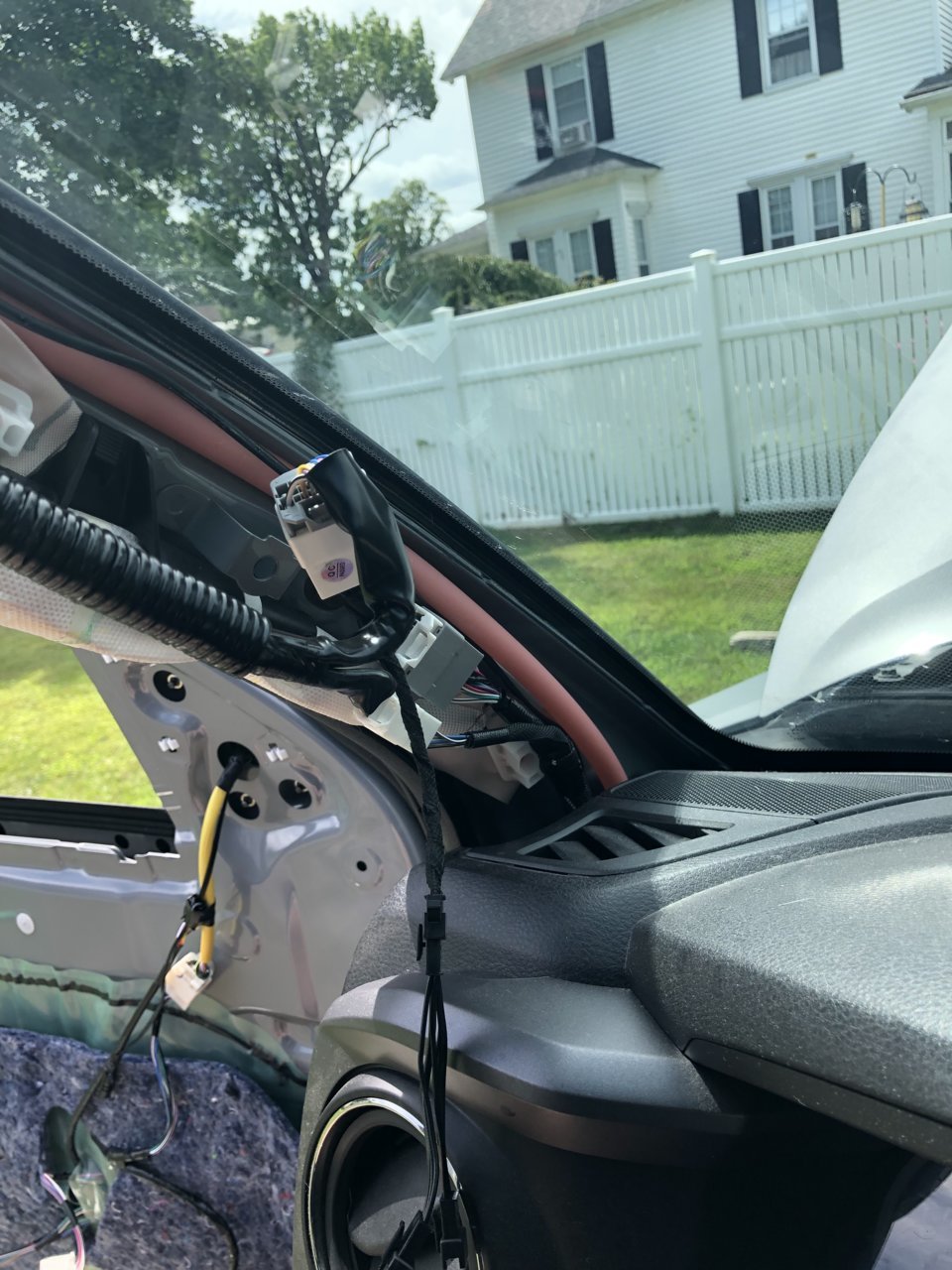

    Unclip the big gray connector that is attatched to the pillar. Push it DOWN into the dash cavity. The upper harness will now push down and sit where the lower one was.

    The part that sucks is that the other (white) connector is connected to the gray one and then both sets of wires are taped together all the way up the a-pillar and partly down into the dash. I need to see if I can separate them enough down the dash to push the dome wire bundle down. I tried the s/z option on the upper portion, but it seems to make my dome circuit act a little funky.

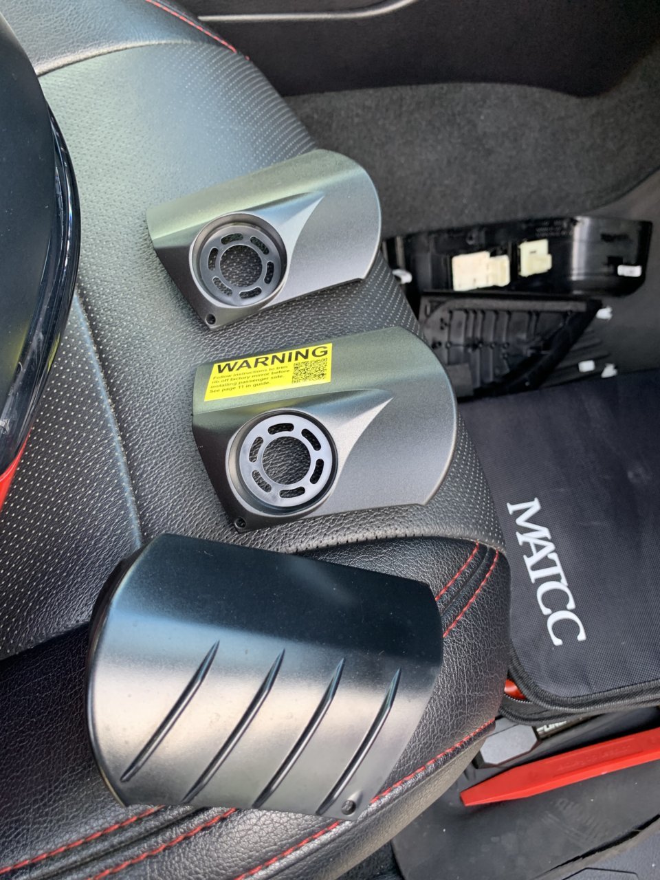

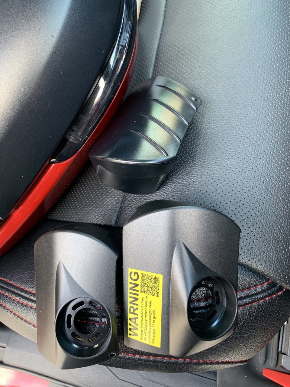

    Camera mount
    EC3A1831-9CB2-4BC6-A7F4-54DD8EC61C57.jpg I was trying to install them but I had bad luck they shipped me two left pod cases.
    Contacting Meso to see if I can have the right side case to complete my install.

    PM incoming.
    BTW, you can still do the entire install, and leave the pigtail inside the bottom mirror cavity. Snap the stock cover back on, and when I get you out the correct plastic it’s an easy swap.
