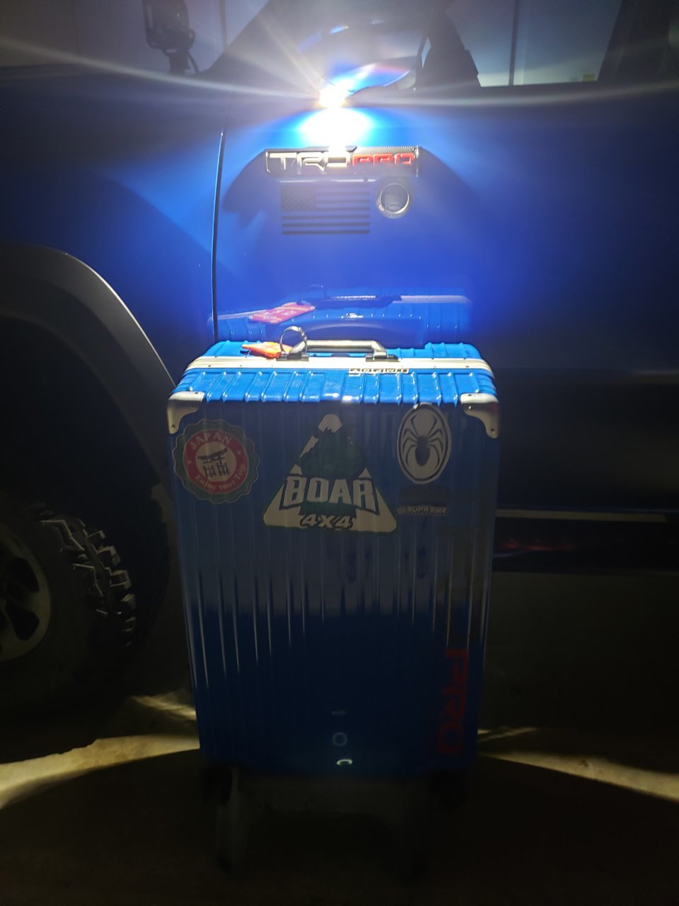

    Installed my puddle lights today and showcased my limited edition @MESO customs TRD travel luggage with limited edition colors to match your Taco!! Lol:headbang:
