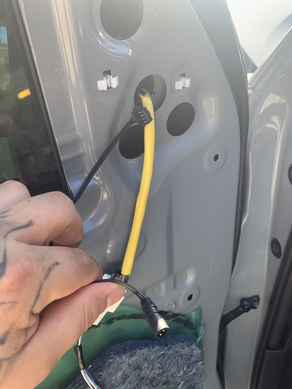

    In the install video. . This piece seems to hang lower ? Am I missing something here.

    In the picture in the quote from Meso below, both ends towards the puddles should be inside the mirror (one is a future V5 turn signal wire) and the end that is near the #5 should be what comes through the door. Hope that helps.

    It will sit lower because the cable from led puddle light will provide that extra slack coming through the mirror hole.

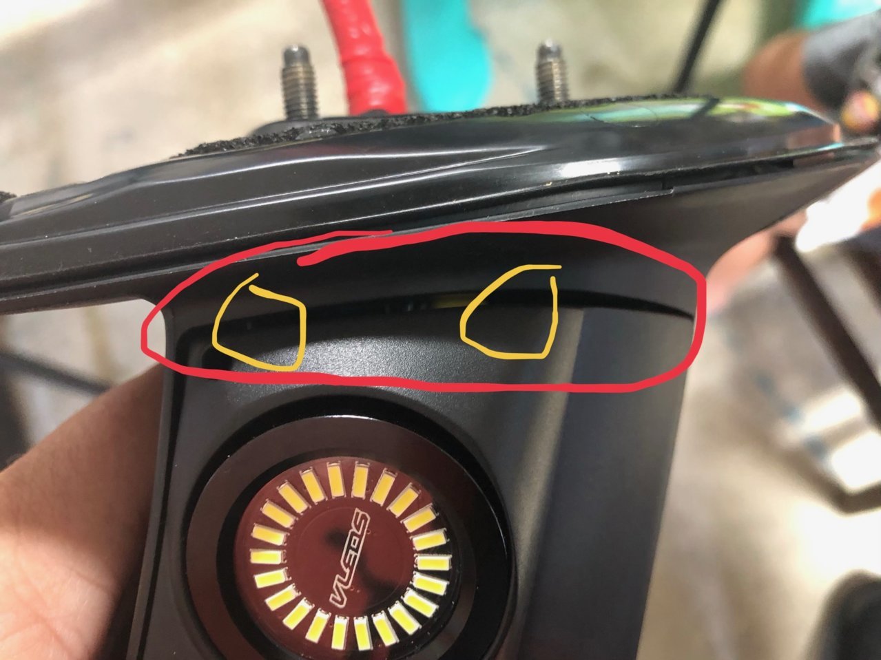

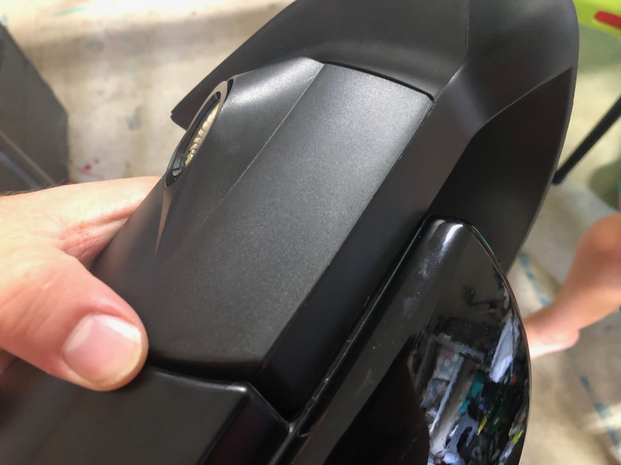

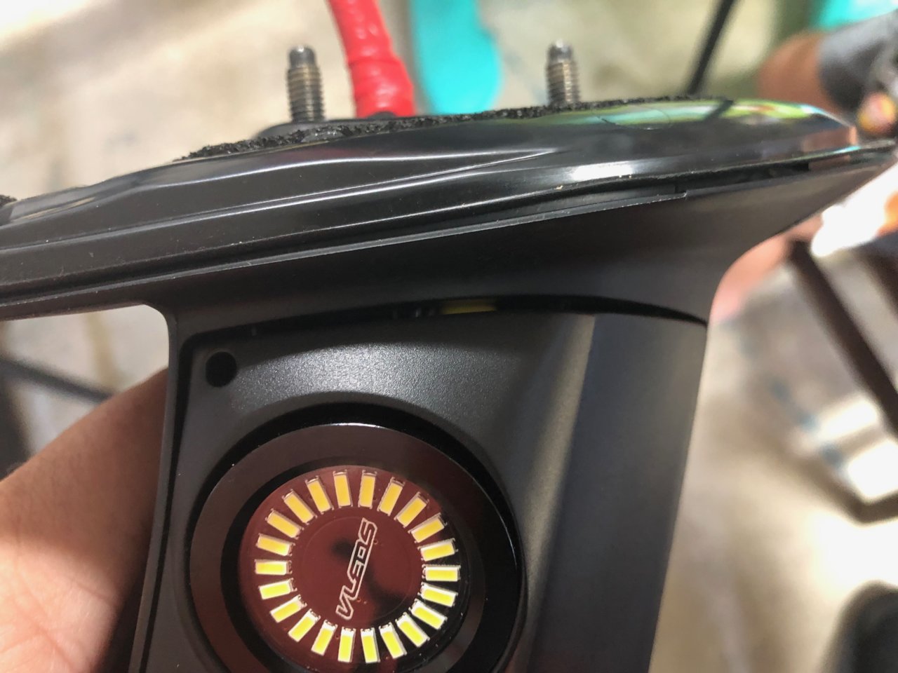

    Alright, need some advice here. I've put the driver side puddle pod in. Unfortunately, there is a decent gap on the side closest to the cab. The gap is large enough so that the two clips on that side aren't grabbing like they should. I've attached a few pictures to try and illustrate what's happening:
    I've circled the gap with red and the two inner clips in yellow. I can basically just remove that side of the pod with my hand because the clips aren't able to grab enough. Any thoughts on what might be the issue here? As you can see in the first pic, I have the pod set completely flush with the rest of the side mirror body.

    I got the same gap, assumed it was just the way it was.
