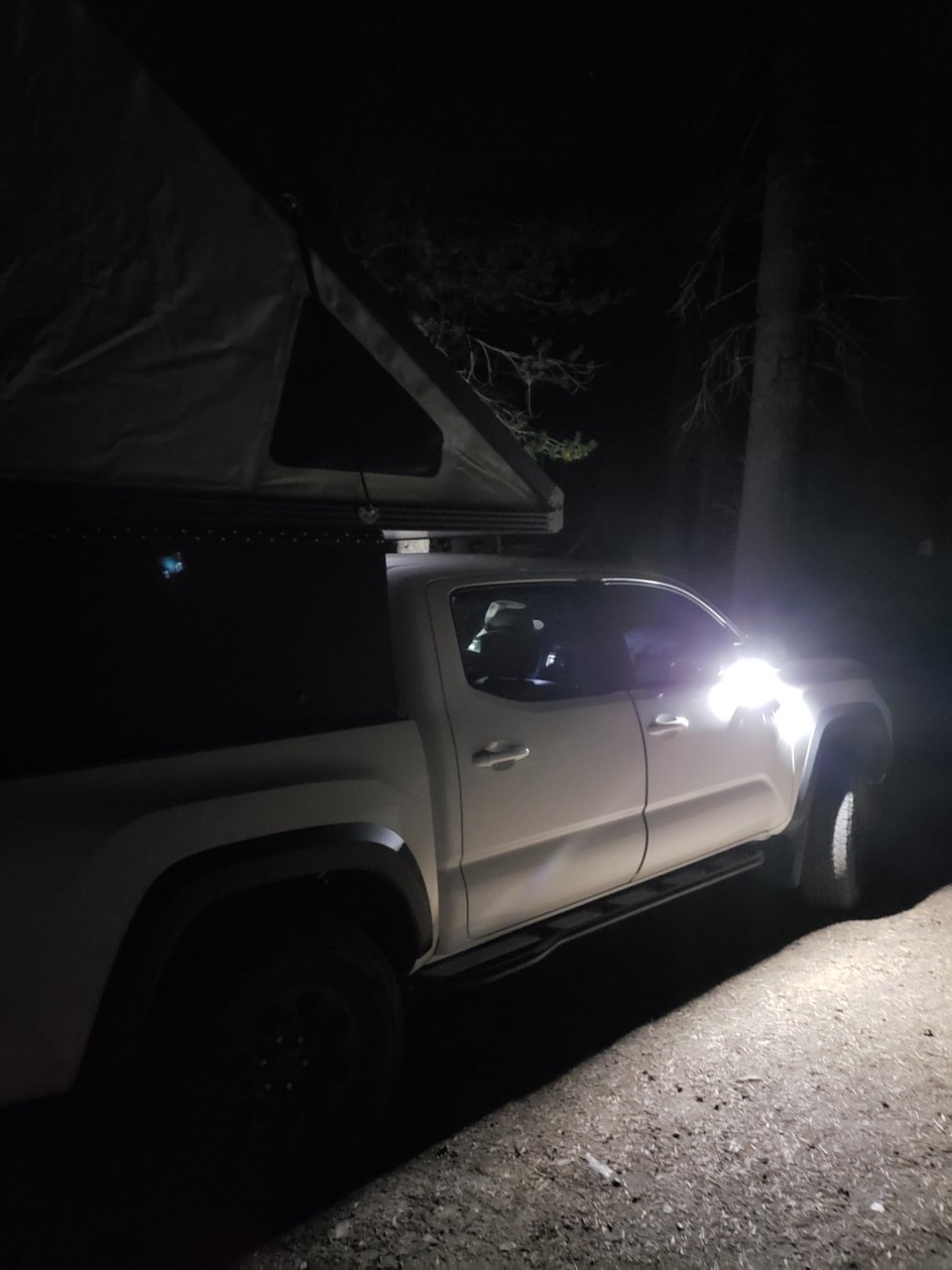

    Sleevez
    Sleevez Well-Known Member
    Sep 23, 2016
    #198054
    165
    LA / Toronto
    2017 SW TRDPro, 2000 PinkTaco
    Thanks for sending the replacement t-cable.. was able to swap it out just before headed out to tuolumne. Camping with those was pretty sweet. Just wish I didn't have to leave the door popped open to keep them on. Thanks again for the great product and even better customer service!!
